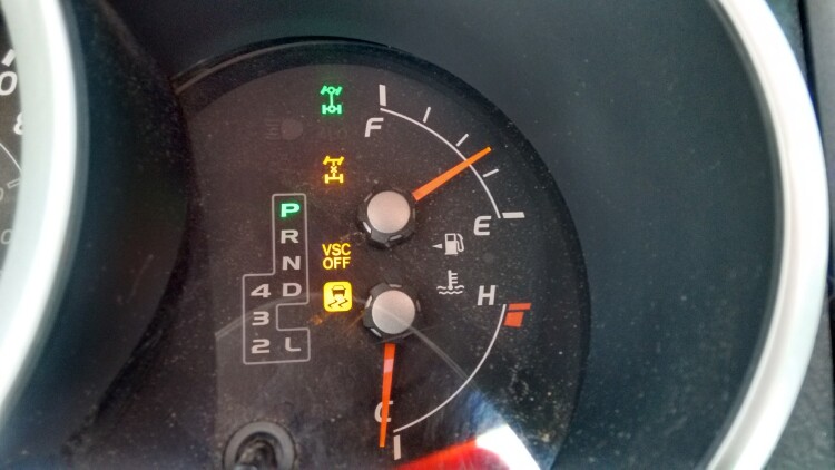

Locking the center diff will turn VSC off automatically, but ATRAC stays on until you manually turn it off. Press and hold the trac off button until the trac light comes on (the car with skid marks). With the traction control light on, the system is off. Toyota engineers were drinking heavily when they decided how to make the controls and indicator lights for this system, it's very confusing.
This is what the dash lights should look like when trac is off.

It's the button with the car and skids marks pic on it.
VSC2.jpg~original
It is, but it's also for atrac off if you push and hold for 3 seconds.
It's all in the owners manual if you have one. But like I said, it confusing at first and not well designed in my opinion.
Awesome. Thanks! I actually finally found all that information and wow, is it confusing.
So, it's tap the button to turn off VSC and hold the button to turn off TRAC.
Thanks for the explanation. I've read through that section a couple times and still didn't totally understand what the button did.
