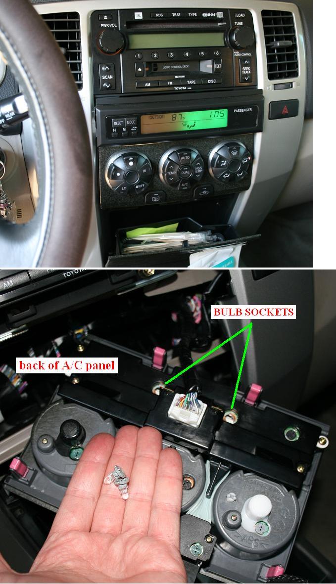

strange thing here, noticed the other day that the left side became darker while i was driving... any ideas? i recently got a new battery since factory one died.
you kind of can notice it in the photo
nice link but not real sure which one/color is the one that is out on mine.... clear?
had the same problem
If I remember it is infact a clear bulb. Its a very easy fix and should only take a few minutes. Should only be 2 bulbs, one for each side. I would go ahead and replace both since you are there. If one is out the other is probably on the way.
okay... guess my next question would be what kind of bulb and from where? lol

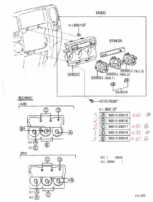

not to sound like a jerk but there are so many posts on this. eitherway, heres a dia. of what oem bulbs are used.
All is clear now, I should be able to figure it out.
Thanks guys!
i had the same problem, fixed it by adjusting the dimmer up and down a few times on the left of the gauges and the bulb started working again.
