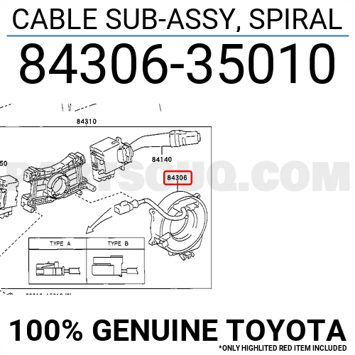

Now, as usual getting parts to the UK for the good ol' Runner is a bit tricky, so I'm trying to find the right part number for the clock spring, as it seems the airbag connector is different pre and post 96. My car is a 96 Limited auto, and all the 84306-35010 or 84306-35011 I find on eBay seem to have the post-96 airbag connector, is that wrong? What would be the proper part?

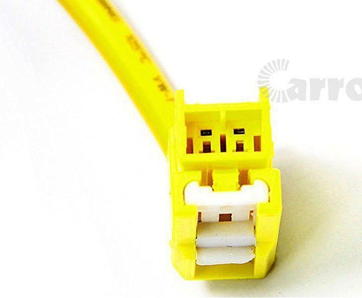

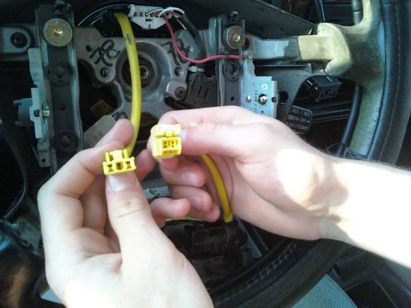

Thanks! It confirms I need a 84306-35010 for my car... however both types of airbag connectors seem to come up with that same code (could be an oversight from the sellers?) so I'd like to make sure and get the right thing.
Among everyone who had to deal with that issue (seems like a lot), would you have pictures of the airbag connectors (pre and post 96') you could share here?

i replaced my steering wheel with one from a 96 and when i did i had to replace the clock spring or it wouldn't work. I can tell you they're different, but i didn't take any pictures unfortunately
Thanks, yes I think I can confirm this type A / B thing for the airbag clip, now I need to find a place that sells the type A and ships it to the UK. I probably should open my steering wheel and check it's type A indeed (never know if the previous owner might have changed it in the first 17 years of the car's life).
