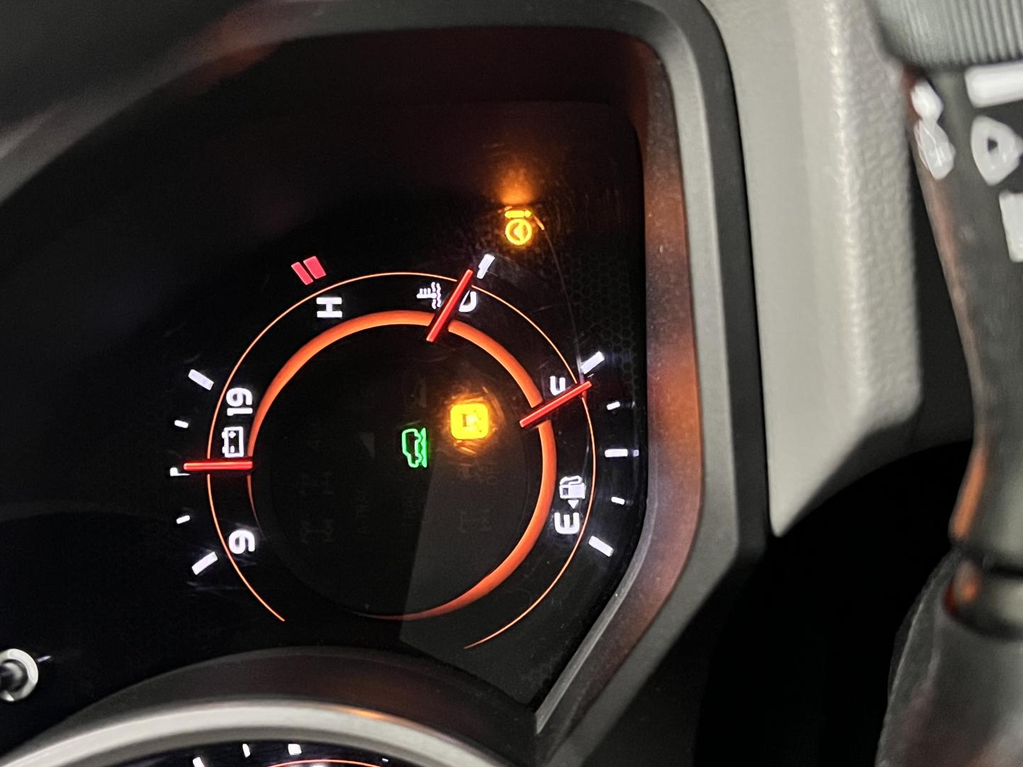

So I did this last week (switched out the clock spring) and it did not solve the problem. Still no horn sound. When I press my panic button the horns will activate as intended. Also after I reassembled the steering wheel, my dash lights up upon ignition to tell me that my multi terrain select is unavailable, and my steering wheel light illuminates as well.
I am in a 2012 TE.

Can you clear the dash lights / codes using an obd scan tool? or do they come right back?
Did you use totyota or aftermarket parts for the replacement?
Start by checking your ground on the steering wheel with a multimeter.
Did you use toyota or aftermarket parts for the replacement?
- I can do this but did not think of trying it. I will.
- I used an after market clock-spring from clockspringexperts.com specifically for 2012 TE bc apparently they are slightly different depending on trim type.
- What setting should my multimeter be set to? I'm an electricity challenged person.
All good, Set the multimeter to resistance / ohms / the little Ω symbol. In this mode it should beep and give you a resistance reading when you touch the probes to a continuous circuit. Test it on two points of a piece of continuous metal.
Now set one probe to the steering wheel metal and other to the door frame (put it to any non painted bolt / metal). It should give you a beep meaning the steering wheel is grounded to the the body of the car / continuous (good). If you cant get a beep, the wheel is not grounded you likely have a problem with clock spring still.
So I got the horn to work again. Once I took the airbag back off and tested the wires so there must have been some kind of problem when I reassembled everything after switching the clockspring. Now I just have to perform the ZPC tests.
