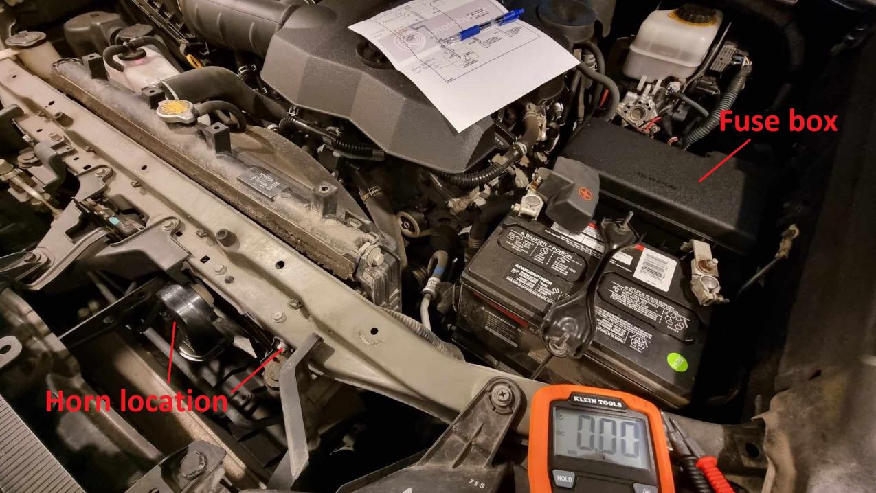

    - The 2 main horns that sound when you press your horn are grounded through their mounting bolts to the chassis. If this connection is bad, they won’t ground properly.
    - You can test this ground point by using a continuity tester or a multimeter.
    - The horns are located just in front of your radiator on the drivers side. You may need to remove the plastic cover to see them.

    - You can test them by grounding the horn through the mounting bolt, disconnecting the plug that leads into them and connecting a separate wire from your battery +ve directly to the horn connector. You should hear the horn sound. If it doesn’t, you need a new horn.

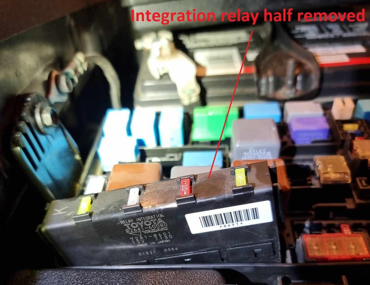

  • Faulty Integration Relay
    - Also known as the “K-Unit Relay” or No. 1 Integration Relay
    - Doesn’t look like a typical relay. Is located in the fuse box on the drivers side of the engine bay and houses 4 fuses.

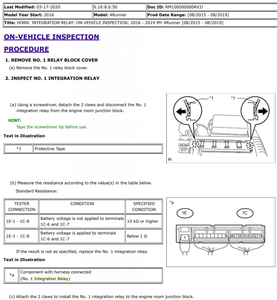

    - There is information in the Toyota Repair Manual for the 4Runner on how to test whether the integration relay is faulty. You can pull it out with the wires still attached. I found I could get it out just enough to be able to probe the wires/pins.

  • Horn fuse tested OK.
  • Horn grounds tested OK.
  • Horn wasn’t working at any steering wheel angle, all other buttons were OK.
  • No +12V at horn +ve connector when the horn is pressed.

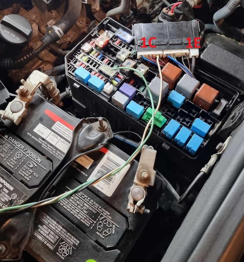

  • Connecting between battery +ve to the horn ground wire on the inside of the steering wheel gives 12V when the horn is pressed.
  • Connecting 1C Pin 7 of the integration relay to the horn ground wire on the inside of the steering wheel gives 12V when the horn is pressed.
  • Connecting 1C Pin 8 (Grn/Red) of the integration relay directly to battery +ve makes the horn sound.
  • Testing between 1E Pin 1 and 1C Pin 8 when there is no voltage applied to 1C-6 and 1C-7 gave 0 Ohms. This should normally read 10kOhms or higher and the repair manual states to replace the integration relay if this is not the case.
With all this considered, I have decided to order the Integration Relay part number 8264160080 and replace it. I will report back here with any updates but for now I hope this helps someone who was in a similar boat to me and was scratching their head! I will try to include some photos below.
