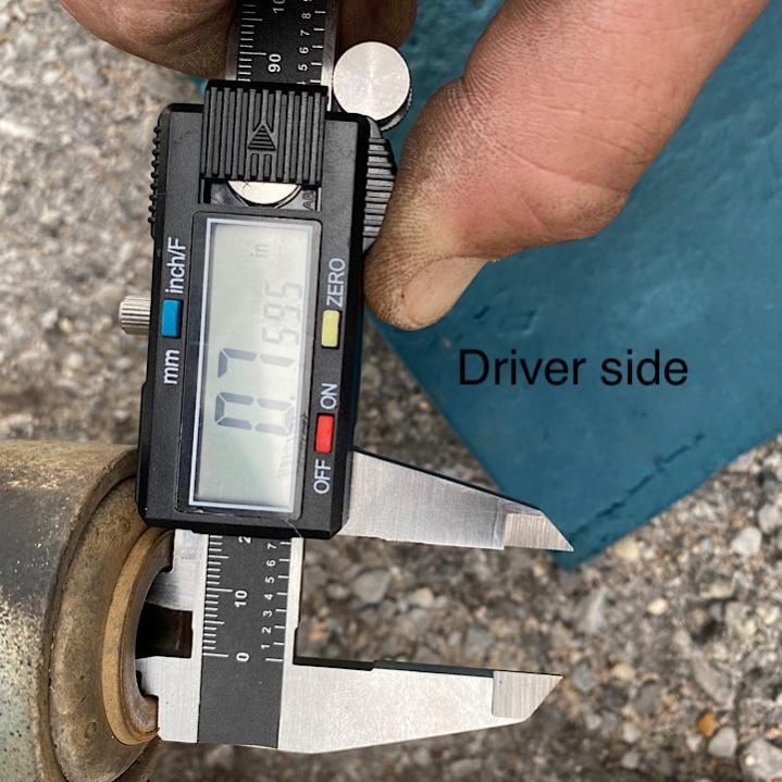

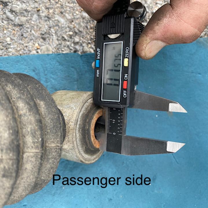

If I were you, I would remove one rear shock, go for a test drive, note any noise difference, remove other rear shock, go for another test drive and note if the noise disappears either with the first or second shock. Inspect upper and lower bushings after removing each shock absorber.

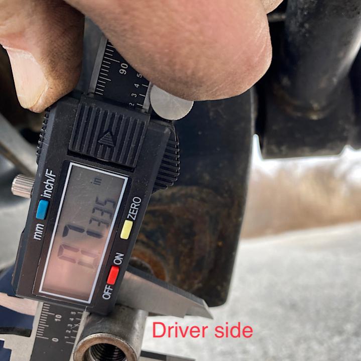

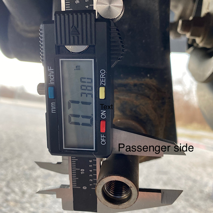

Steel sleeve in the lower bushing is slightly under tolerance or the mounting bolt bottomed out. If you like the rear shocks or you need to keep them for awhile until you decide what to do, then remove the lower bolt, and add a thin washer to take up the loose tolerance. Check for something that binds the bolt threads, or bottoms out the bolt making you think it's tight. If you have a micrometer, measure length of the steel sleeve. My old stock sleeve measures 1.786 ins. Also measure length of bolt shank. Something is out of spec or the mounting bolt bottomed out on debris. Discover the root cause before installing new shocks.

The length of the lower bushing sleeve has to be the same as a stock shock because your shock uses the same mounting hardware.
If your shock has been loose for a long time, there's a chance the mounting hardware (bolt or bracket) is now worn and you may have the same issue with any set of new shocks.
If the noise is coming from one side only, then compare measurements of one side to the other. A short bushing sleeve on the noisy side coupled with minimal wear everywhere else identifies the root cause and offers you two options, (1) add a thin washer or (2) replace the shocks. I would add a thin washer to the noisy side.
If all dimensions are good, then it's likely the mounting bolt doesn't bear tightly against the bushing sleeve. You'll have the same issue with any brand of new shocks.

If the bolt worn out, I can replace it. but what if the bracket
If the bracket is slightly worn and the bearing surface still smooth, consider taking up the slack using a thin washer on the bolt head side. First step, identify what part(s) are either worn and/or out of spec. Then decide the best means to repair. What is the gap? 0.010 ins? 0.020 ins? More? One side? Both sides? Must also verify bolt and bracket threads are still OK.

DougR what do you think, the numbers are pretty much the same. While removing the shocks i noticed they were over tighten. I didn’t use a washer as you suggest could not find the right size. Will do it on the weekend. But still should I go with washer or go with full shocks replacement.
