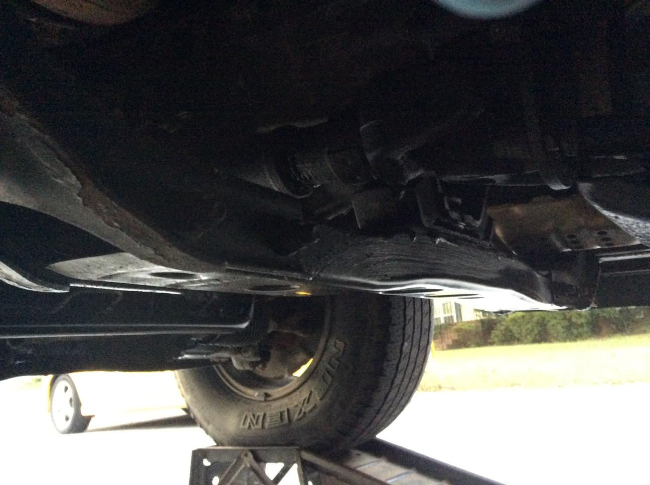

First off, I want to say (and I know its been said plenty of times before), this job is pretty time consuming, and can be a pain in the butt! The mechanics of the job itself are not difficult, but trying to maneuver the transmission out of and back into the vehicle proved to be pretty difficult. I wanted to do a write up because the only write ups I could find were kind of old and had broken links. Hopefully this helps some folks out!

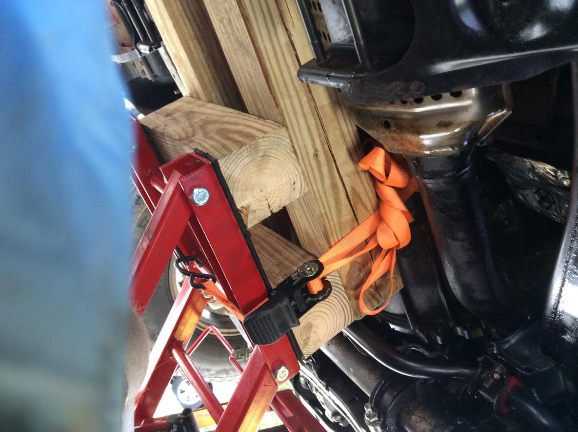

The first time I did this job, I used a motorcycle jack, thinking it would be sufficient. From a stability standpoint it was a good call, however, it couldn’t be lifted high enough to actually contact the transmission, so I had to build a little jig out of 4x4’s I had laying around. If you are planning to tackle this job, I would highly highly recommend buying a transmission jack. It made this job much much more manageable the 2nd time around. Harbor freight sells them for 100 bucks, or if you live in the Hampton roads area of Virginia you could likely borrow mine, or I might be willing to lend a hand.
My ghetto jack assembly I used the first go around.
I used the FSM as a guide on removal (pg 751 of the pdf version). It was pretty nice to have laying around, there are plenty of copies of it out there on the web to look at if you need to. The only thing I have to note, is you do not need to drain your transmission fluid. I did not drain my motor oil and I did the rear main seal while I was in there with no issues as well.
I have now pulled the transmission and clutch 3 times in the last 4 months (rear main seal issues), and this is what I’ve come up with to work best for me.
I started under the rig with the drive shafts and cross member first. Make sure you match-mark the drive shafts before removal, otherwise you may be unbalanced when you reinstall and could cause some vibrations (or so im told). The bolts/nuts for the drive shafts are 14mm. Some of the bolts needed to be removed with an open end wrench, others you can get with a socket as long as you have a few extensions on the ratchet. The second time I did this I had purchased those nice new ratcheting open end wrenches, they were great.
Next thing you will want to remove is the aft cross member (just forward of the gas tank). The first time I did the job I didn’t realize that it had to come out until I had the transmission disconnected and was coming down. It is held in place with a 14mm bolt. You will need an open end wrench on this guy to hold the other side of the bolt/nut closest to the gas tank.
I went ahead and loosened all the bolts on the cross member supporting the transmission, and removed the ones that actually bolt to the transmission. I didn’t want to have a hard time disconnecting the cross member once the transmission was unbolted from the motor, so I broke everything loose in preparation. The first time I did this I unbolted the cross member from the bracket that connects to the transmission, this was pointless, absolutely no need to. All the bolts for this are also a 14mm.

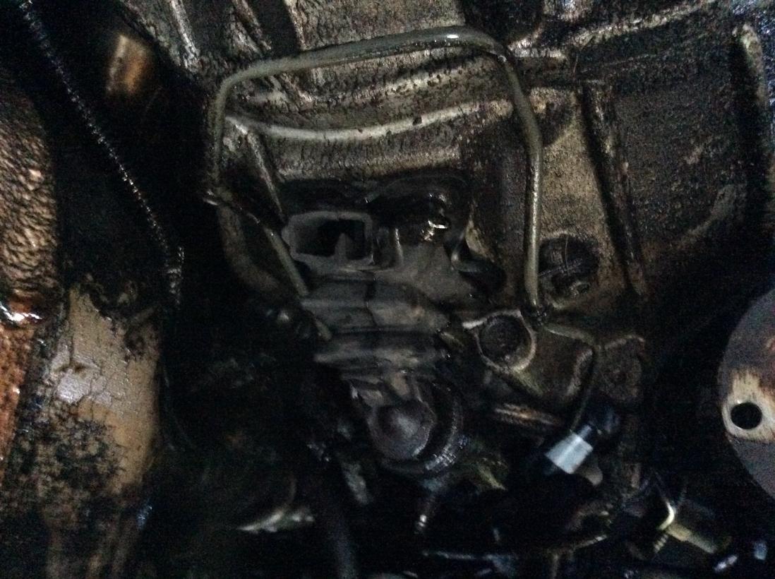

On the driver’s side of the transmission you will need to disconnect the slave cylinder as well as the two attachments for the hydraulic line. These are 12mm bolts. Before doing this I would recommend putting your transmission in neutral if it isn’t already. I say this because I have the tendency when I get in my rig to push the clutch and check if it’s in neutral, which will end up pushing the piston all the way out of the slave cylinder (ask me how I know!).
Up is to the left.

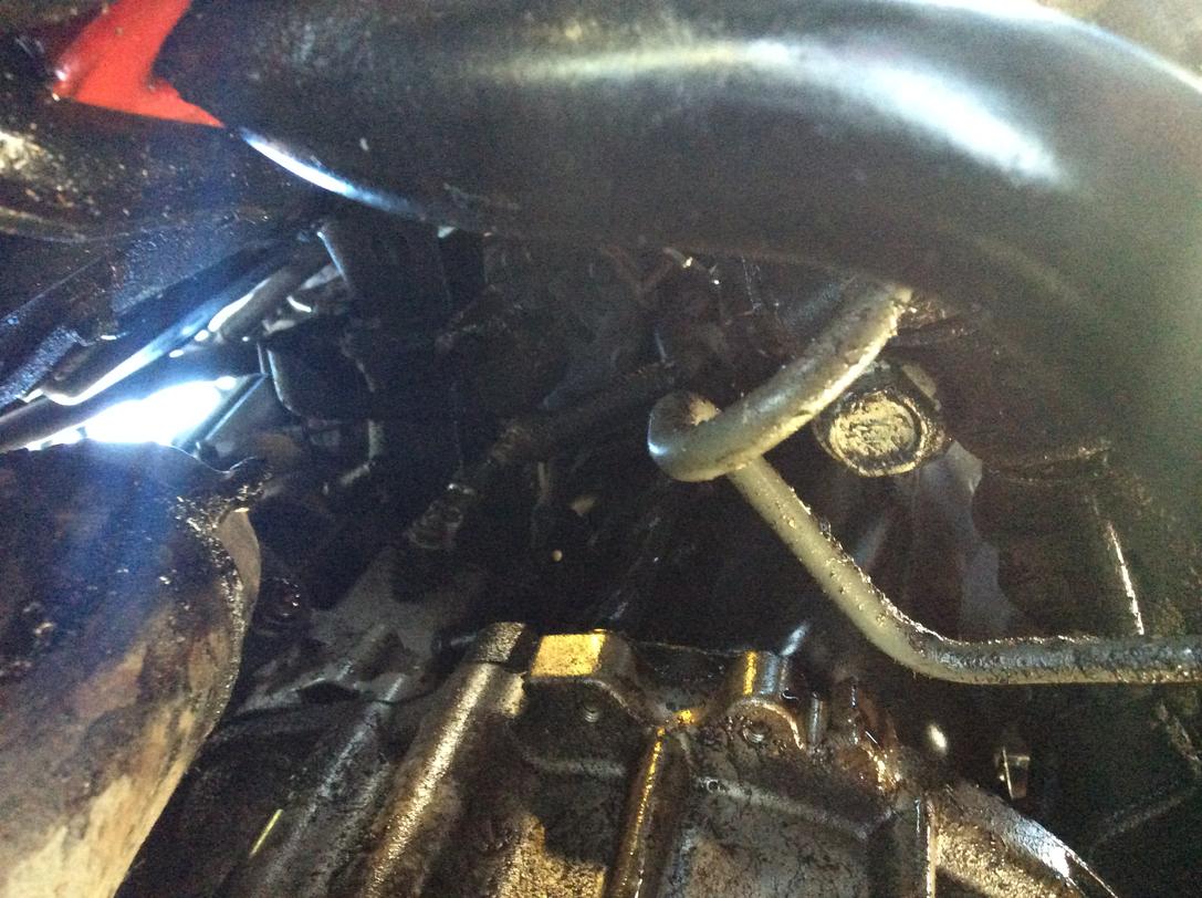

The passenger’s side has a bracket connected to the exhaust and the starter which must be removed. The starter just has two bolts, they are 14mm bolts. We left the starter to rest on the suspension components until the transmission was moved out. The bracket that needs to be removed is attached to the exhaust, undo that bolt and pull the bracket out. This bracket was broken on my rig. We ended up (before install) grinding the attachment ear off of the exhaust to provide a little more installation space. I’m not certain how we got the transmission out with it there, because it sure didn’t want to go back in even without it.
The front of the bell housing has a “rear end plate” which, from what I can see, just serves to keep extra road grime and whatnot from getting into the housing. It is attached using 4 small 12mm bolts. If you don’t have ratcheting open end wrenches then I feel sorry for you, this was miserable without them.

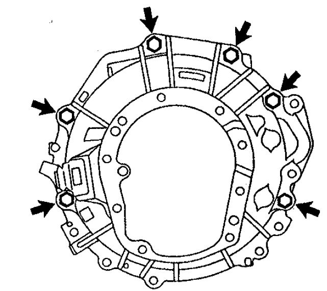

Once all that is done you can start the joy of unbolting the transmission. All 6 bolts are 17mm. To get the very top one I used a universal, two longer extensions and one short extension. I held the socket on the bolt from the passengers side and ran the extensions up the drivers side. Once I had the socket on and a little pressure I could take my right hand off the socket and put some torque on the ratchet. We removed this bolt all the way, along with the other two short bolts. We then loosened and removed the remaining bolts (three long ones, all low hanging fruit in comparison).
Note, this photo is looking from the rear to the front.
Once they were loose I went ahead and raised the transmission jack up to the transmission and put weight on it (taking weight off the cross member). And removed the cross member the rest of the way.

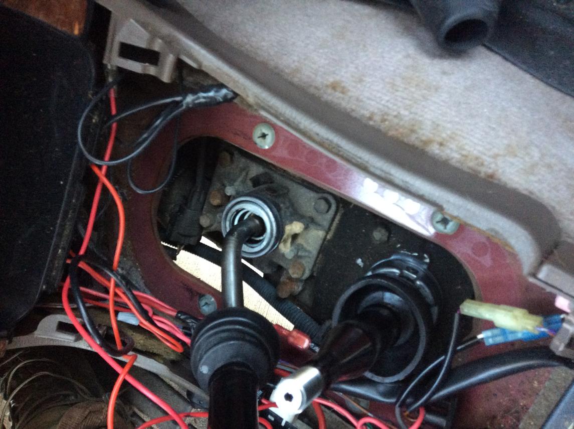

Removal of the transfer case shifter is much the same as removal of the transmission shifter, however, it is held in place with a snap ring in lieu of a push and turn type mechanism. Remove the snap ring and pull up. My transfer case seat was all sorts of destroyed. Additionally, I yelled more trying to get this dumb snap ring back in than any other part of the job, lol.

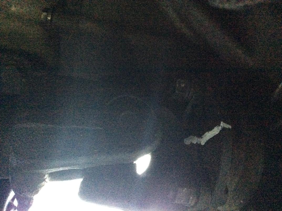

Once they are out, you may be tempted to start reaching around down there trying to disconnect electrical connectors, but you’d be better off waiting until the transmission is lowered just a hair. There are two that can be gotten easily from below, your back up light sensor, and one of your o2 sensors. The other three are better to hold off on.

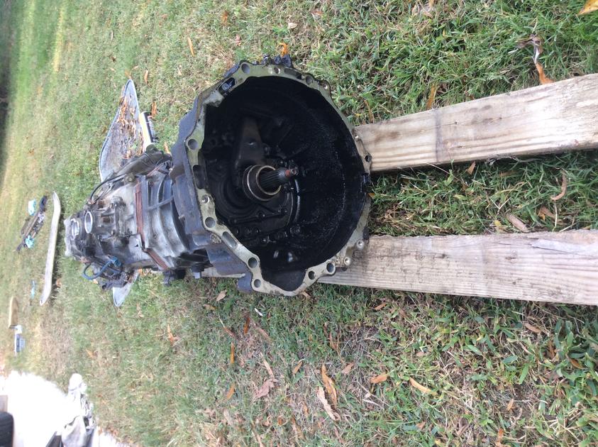

I expected the transmission to come back easily (that was a foolish thought). It will take some shaking and moving around. We ended up using a small pry bar to work the transmission back. Once loose it was just a matter of lowering the transmission down and out, which took some finesse to do. Move it back a little, lower it down a little, move it back a little, lower it down a little. Once you get it back and down just a little bit, you can crawl back up top and reach down and get those electrical connectors. It is much much easier when the transmission has been lowered a little. There should only be 3 that you need to get from the topside.
There is no need to actually pull the transmission out from under the vehicle. I did the first time, and found it to be unnecessary. It will slide back far enough under the vehicle to be out of the way (assume you had your rig on ramps like I did).

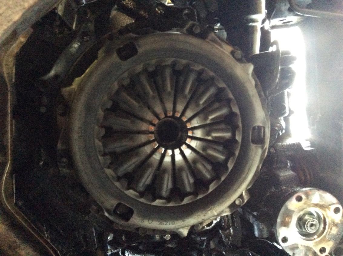

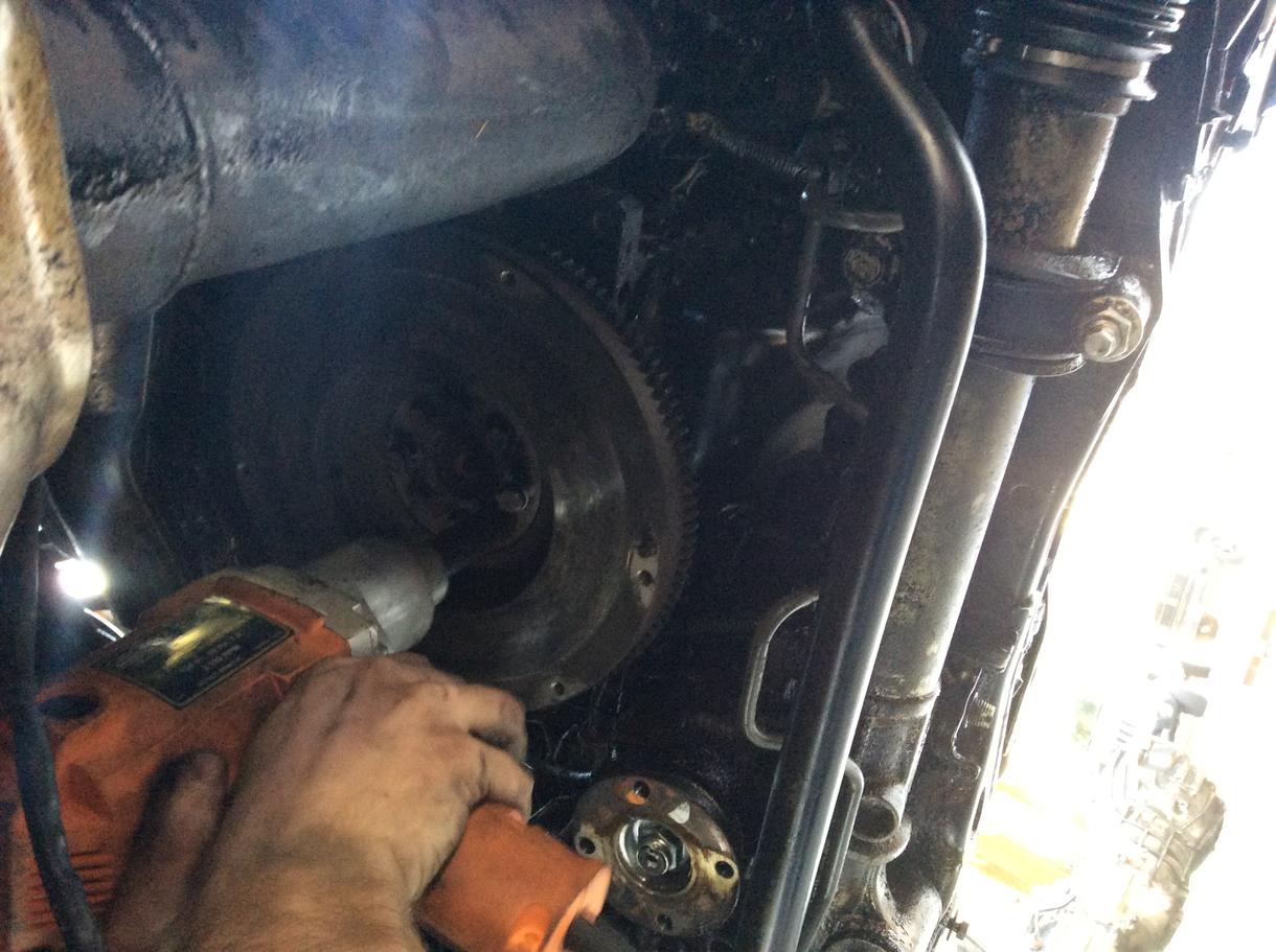

Now you get your first good view of the clutch. We used an impact wrench to remove the components. The pressure plate used six (6) 14mm bolts. The flywheel was held on using eight (8) 17mm bolts. Once these components are off you will see the pilot bearing and rear main seal. We used a pilot bearing removal tool (rented) to remove the bearing. Good thing I replaced it because it was completely seized up. Reinstallation was done with an appropriately sized socket.

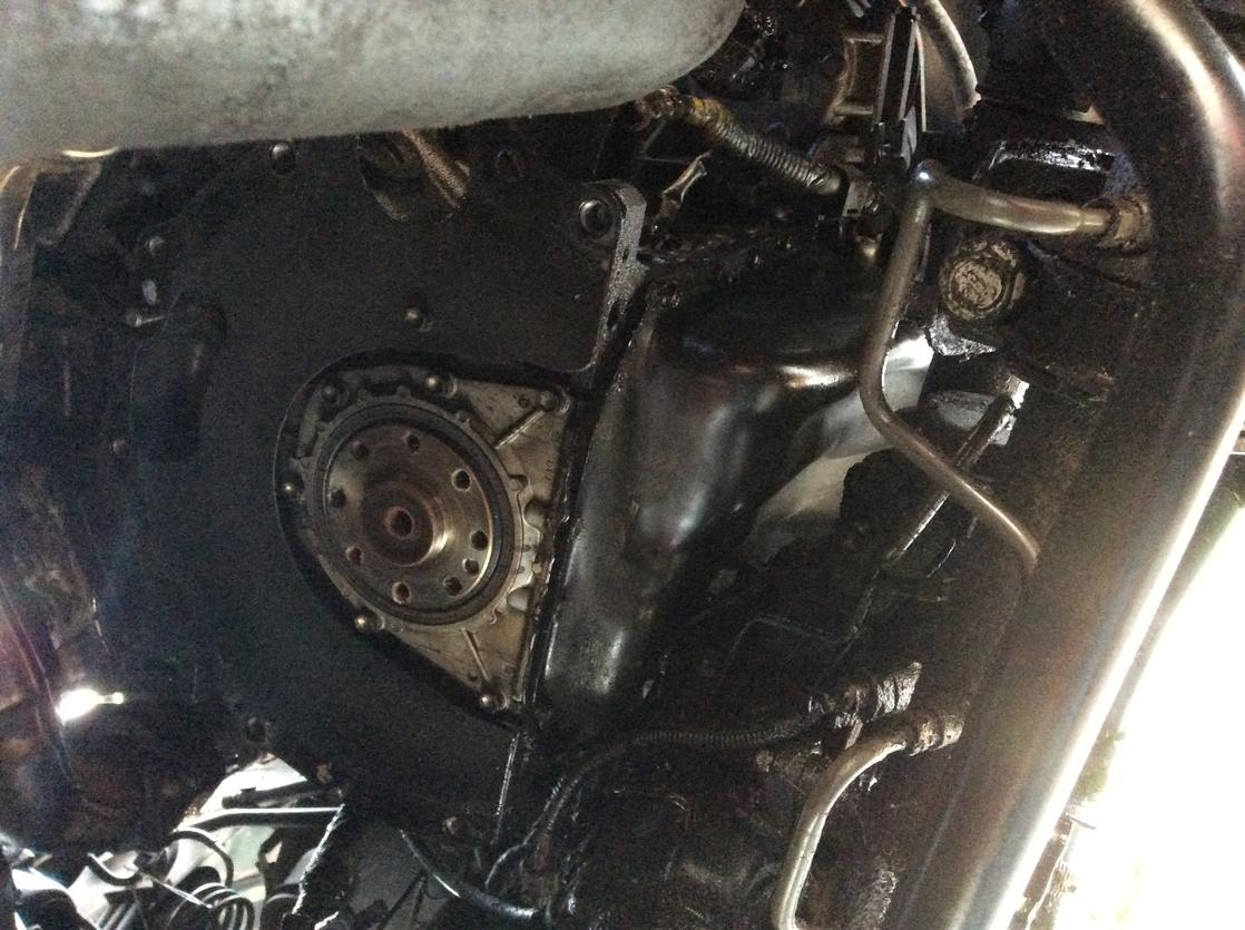

The rear main seal came out using a hooked pick. Started on the inside of the seal (closest to the crank), pushed it through, then rotated it behind the seal and pulled out. I had seen some information on these a few other times which mentioned that Toyota changed their part and the new one is slightly smaller than the old in thickness (space it will occupy from the motor towards the rear of the vehicle). I checked and sure enough it was. This was the joy in why I’ve done the job three times. I had blocked crankcase ventilation which was putting too much pressure on the seal and pushing it out. I guess having to work on the RMS a few times is a better way of discovering the issue than some sort of major failure. Anyways, for reinstallation I pushed the seal all the way until flush with the seating surface of the engine (i.e. the retainer plate), which meant the crank stood slightly proud. I used a piece of PVC and a hammer. There is no need to remove the retainer plate, you will just find yourself fooling around with FIPG to put it back on for no reason.

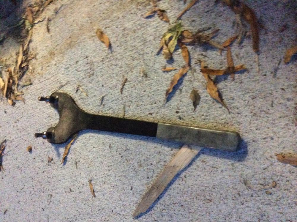

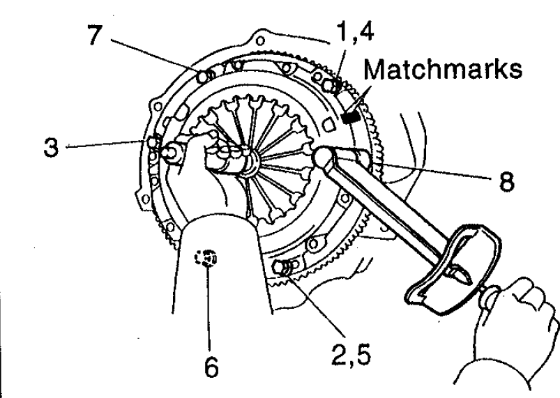

Once everything was off it was easy enough to reinstall. I used this tool to hold the engine from rotating while we torqued the new components on.
I originally bought the tool to be used when I did my timing belt, glad I still had it. Wherever it was that I got it from amazon, it did not fit the motor right and I had to grind it down some. Anyways, reinstallation, the flywheel was 63 ft-lbs while the pressure plate was 14 ft-lbs or 168 in-lbs. Make sure to use an alignment tool during these steps to make sure the actual clutch is lined up property. We used some brake cleaner to remove any grease/oils on the flywheel from our fingers prior to reinstallation. The pressure plate has a specific torque sequence (according to the FSM).

Once in place, bolt everything up. Make sure you place your long and short bolts in the right place. In general, the short ones are hard to get, the long ones are easy. Two of the short ones go way up top (top center and top passengers side). Two long ones are the low hanging fruit on the right side. Drivers side, short one goes up high, long one down low. These are supposed to be torqued to 53 ft-lbs.
Once I had one on the right and one on the left snug, I put a regular jack under the backside of the transmission, removed my trans jack, and reinstalled the cross member. The transmission jack is a bit bulky and can make it hard to work.
