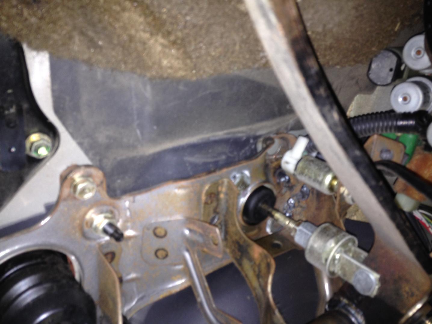

I'm going to take a look under the dash and look at the bracket. I faintly remember pushing the clutch down two days ago and felt a little 'ping' in the pedal, the pedal pressure felt like it dropped a little bit.
Time to pull out the seat and take a look. :)
It's the bracket.
Looks like someone tried to weld it when it was still installed. No bueno...
I think instead of pulling it and trying to salvage it, I'm going to bite the bullet and buy one, or at least buy a used one that hasn't been hack welded.
Here we go.
