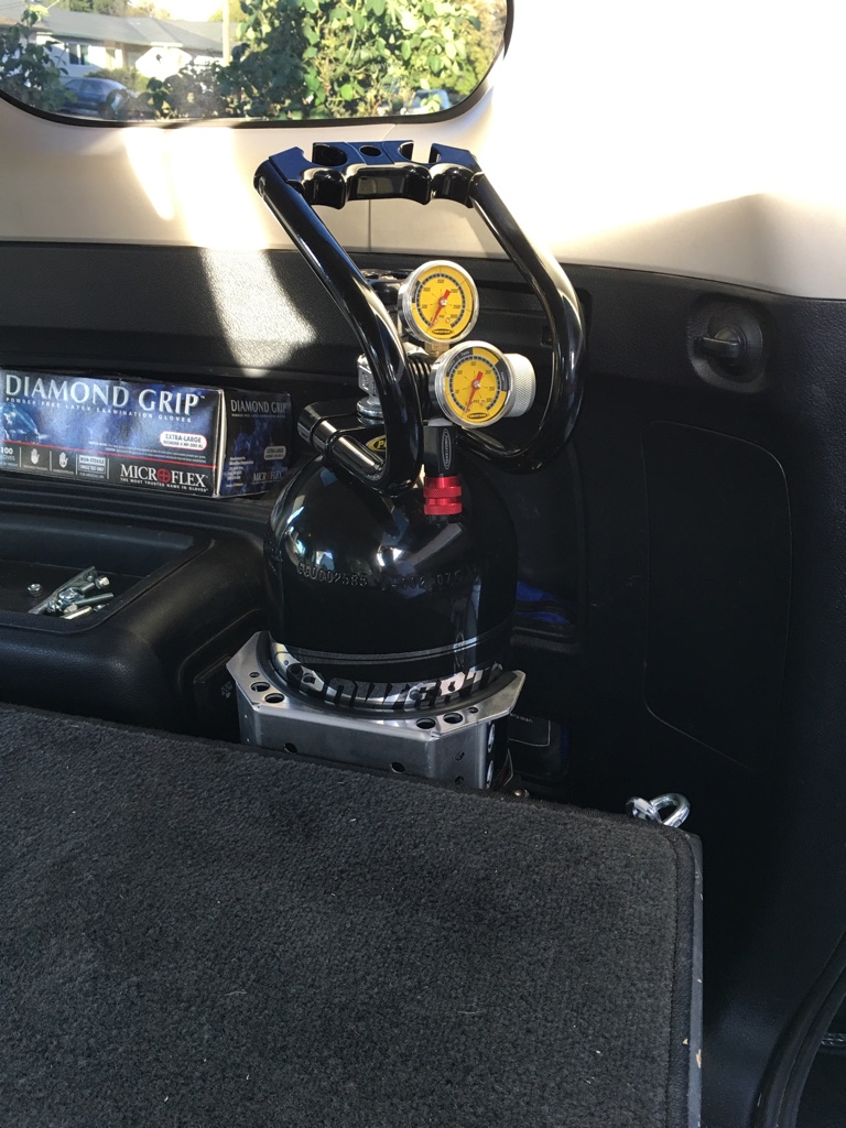

Mine is in the back of the truck, bolted to my drawers behind the passenger wheel well. Fits perfectly, out of the way, and is easy to remove.
I have mine mounted to the side of my drawer system like yours, but I used just bungee's because I also put water cans in that area when I don't run a powertank.
Without a drawer system, I don't have any good idea's on how to mount a powertank inside the cabl
I might rethink it and actually buy a base, so I don't have a missile in the back of my truck in case of a accident.
That's exactly were I mount my 15 lb tank but unfortunately I don't have a picture of it mounted. Not sure I could squeeze a 20 lb tank there though.
