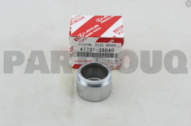

Since basically everybody has issues with seizing brake calipers, the engineer in me came up with an interesting idea. Why not coat the caliper pistons, which are just polished steel, with something a little more durable such as TiN (Titanium Nitride/Gold) or DLC (Diamond Like Coating/Black).
The OEM pistons themselves are $15 each, so the front is $120, plus the seal rebuild kit $20
Total of ~$150 plus the coating cost
I have no idea what the coatings will cost but if its reasonable I think it would be worth giving it a shot for a group buy. I am trying to get quotes for TiN and DLC. If its reasonable we might be starting a list boys!!!
It's either that or try and get some machined from stainless steel.
Any other ideas? Who's interested?

are the pistons polished, or chromed?

Not sure on that one, some have said they are chrome plated, and that seems the norm elsewhere the more I do research so they probably are.
But assuming the pistons are already chrome plated, I would only really need to coat the calipers.
Cerakoting is very popular and some websites offer caliper coating services pretty cheaply, and it's thin enough it can be applied everywhere and comes in any color.
DLC is stronger though if I can find a place that will do calipers for the right price.

Does anyone know if the remanufactured semi-loaded caliper options out there have as good of pistons as OEM? I believe OEMs are chrome plated. Has anyone seen aftermarket last as long as OEM? I might just swap out the pistons for OEM if they are better, I can buy an OEM piston to compare with.
Found out if oem is chrome plated?
The pistons are not chrome plated. That would be prohibitively expensive. Those talking about cerakote, that would not add any corrosion or abrasion resistance.

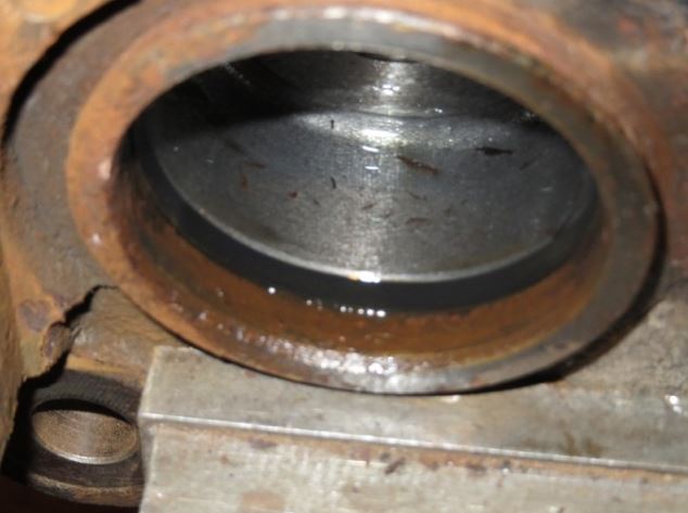

The OE pistons are not just polished steel, they are chrome plated. They have excellent corrosion resistance. The issue is that moisture collects around where the boot fits to the casting...then slowly creeps under the boot and around into the bore where as the paint or zinc plating degrades, pinching the piston...as seen in your picture.
The problem becomes worse in rebuilt caliper because the surface where the boot fits is no longer a clean machined surface, but a blasted more porous surface...so the boot doesn't seal as well as it once did.
Once the caliper is all cleaned up and re-assembled, pull the boot back and squirt it full of silicone dielectric grease...then burp the air out until grease oozes out of it. Once it's full of grease, it won't get able to get full of anything else and it will live considerably longer.
