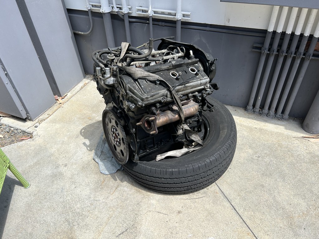

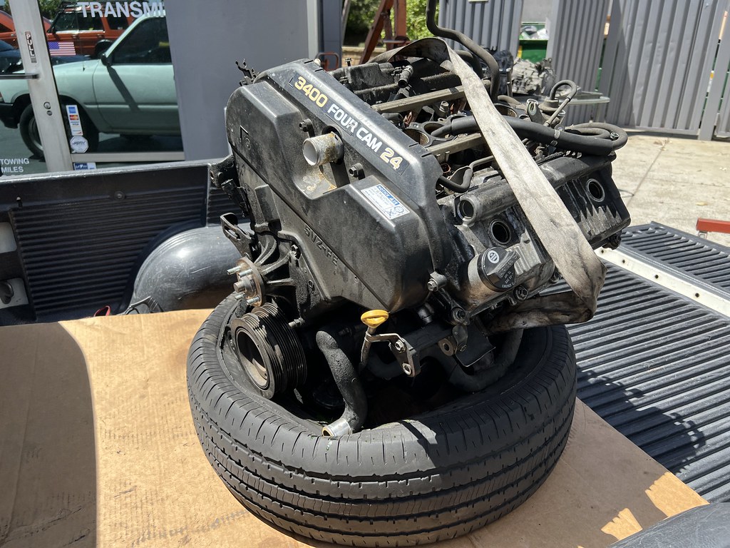

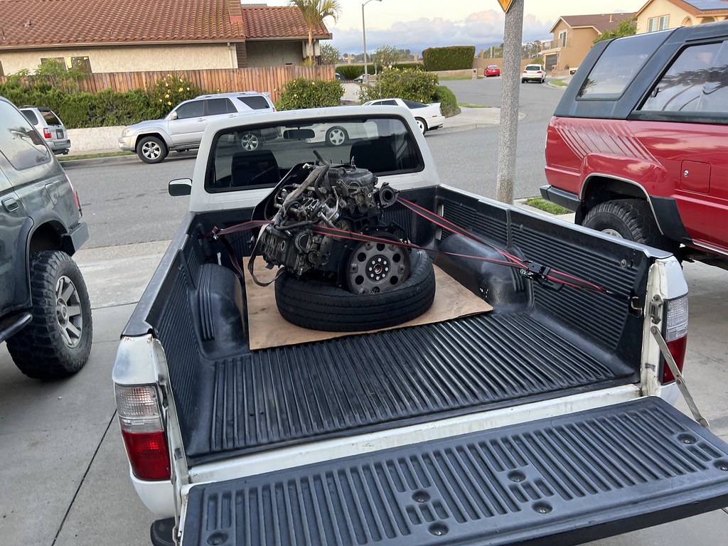

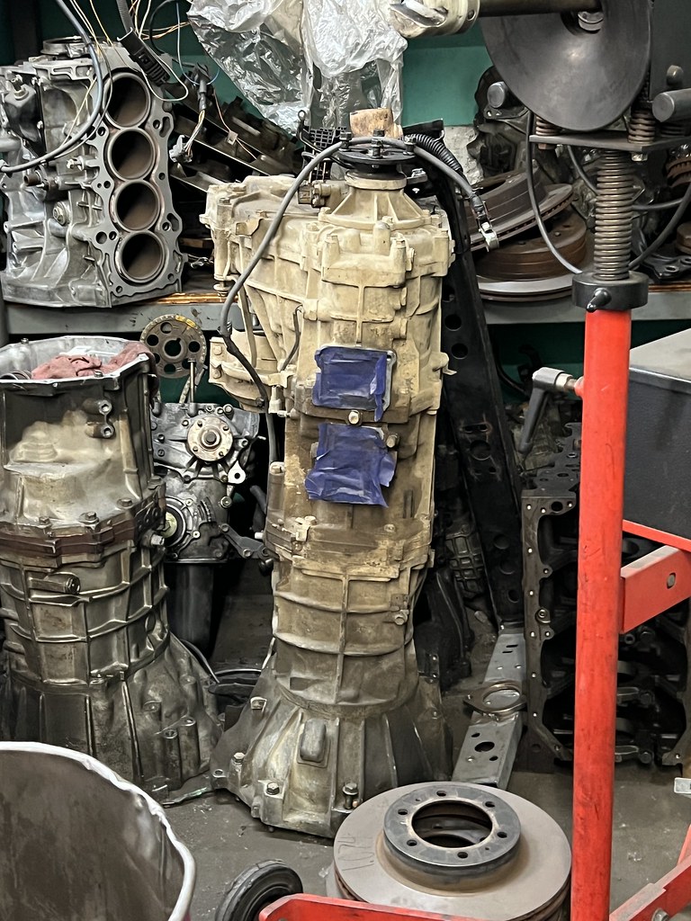

Recently, a friend of mine who works at a local auto shop mentioned that there was a 5VZ-FE sitting on the side yard of the shop.
As any 4Runner hoarder would, I scooped it up just on the off chance that it might be useful someday. It looks to be in good enough condition to rebuild. Worst case, I might end up buying some heads.
Back at home base

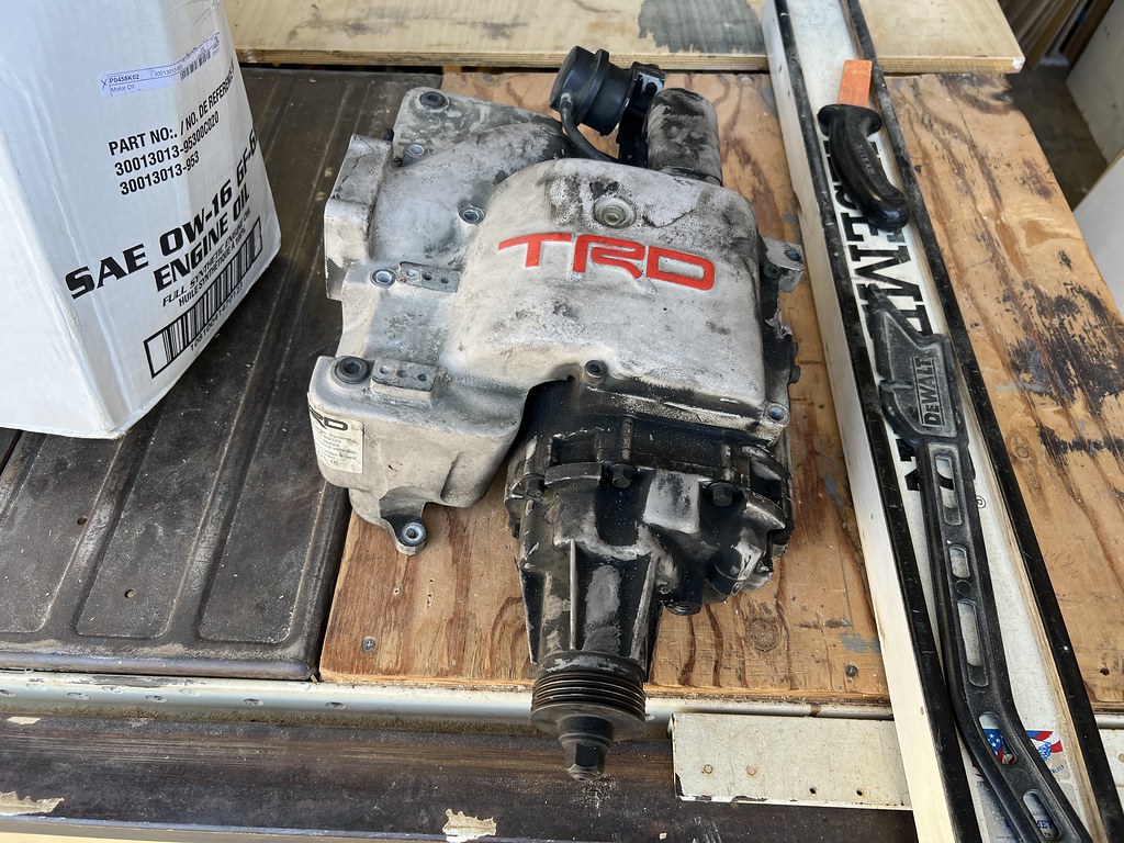

Shortly after that, another deal landed in my lap, a gray top supercharger for $200. Was still in a 2000 SR5 and in working condition, but was making a nosecone bearing noise. The guy didn't want to deal with it and instead opted to sell it.
So for $280, all of the main ingredients for a supercharged 3.4L are just laying around... but what to do with it?

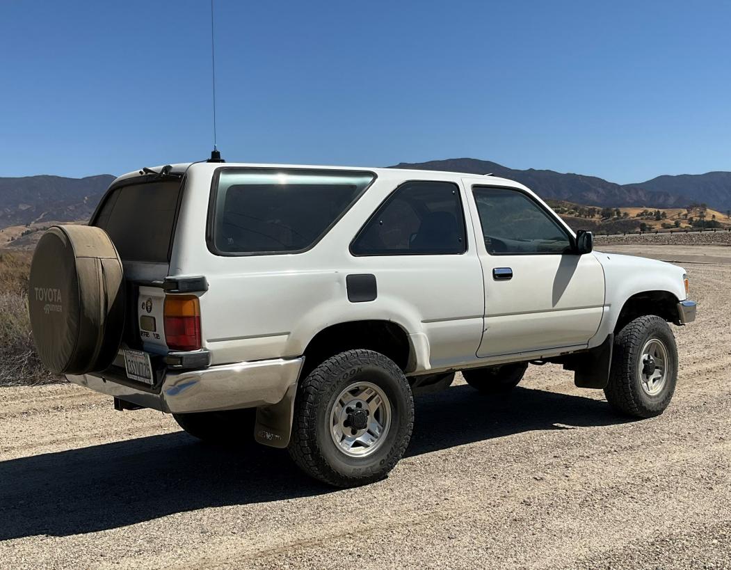

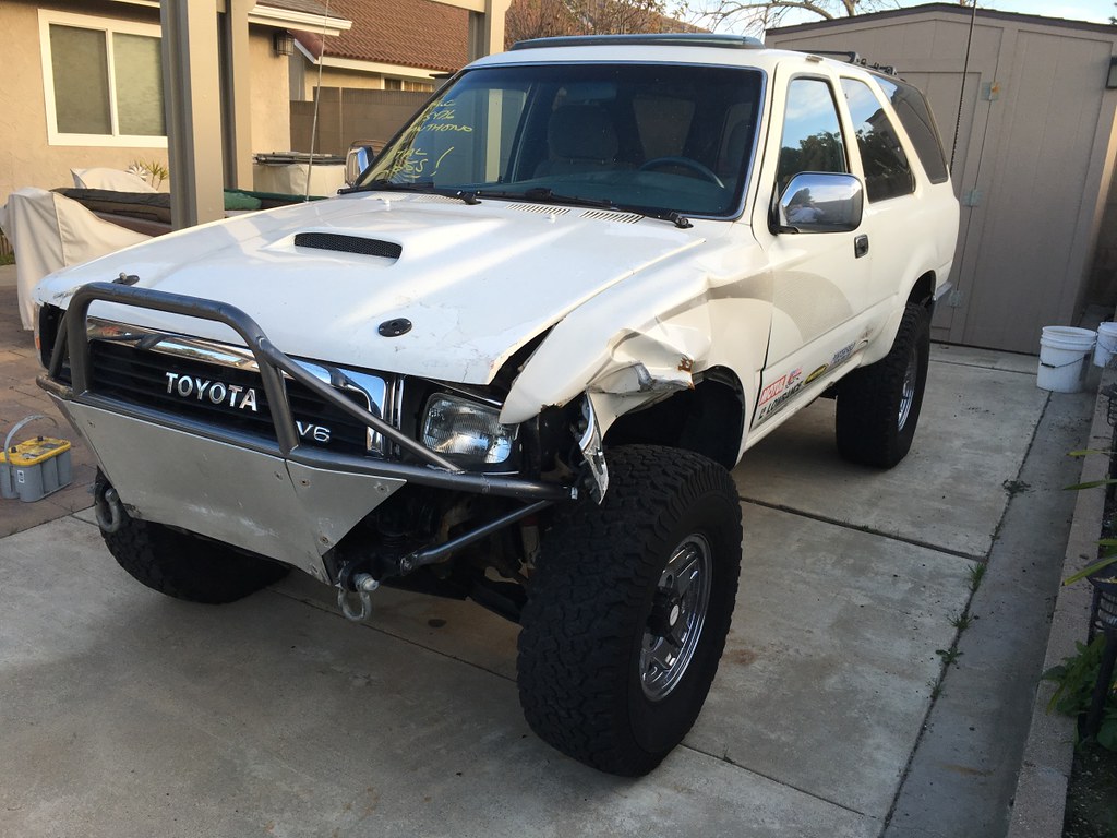

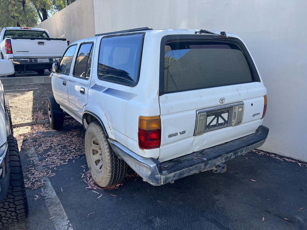

First one I found was white. Owner wanted 5k. 15 miles away.
Problems:
Front end crashed
Rear tire carrier
Salvage title (total loss)
Needs a shit ton of body work
Modded to hell and back

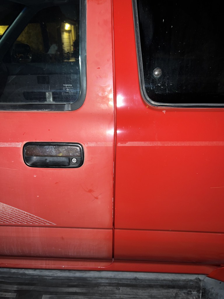

Second one I found was red... more than one shade of red. Owner wanted to trade for an SFA truck. 40 miles away. Have seen it on IG.
Problems:
Mismatched panels
Faded paint
Rear tire carrier
Owner only willing to trade, no cash sales
No spoiler
Modded, clearly been wheeled hard

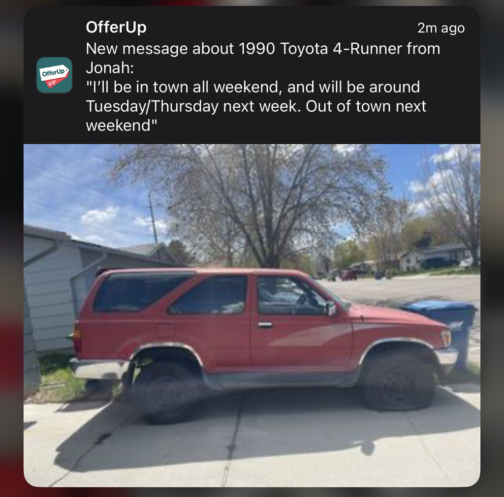

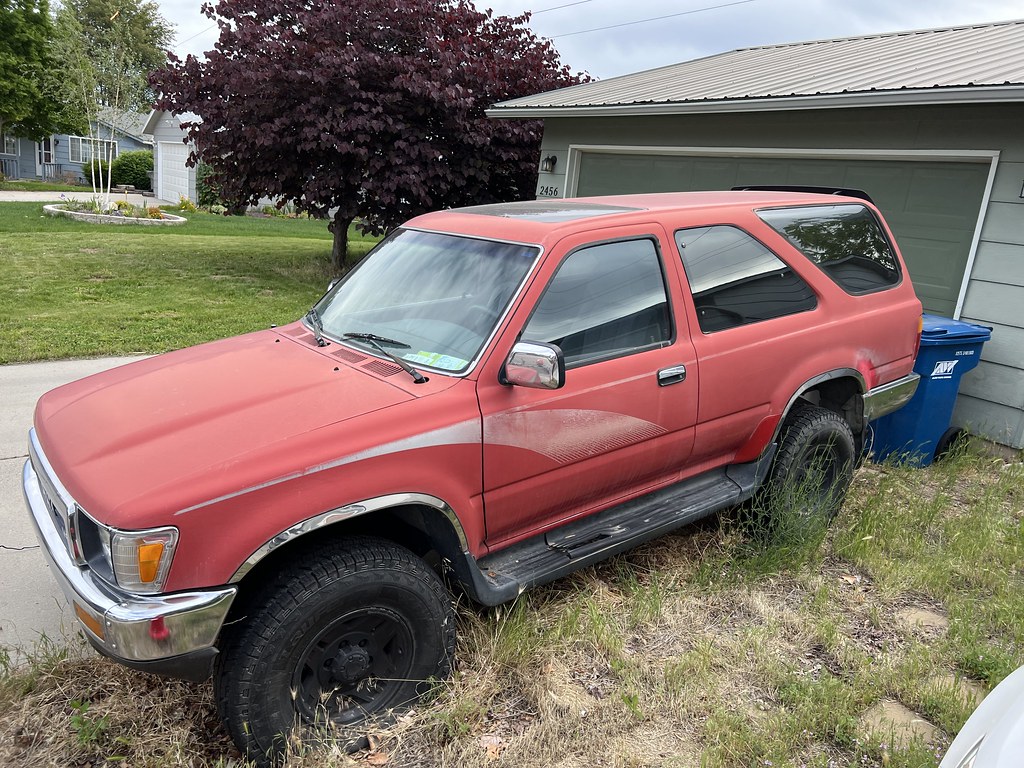

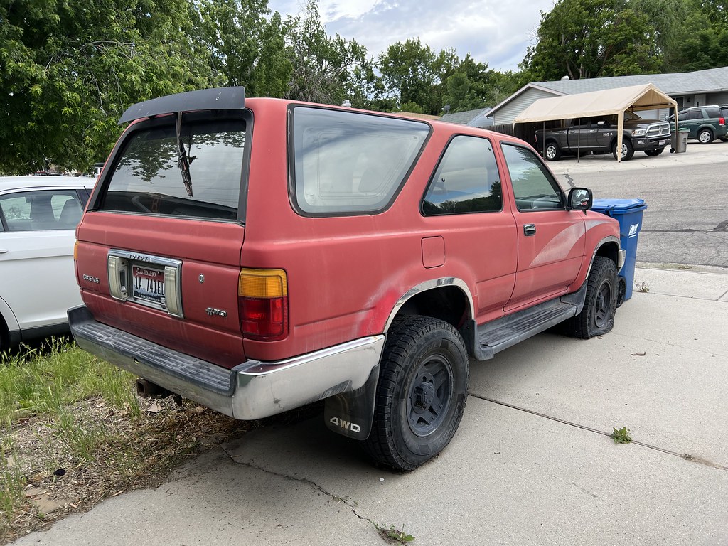

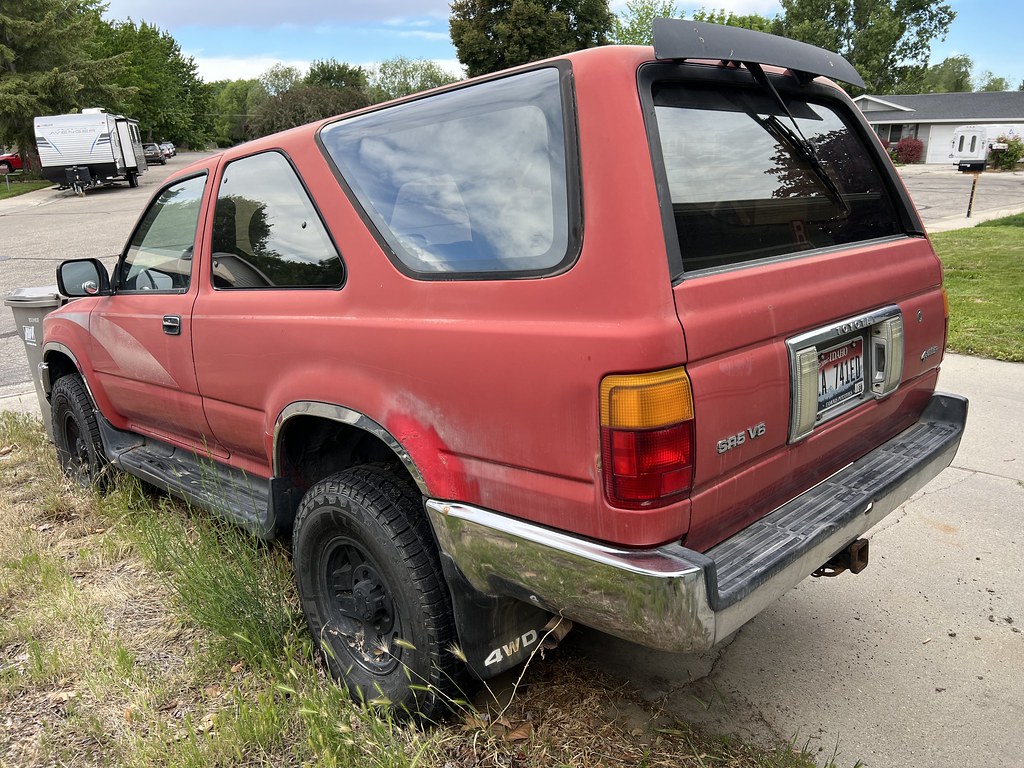

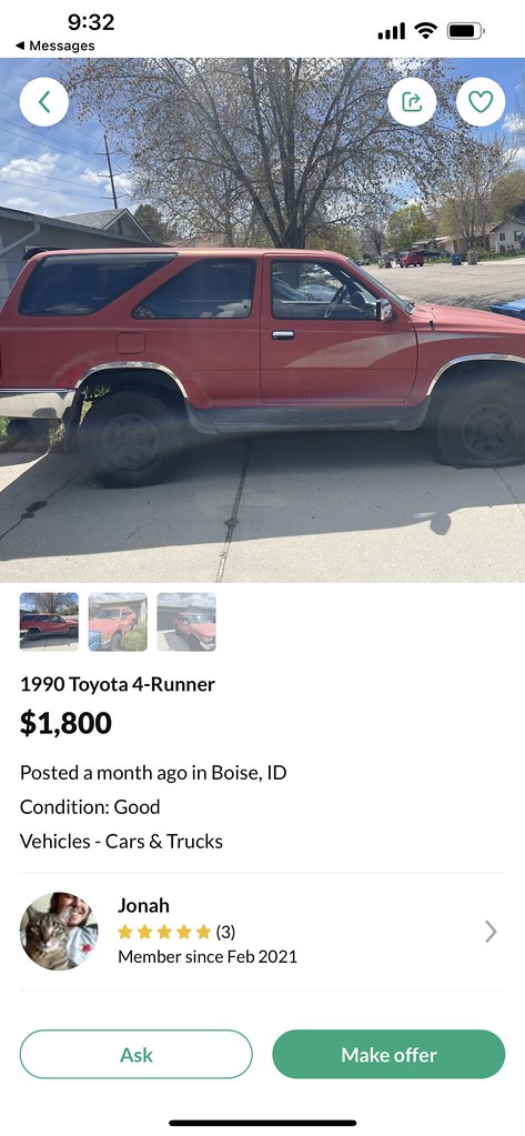

Third one I found was single stage Cardinal Red, so it would undoubtedly polish out pretty well.
Almost checks every box. Only a few issues:

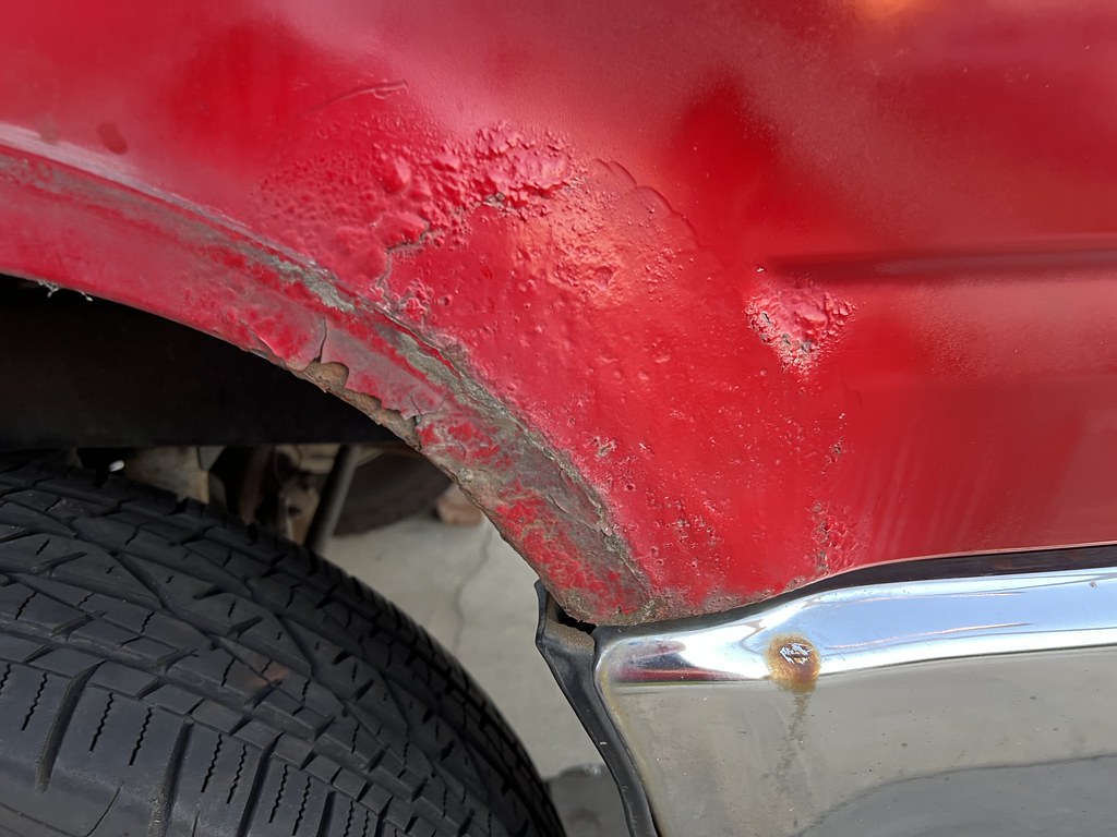

Some rust developed on quarters
It's 1,000 miles away

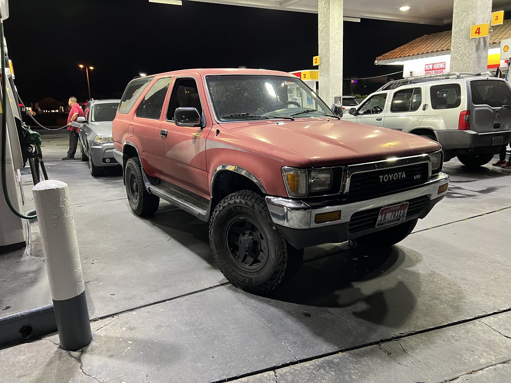

Anyone up for a road trip? Orange County, CA to Boise, ID in one shot!
Although we did stop for a Gordon Ramsay Burger in Las Vegas, NV
Cedar City, Utah

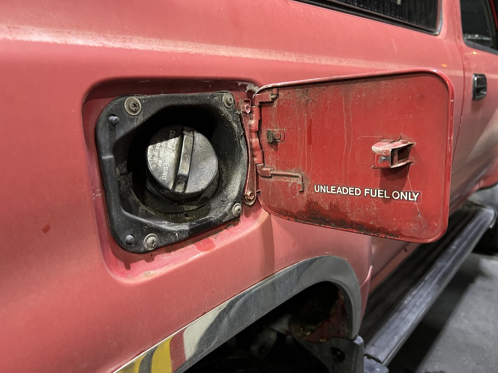

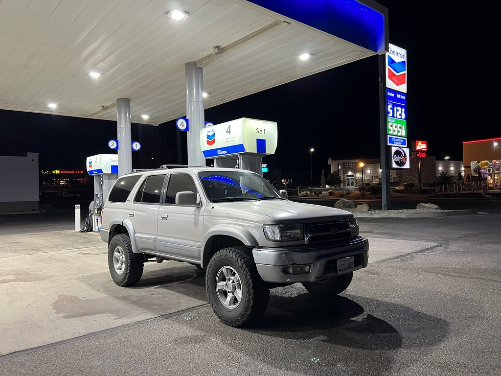

Why does Utah have 85 octane regular fuel?
Salt Lake City, Utah
And a quick stop at U-Haul in Boise, ID...

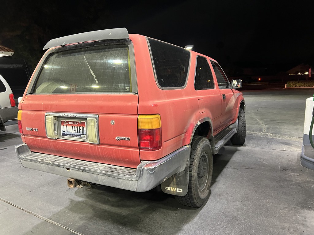

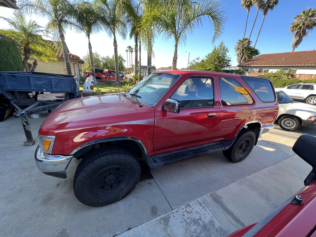

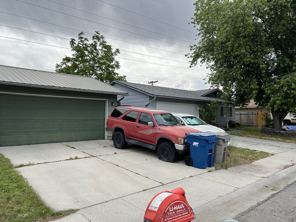

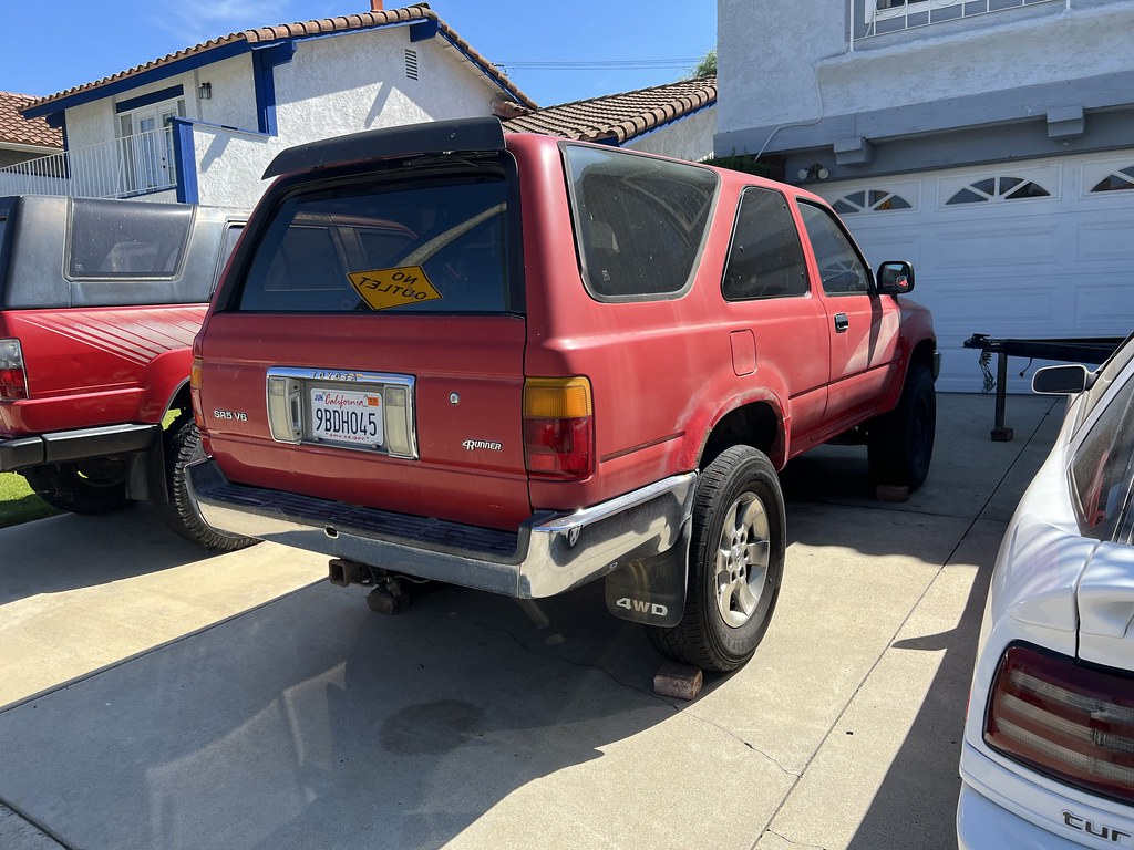

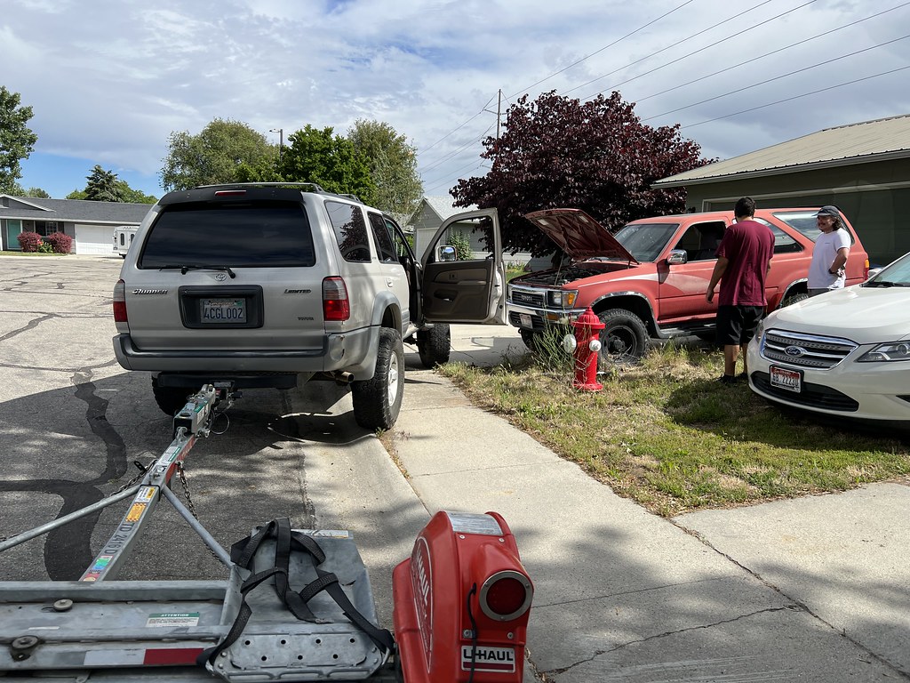

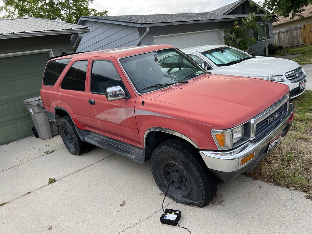

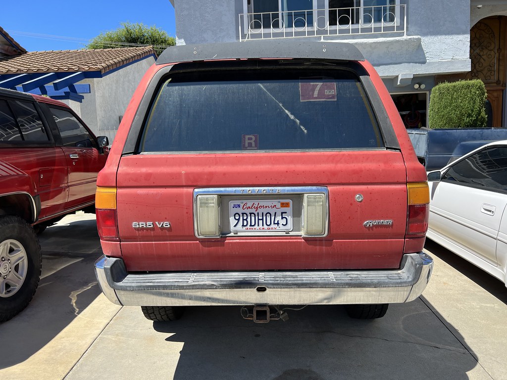

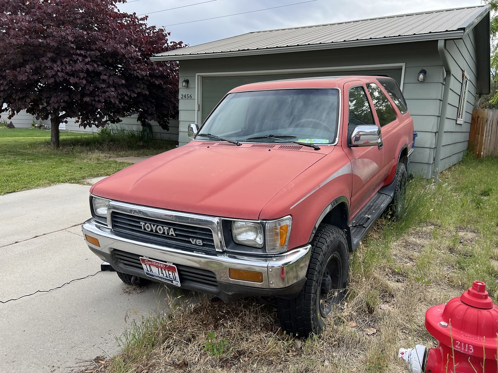

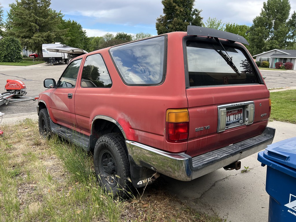

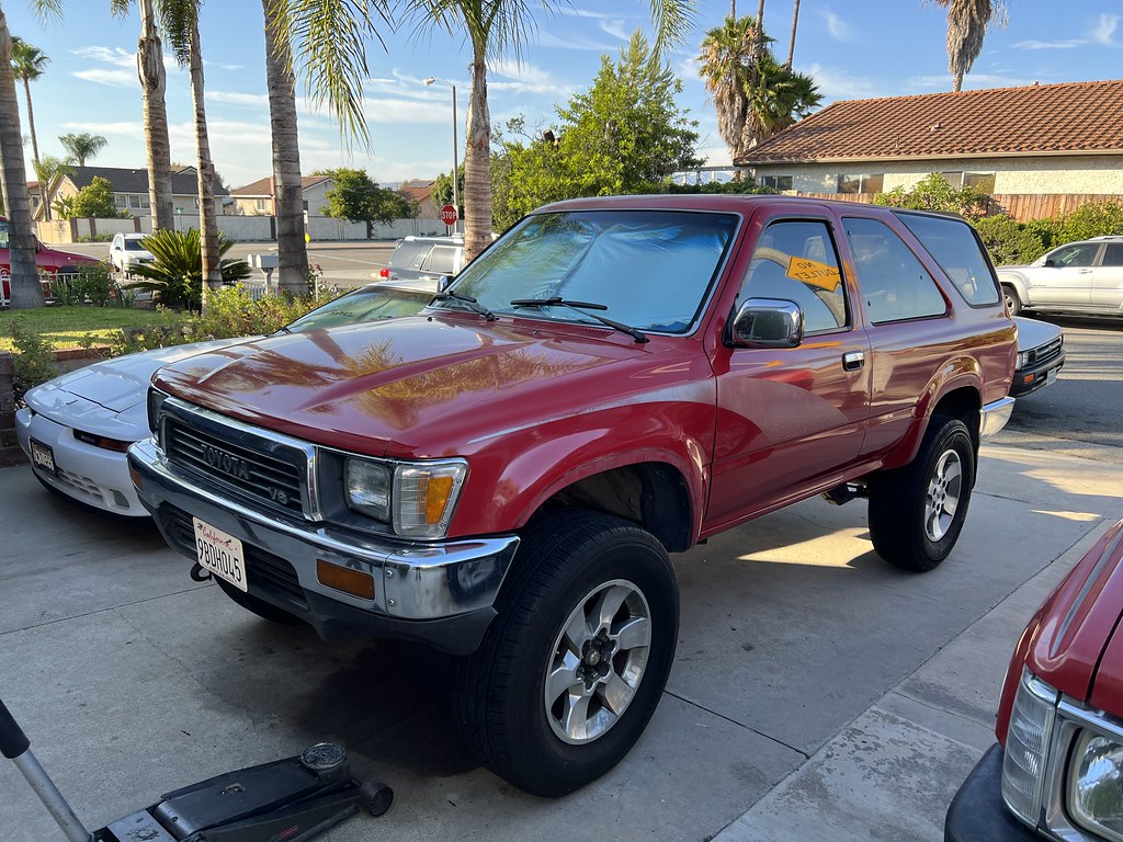

Here she is. Sitting in this spot for 2 years straight.
The tires took air, just enough to roll.

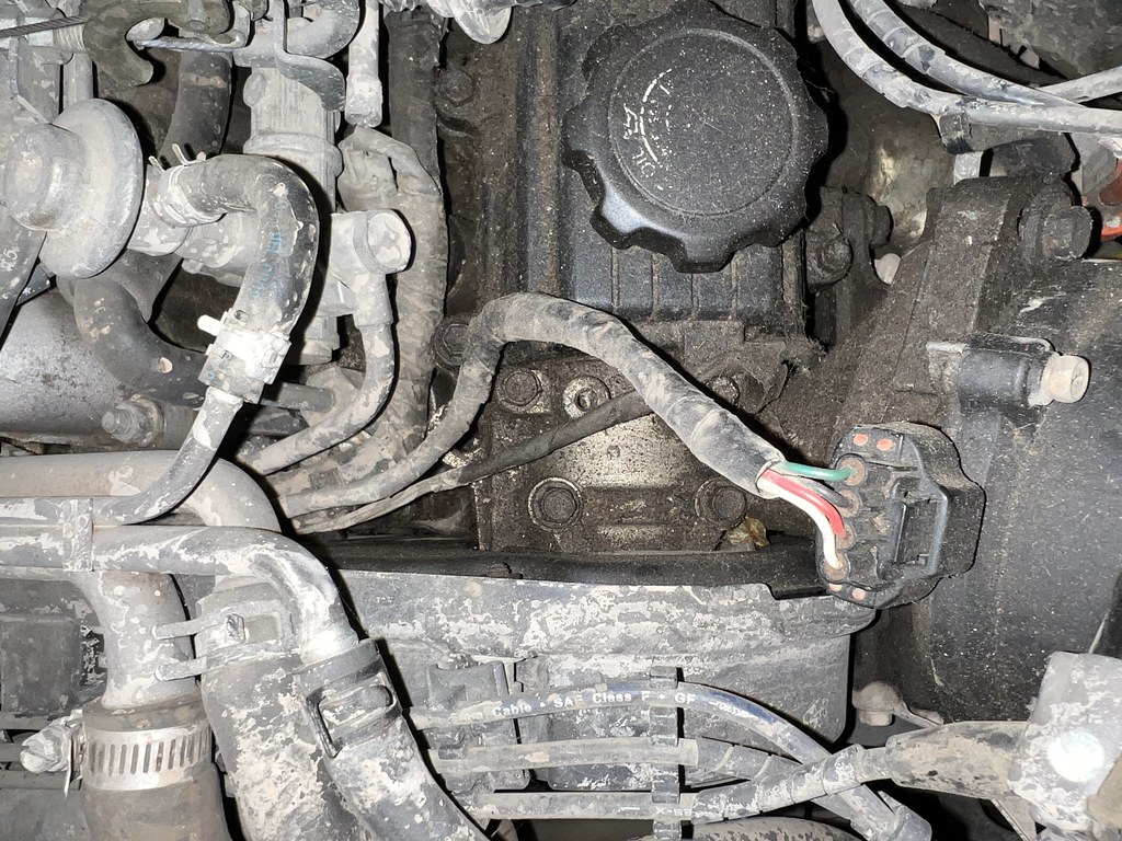

I popped in a fresh Costco battery and got to poking around. It cranked, but no start.
Turns out that the distributor wires had been worked on at some point and had bad connection. A little wiggle action and it fired right up and drove onto the trailer.

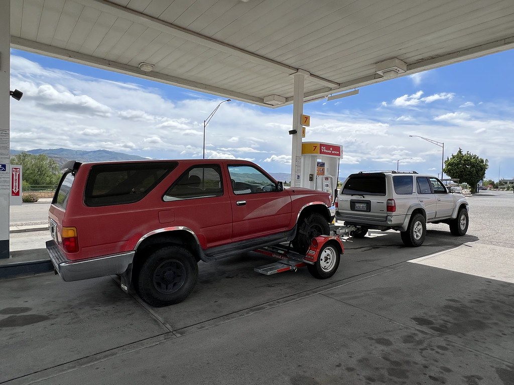

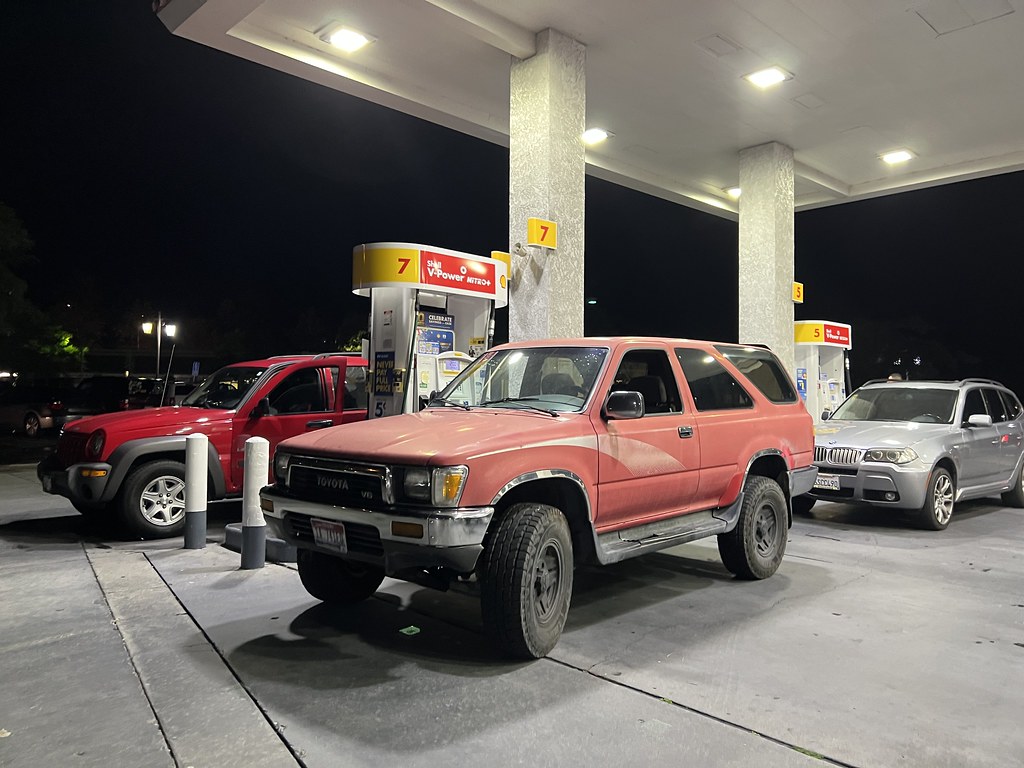

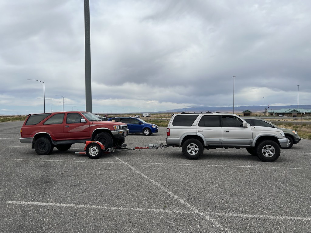

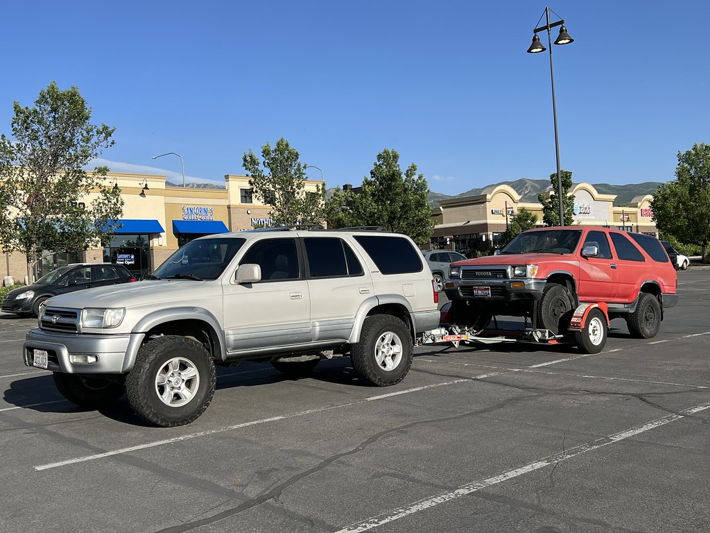

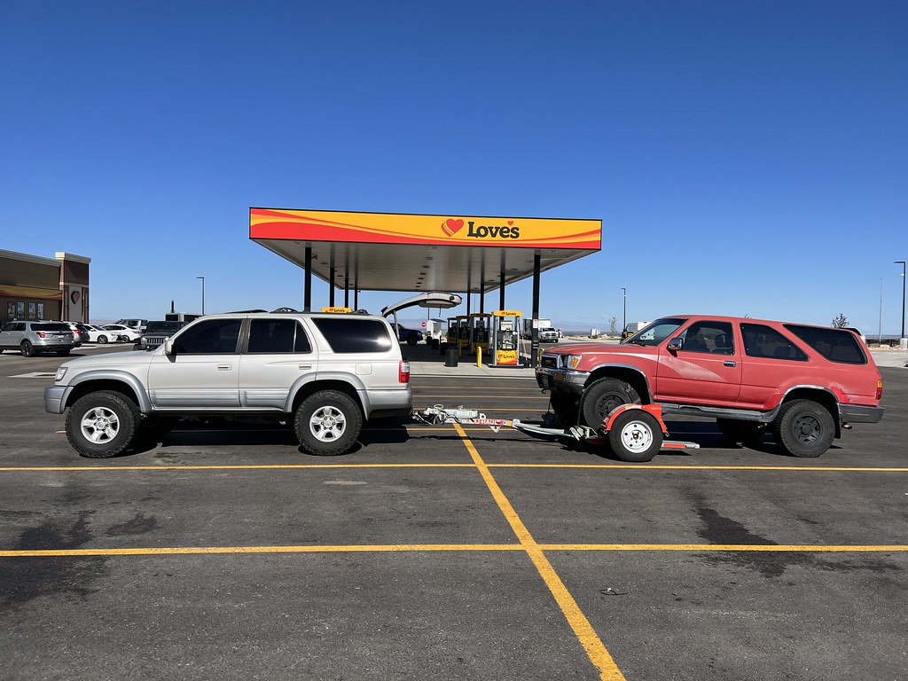

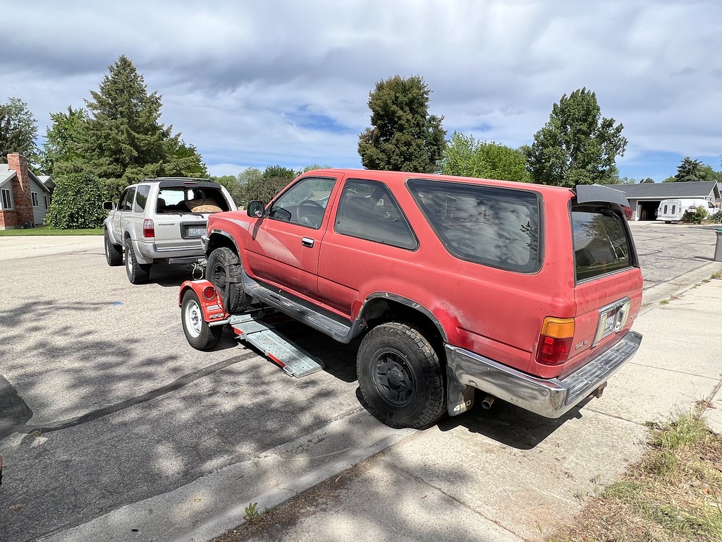

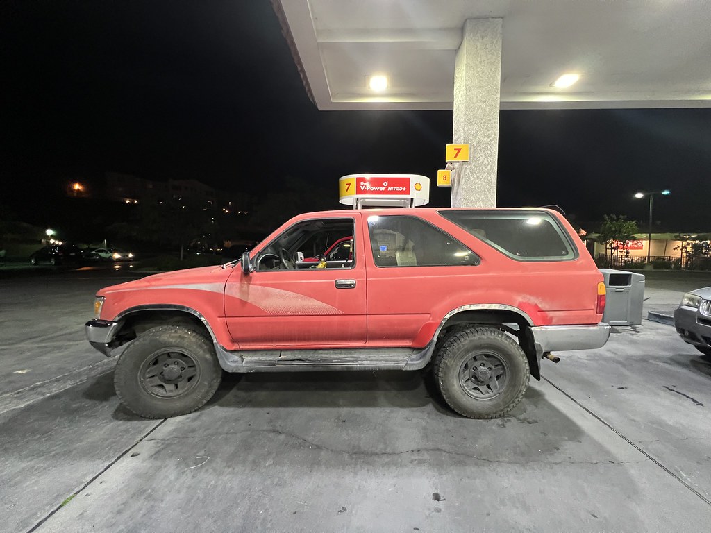

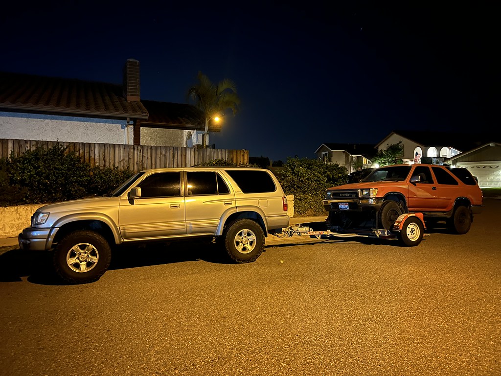

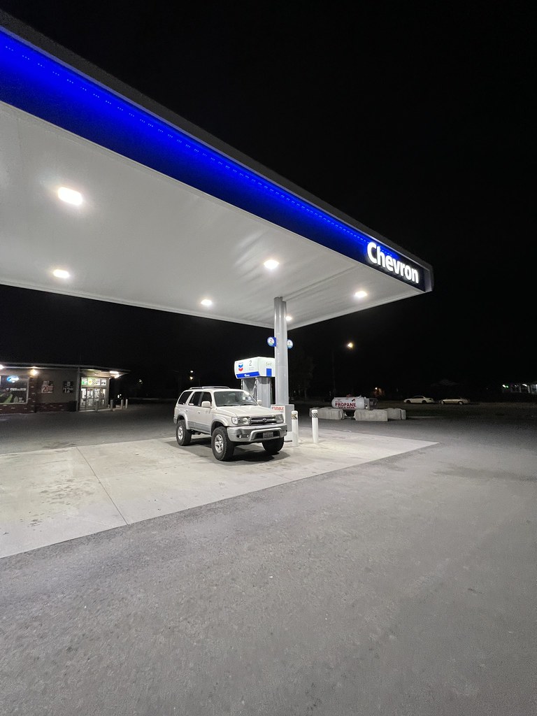

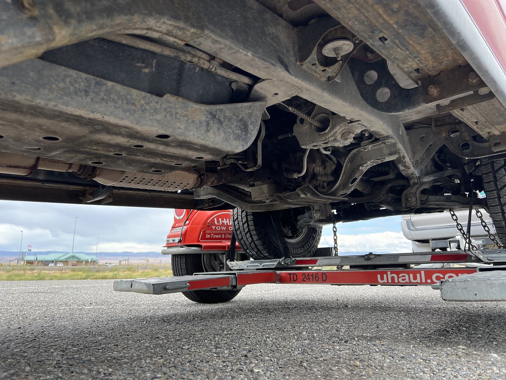

Off we went back to California. Here's our first stop with the 2nd gen in tow, a shell station in Boise, ID.
In case you're wondering what Idaho looks like:
Felt like we were being tailgated. Towing cars is always interesting. My first time towing one across state lines. First time towing one beyond 130 miles.

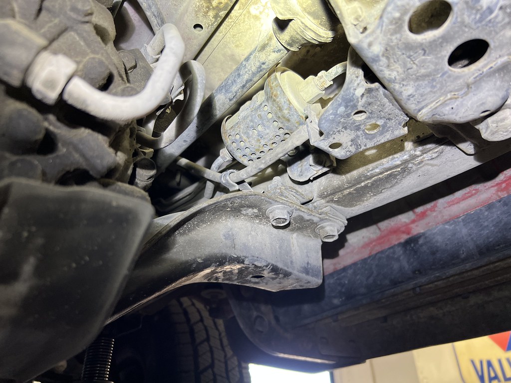

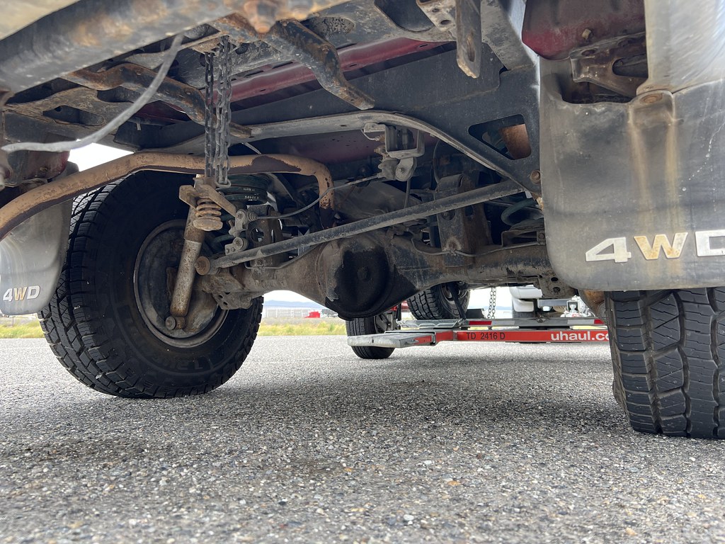

Fairly clean underneath. Not much salt is used in the area. Dirty, but manageable. A great canvas. Bonus, it has H&R springs in the rear, so the rear sag issue is no more.

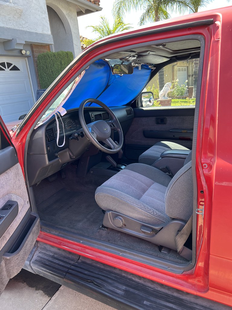

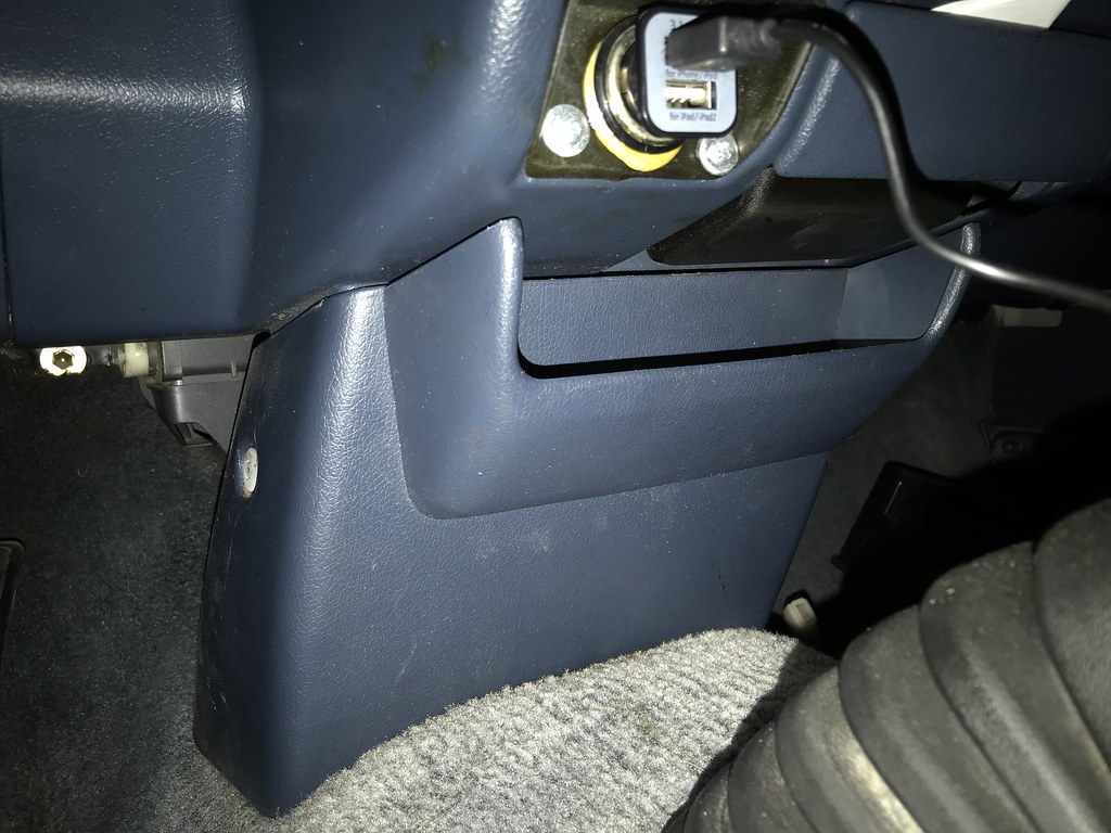

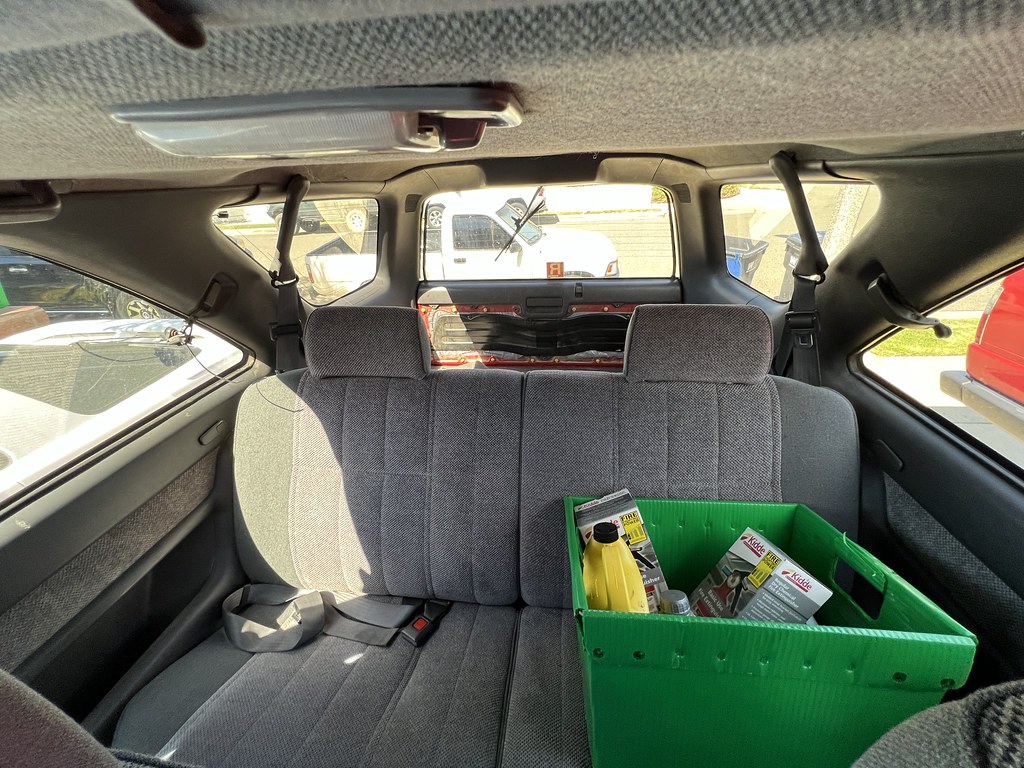

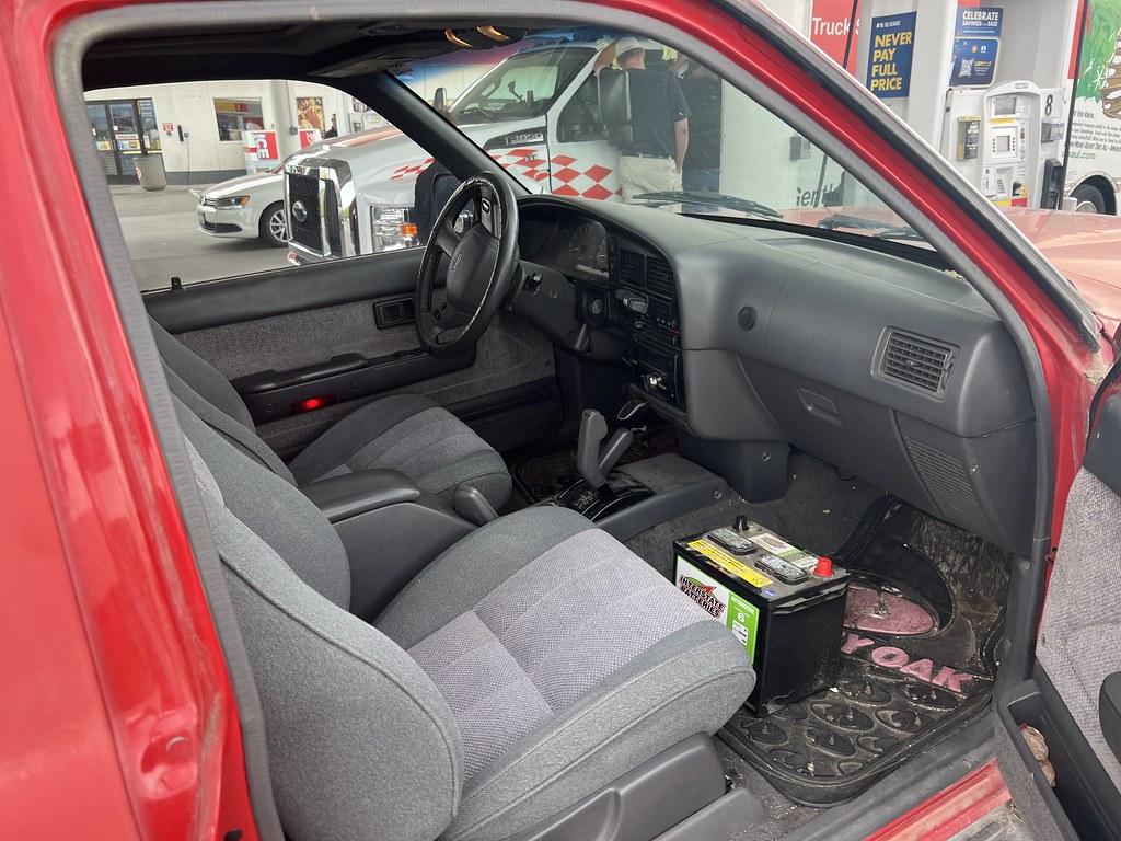

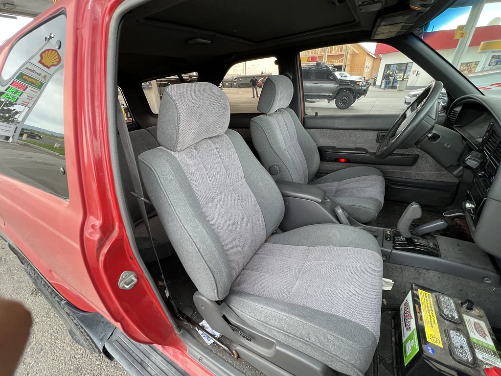

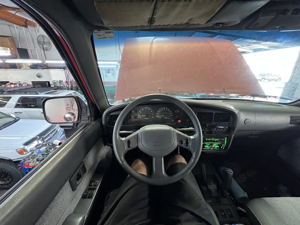

Interior is quite clean! The seats are in great condition. The dash has some cracks.

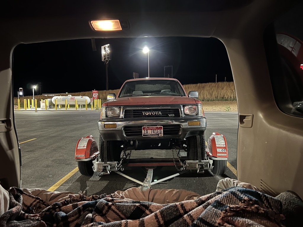

Finally got too tired to keep driving. We drove all through the previous night and we tried to make it back to Las Vegas, but we didn't have it in us. We stopped and slept in the back of the 3rd gen.

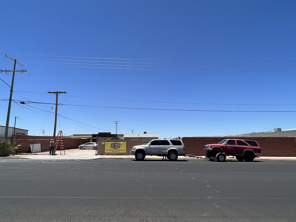

Quick stop to meet the folks at Matt's Off-Road Recovery. They were all very nice and we felt welcomed. They gave us a tour of the shop. Can post more pics if anyone's interested.

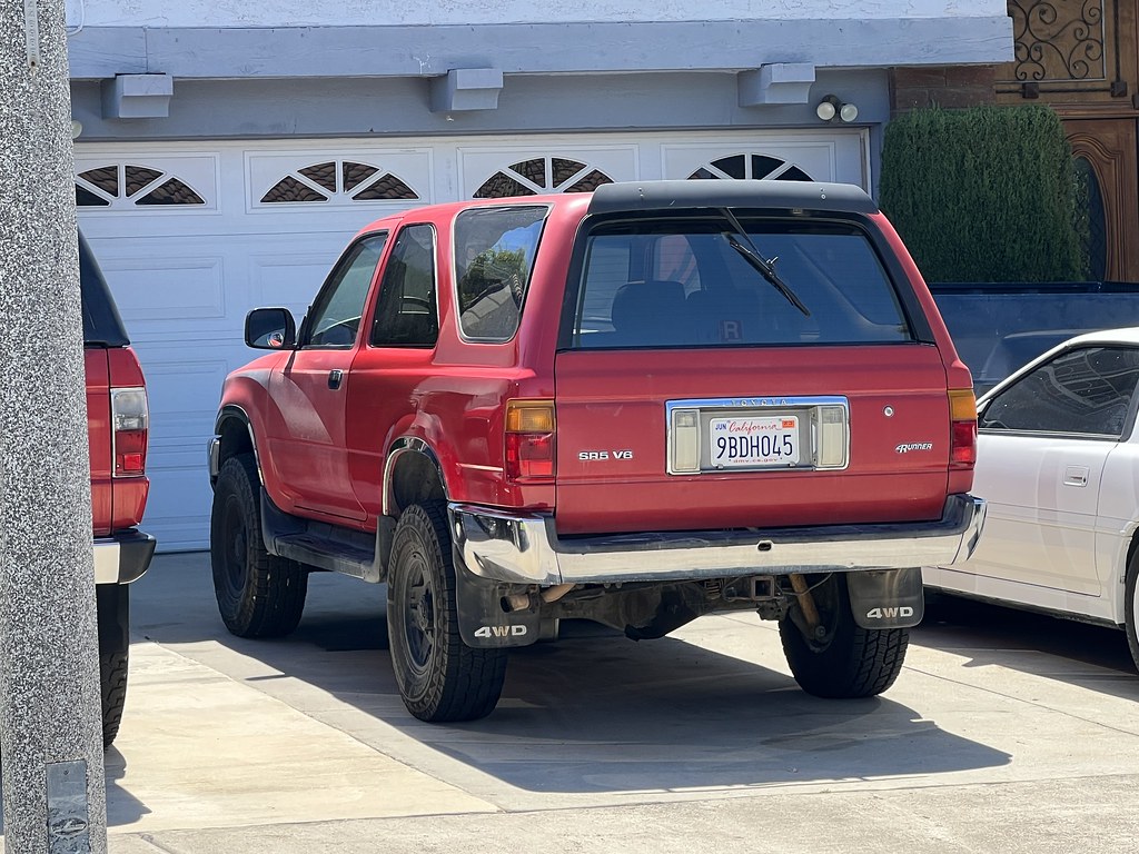

Back home!
Mission Viejo, CA

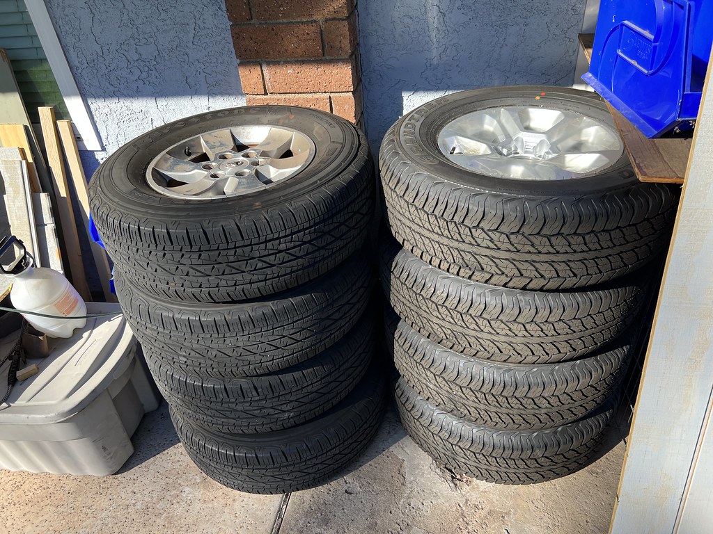

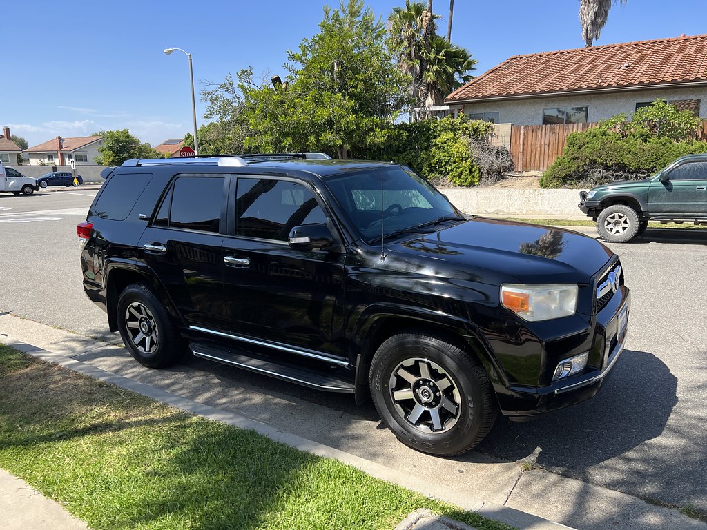

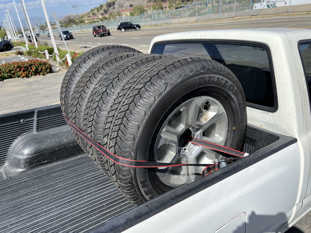

The next morning, I scored a set of new takeoffs from a 2022 4Runner. Still had the plastic on them. Figured these would be a better solution than sticking with the blackened 15" wheels.
The very next day, I scored a second set of takeoffs from another 2022 4Runner. These ones were a perfect gift for my dad on Father's Day.
This meant I now had a set of 2011 SR5 wheels laying around that might be a better fit for this older truck.

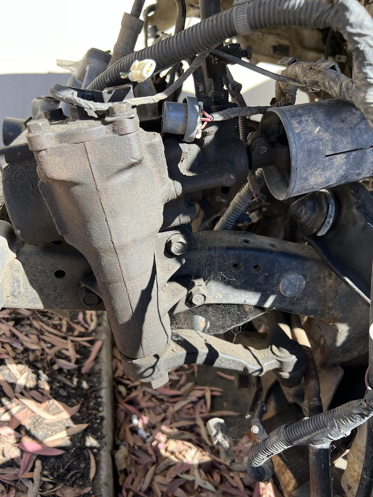

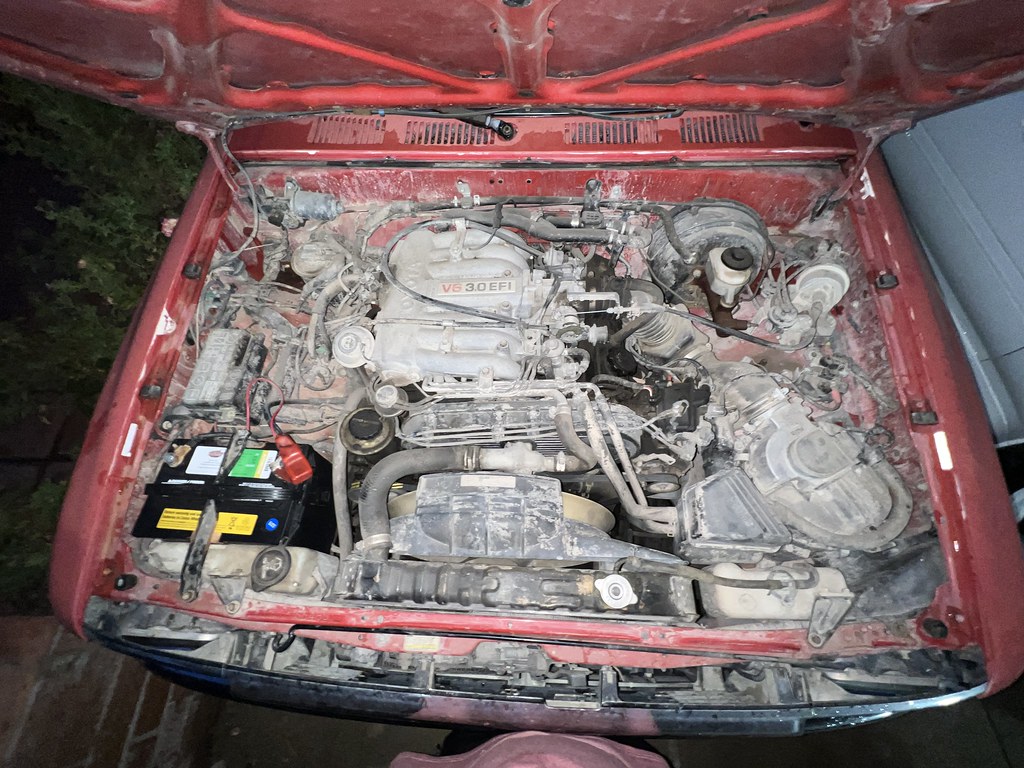

A shot under the hood. Some obvious leakage from the power steering pump area. The bay is dirty as expected from a vehicle in Idaho.
The motor appears to have already been significantly repaired. The head gaskets are definitely not original and there's evidence that the whole motor was rebuilt at some point.
By now, I had not had a chance to run the motor long enough to see if there were any issues. It was low on fluids, but the coolant and oil were not mixed, both were clean. Oil change was done 2 years ago, still had another 2k miles before it was due again.
The loose distributor wires were now functioning as intended

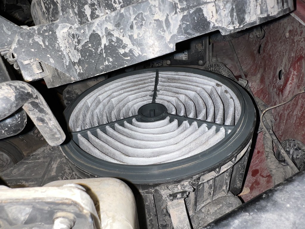

Dirty air filter

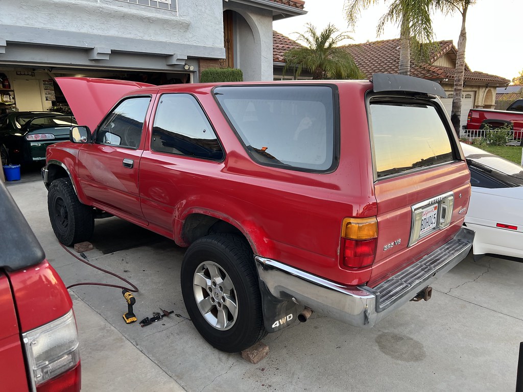

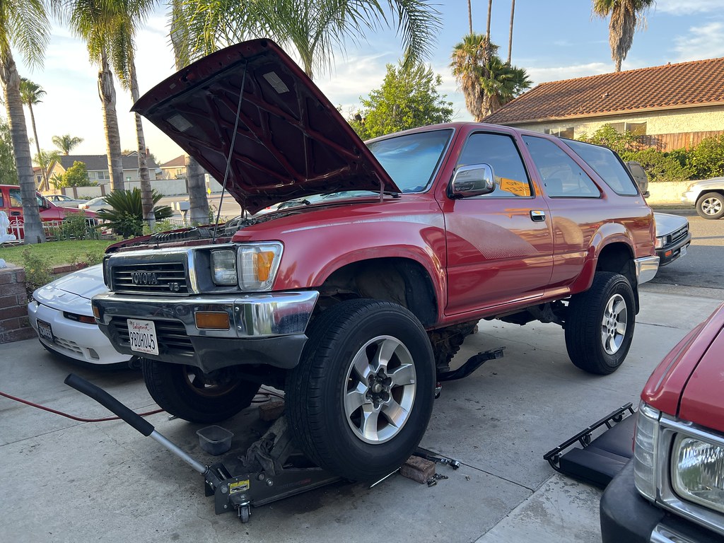

I put 36psi into the tires, topped off the radiator and the engine oil, then popped down to my local Shell station for a couple of fresh gallons. I figured it'd be nice to use 91 octane for some of the detergents.
The very next morning, I went to AAA and got a temp tag for it. The truck was now running pretty smoothly and it was anyone's guess whether it would pass smog. Now was a good a time as ever to get underneath and give it a solid inspection.

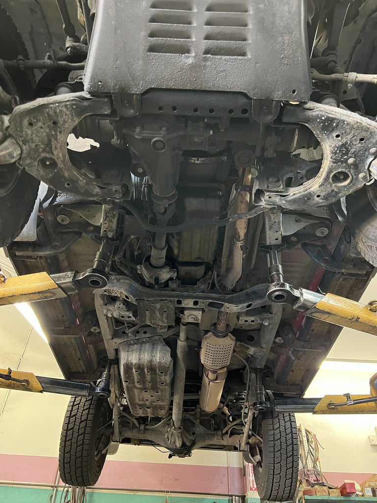

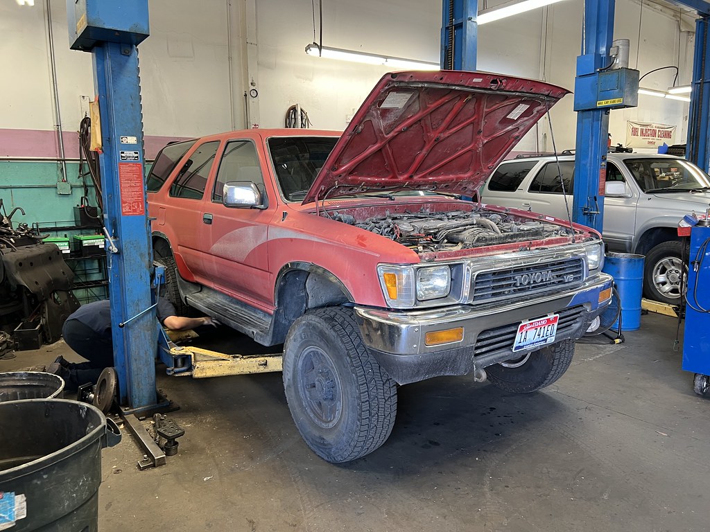

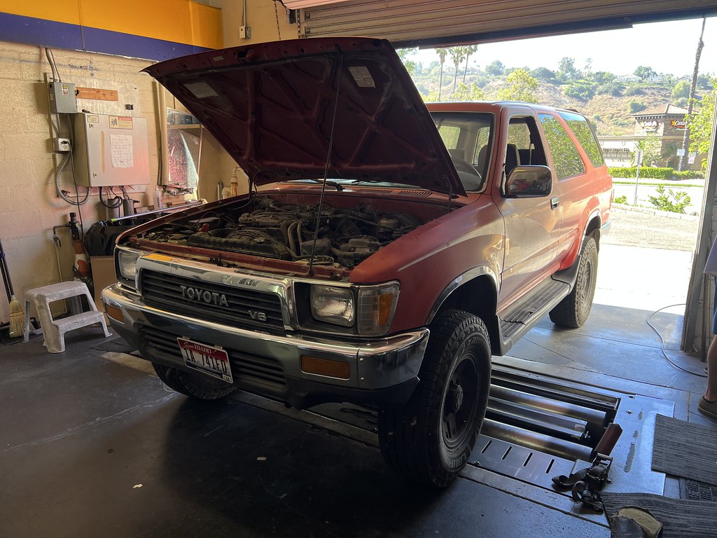

Visiting my good friend John over at Japanese Car Specialties
Could use a fuel filter.

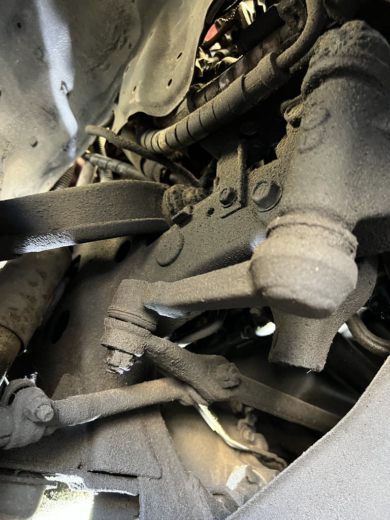

Tie rods, wheel bearings, steering pitman and idler arms, and ball joints were all pretty much done for. Steering box is leaking from upper seal where the steering shaft comes in. Needs steering limit caps.
Tested 4WD and put the wheels up to 40mph. Some noises and bearing groans, but nothing that can't be fixed.

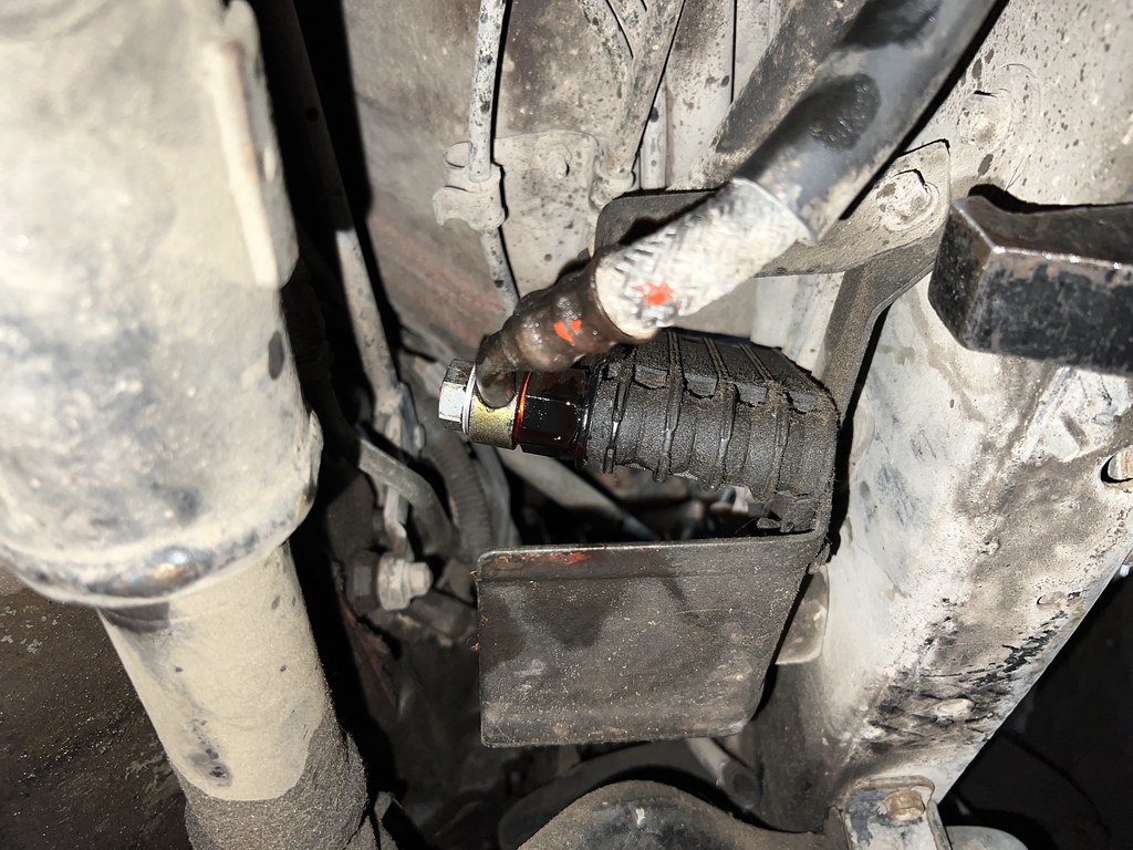

Trans cooler is cracked and leaking.

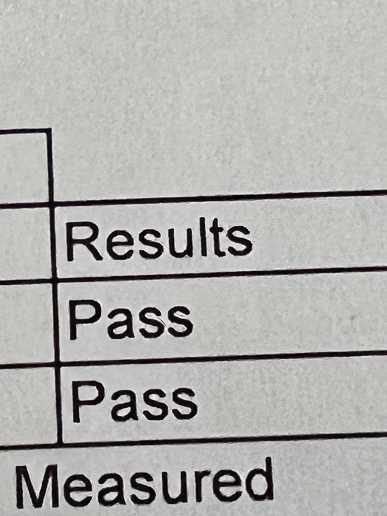

Will it smog?
Yes! First try!

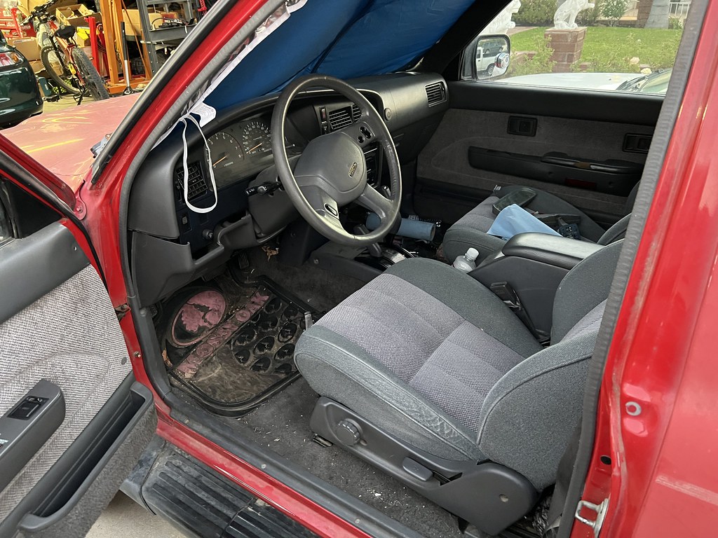

The interior needs a serious vacuuming. This Mossy Oak shit is going in the trash.

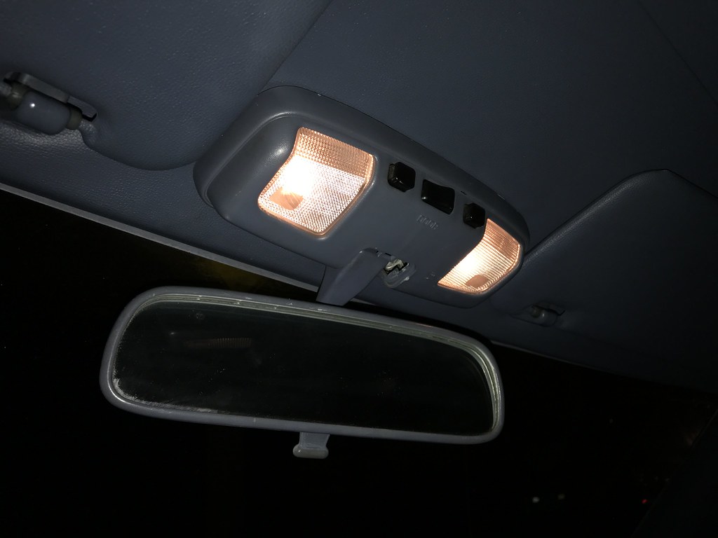

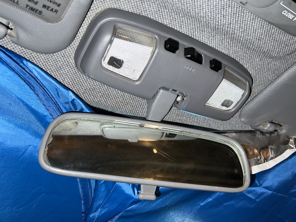

The rear view mirror had come off, and the previous owner tried to glue it back on. I chipped all the super glue off and mounted it back like factory. Gotta find the little trim piece that goes in between the dome and mirror mount.

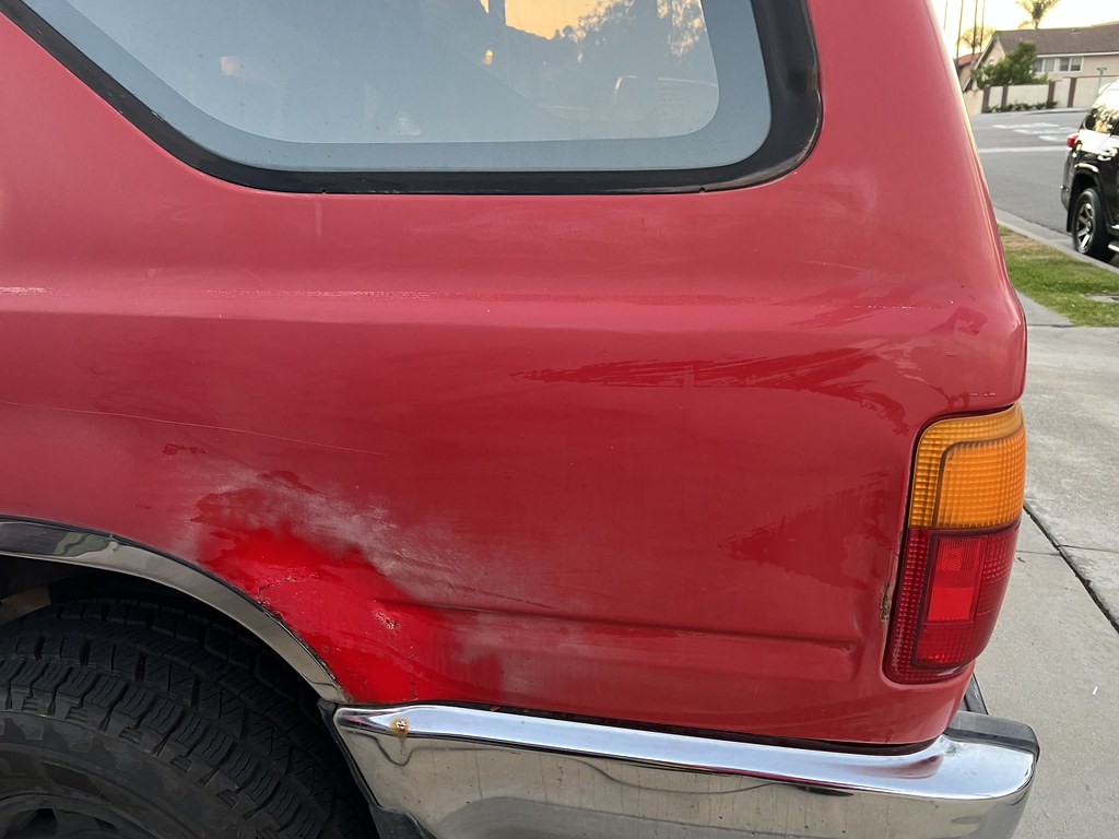

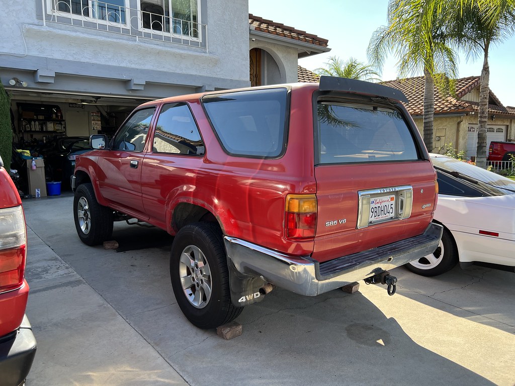

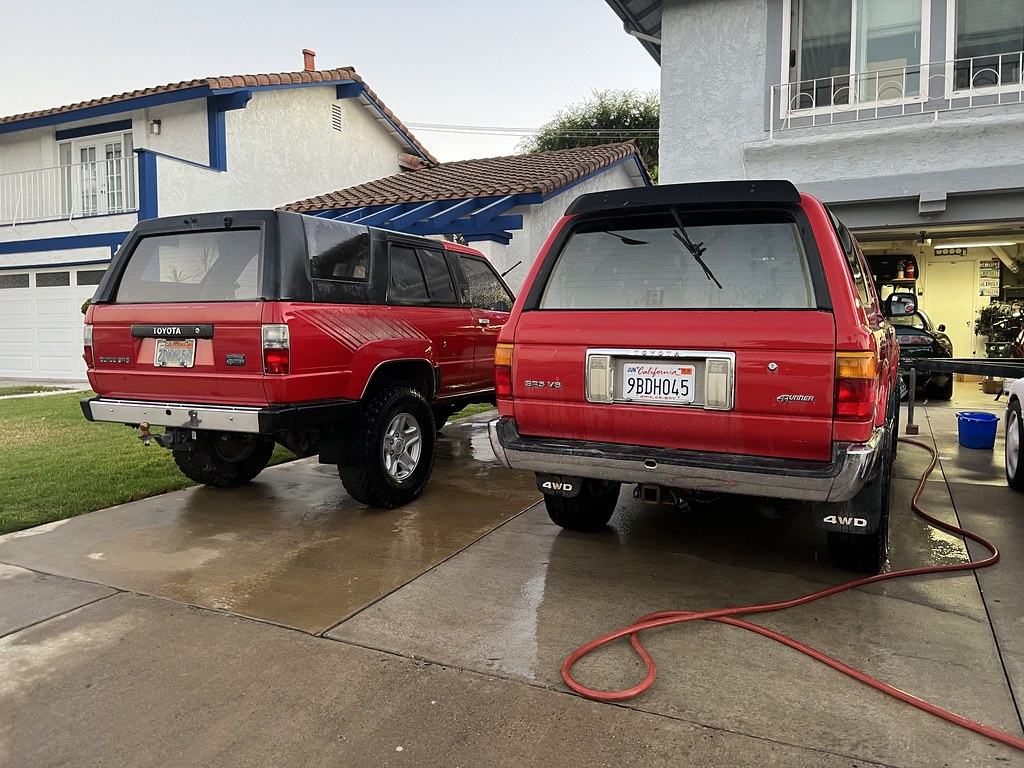

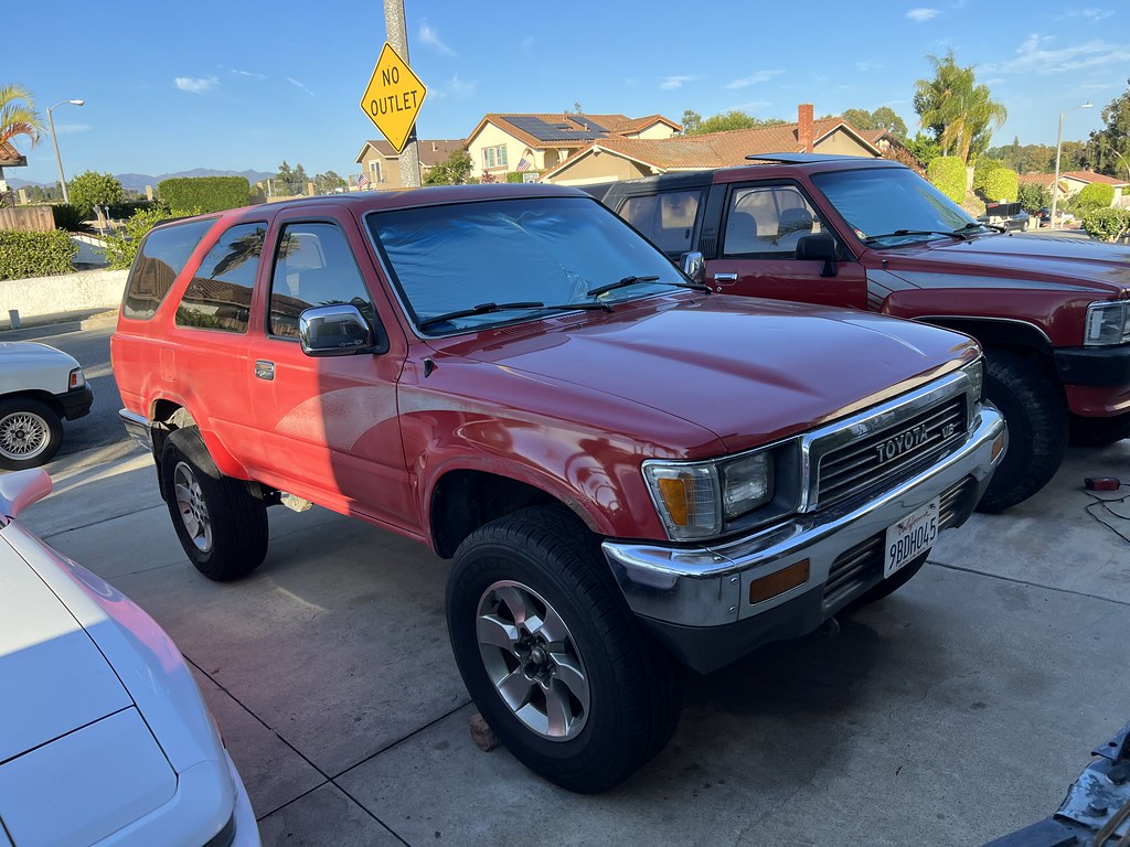

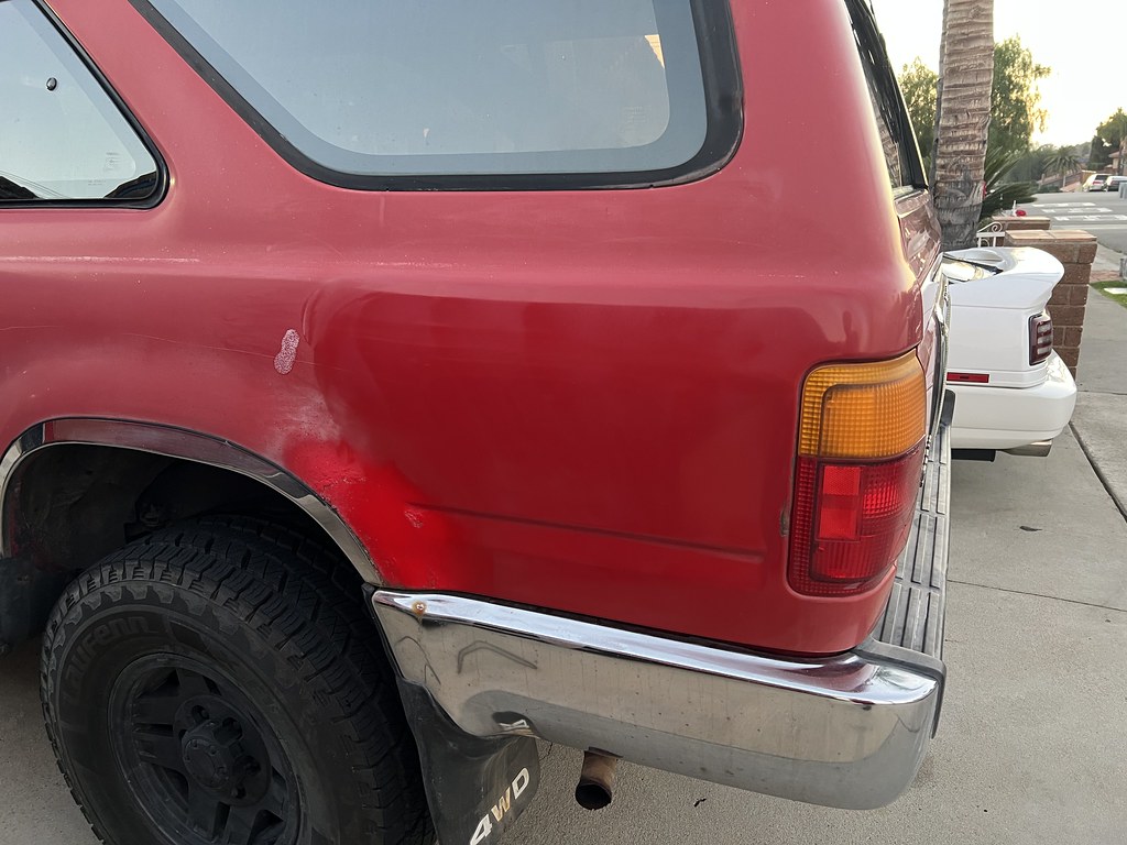

Gave my red classic 4Runners a good wash and clay bar. Very curious to see what the paint will reveal.
nice scores, especially the 2-door. i’ve always liked the 2-door versions. looks to be in great condition for the price you paid. around here, the nitwits think their trashed, rusted, beat junker is worth $6k minimum.

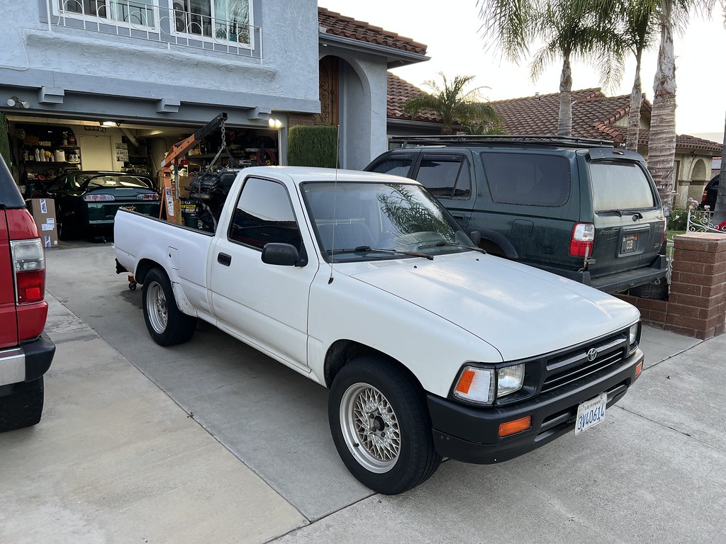

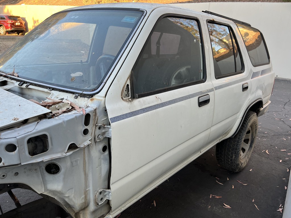

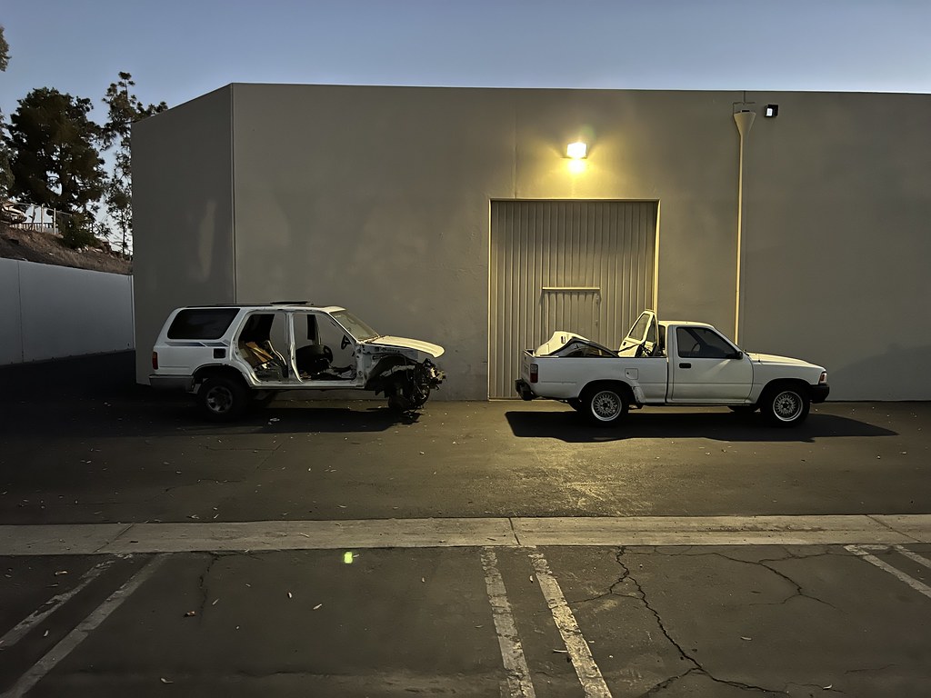

Now I'm entering the parts gathering phase. If you have seen my 89 Pickup build thread in the Other Vehicles section, then you have probably seen this white 93 4Runner before.

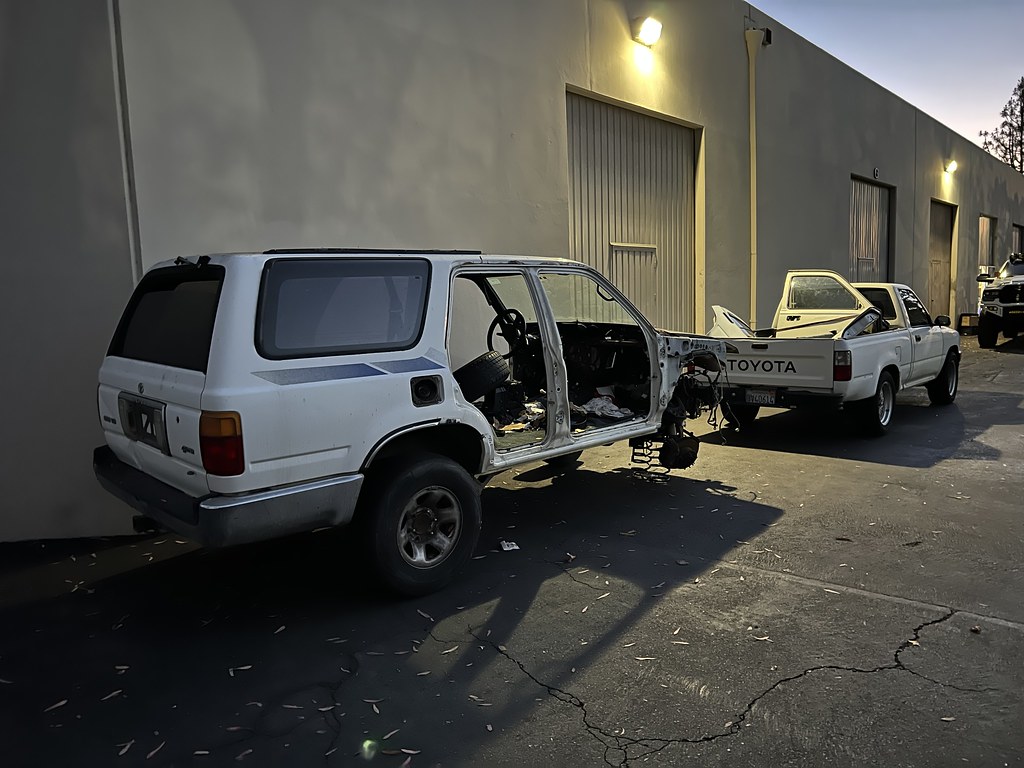

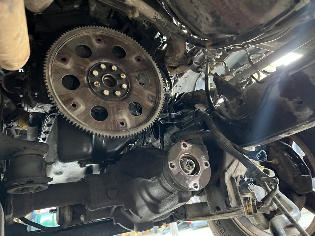

It was parked in a neighborhood nearby when some drunkard crashed into the rear axle. The axle housing was bent and the truck was a total loss.
It had a V6, 5-speed R150F, 4.88 gears, and a blue interior.

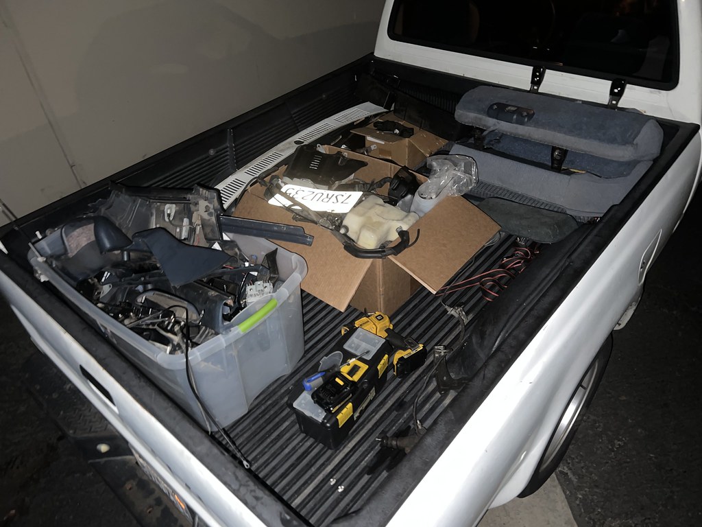

My friend purchased the truck for the gears and the motor. I ended up buying the front seats and console for my pickup. I also bought the front fenders and the entire core support for future 4Runner front end conversion possibilities.
The truck had not been useful to me otherwise. This all changed when I got this 2-door. I traded the new takeoff wheels for the remnants of the truck, including the 5-speed manual R150F transmission, pedals, driveshafts, clutch line, the works...

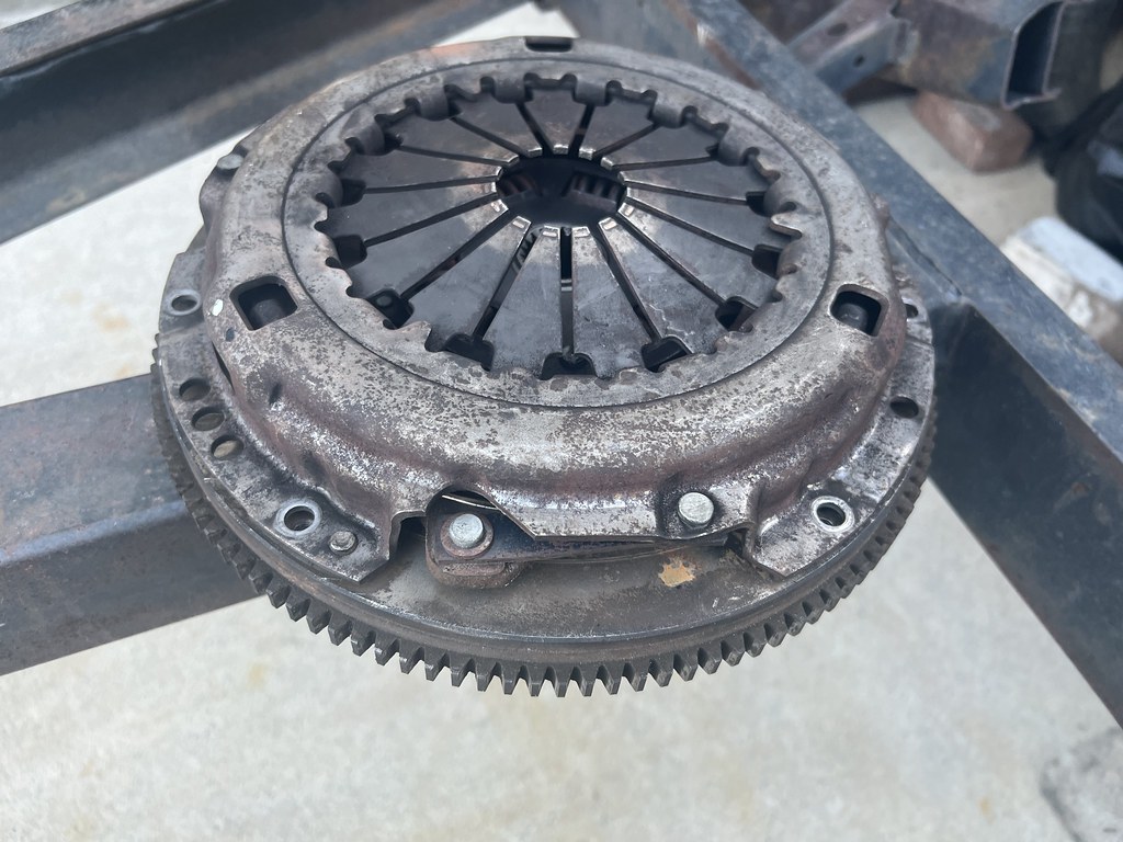

Reusing the clutch and flywheel because we won't be needing these after the 3.4 swap... after all, it's only a 3.0 in there, not like it needs any serious gripping power.
It also has a clean steering box that doesn't leak. Other bonus goodies include a set of ball joint spacers, definitely taking those!

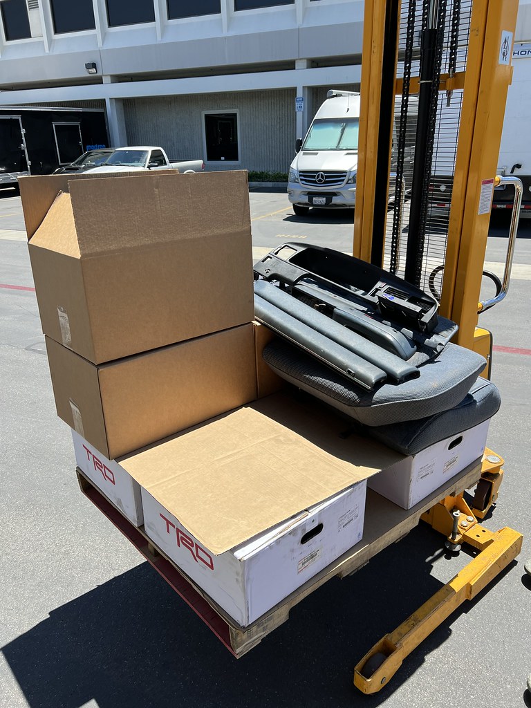

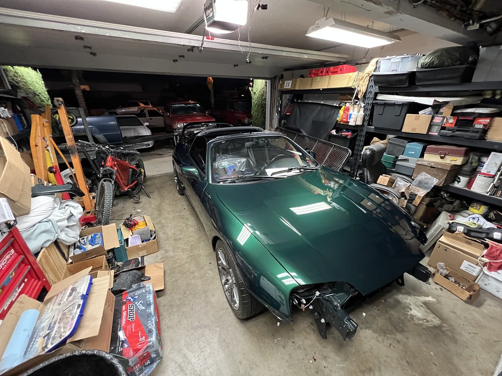

I'm putting all of the useful parts into boxes, then onto a pallet, then storing it in my warehouse. PM me if you need anything. Happy to ship! Also have doors and larger objects which are pickup only.

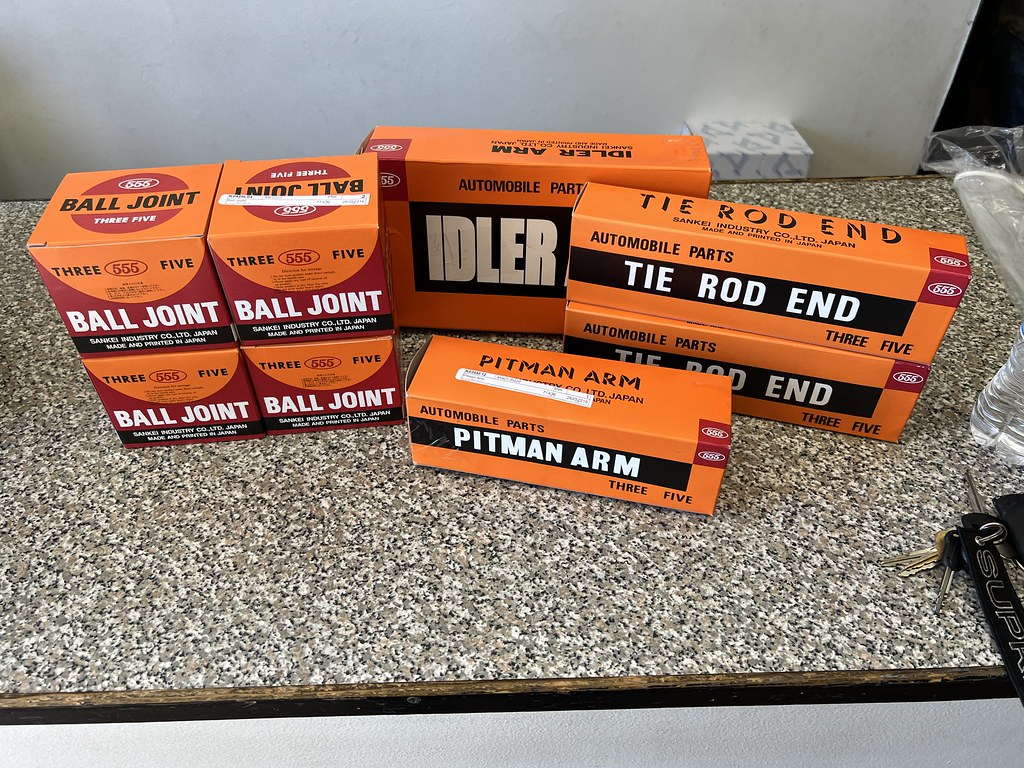

First order is in. Sankei 555 makes really good OEM quality parts.
Upper and Lower ball joints
Inner tie rod ends
Pitman and Idler Arms
My next order will be from RockAuto and it will contain the outer tie rod ends as well as a variety of other miscellaneous components, such as brakes, wheel bearings, shocks, spark plugs, wires, cap & rotor, and much more.

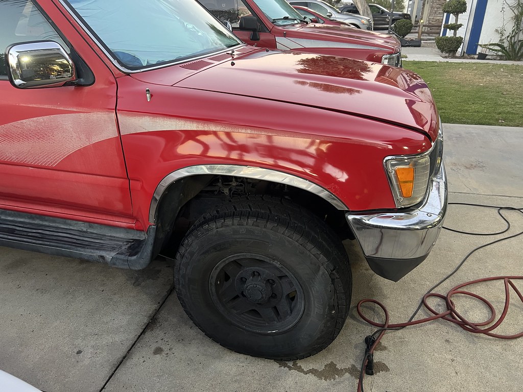

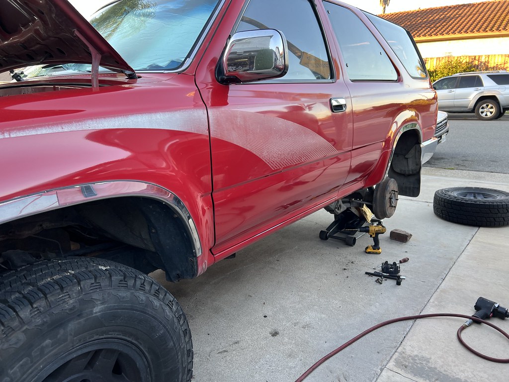

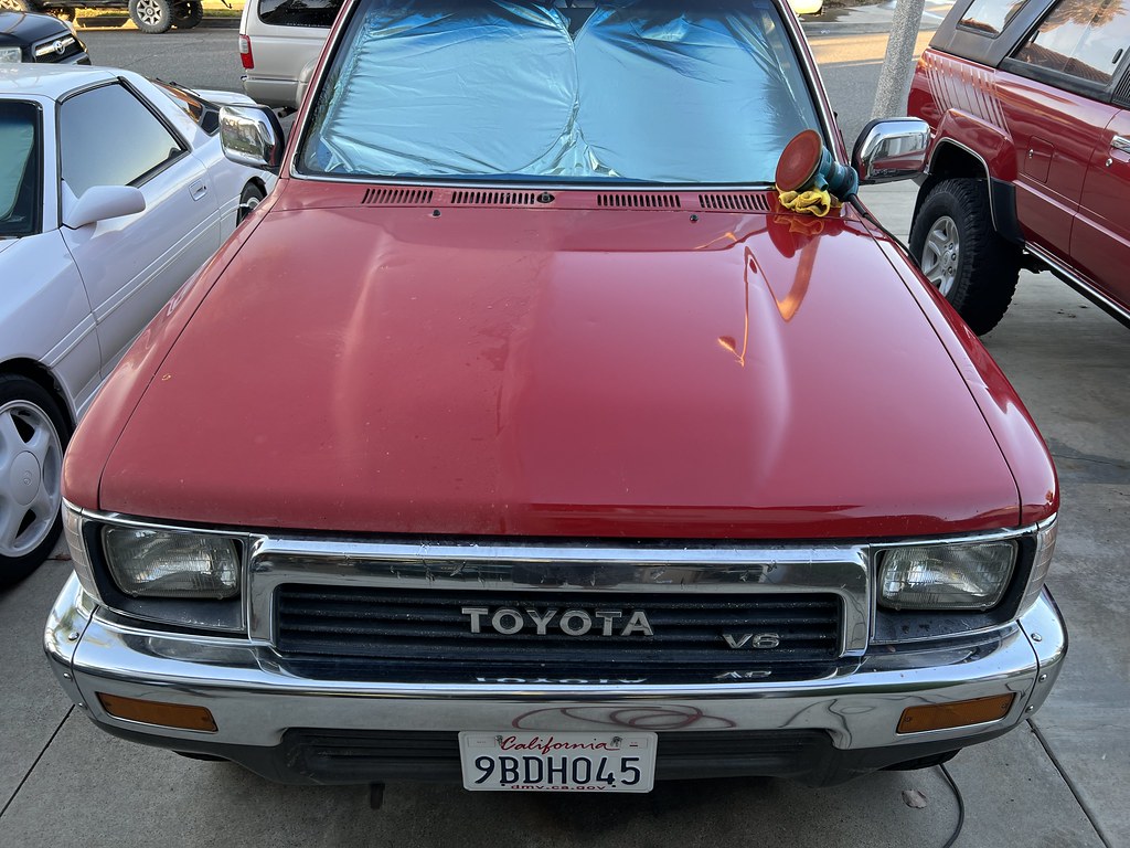

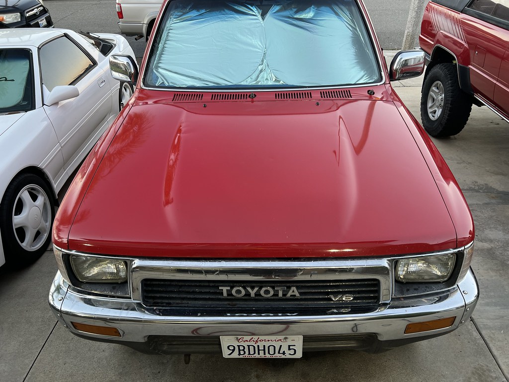

Lets see what we can do about this color. Test run!
The shitty chrome flares are coming off also, to be replaced with the OEM chrome trim from the white 95.

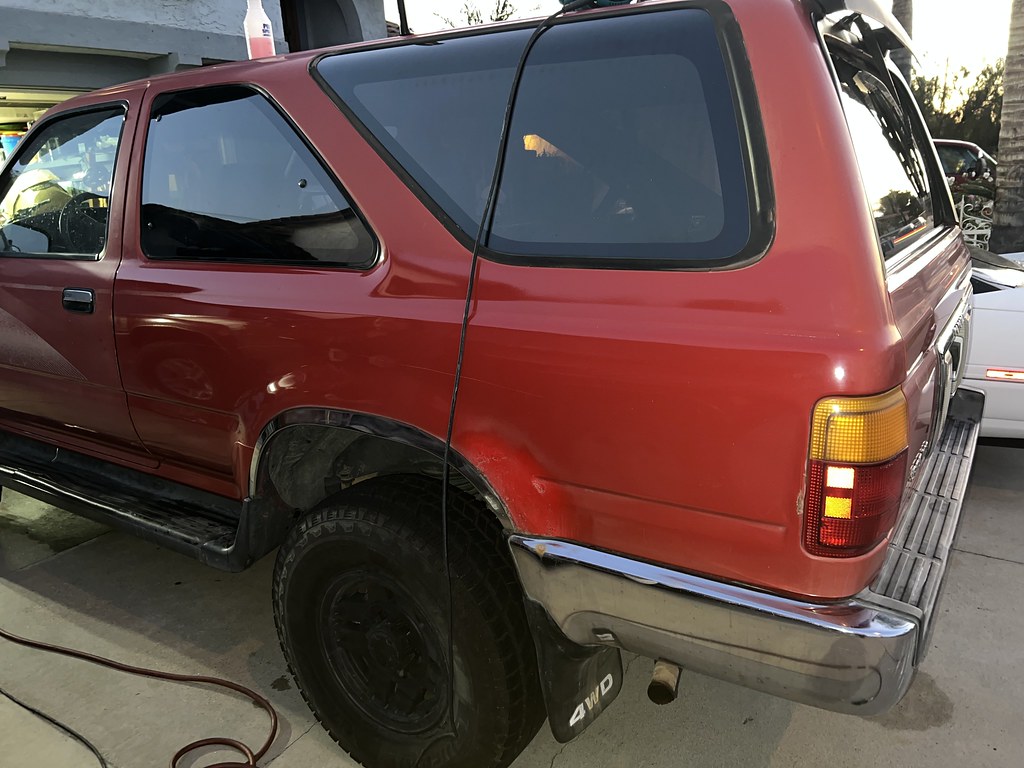

I am using a Makita electric DA with a 5" Meguiar's yellow pad. Doing a lighter cut with level 4 Meguiar's Ultra finishing polish.
Before and After
Left side mostly done
Hood halfway
Hood and cowl done
Right fender
It's already shaping up to be quite nice, there is still more polishing to do on the right side, rear, and top of the vehicle. I also have to remove the chrome trim and running boards to get the remaining hidden spots.

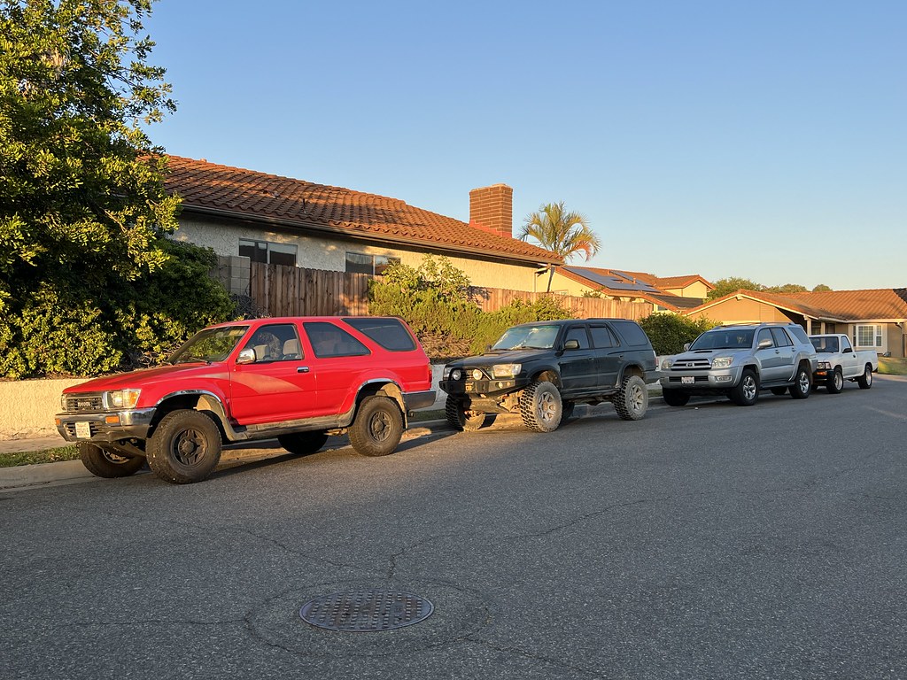

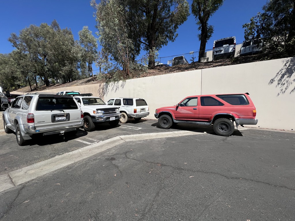

And yes, we have every gen now

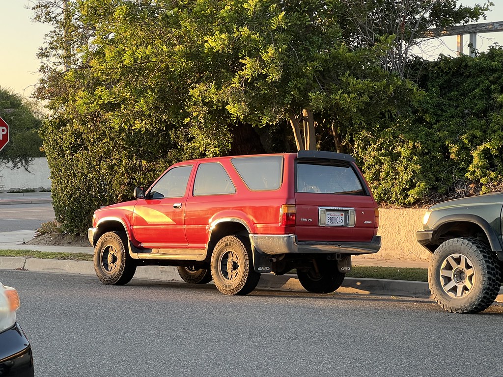

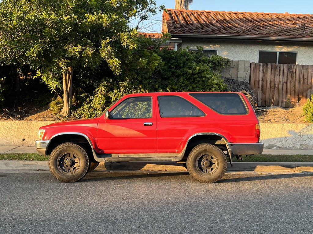

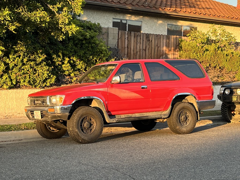

Letting the red shine, haven't gotten around to finishing the polishing on the passenger side yet.
The trim needs to come off to get to those hard to reach areas.
Going to wax the whole thing afterward.
There's potential here, let's get on it.

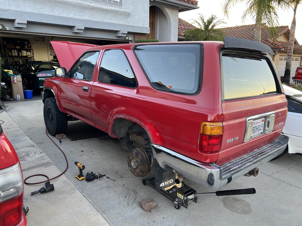

Running boards are no more!
Getting a closer look.

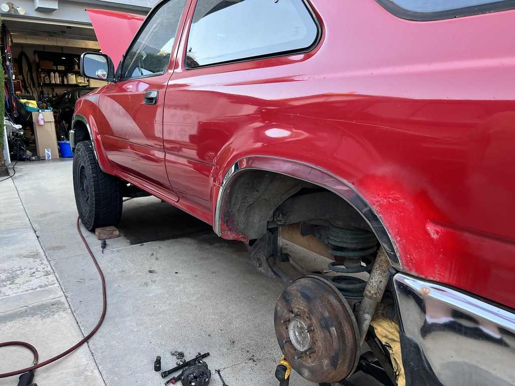

Whoever painted the original wheels did so on the vehicle, so there was a black pattern of spray paint on the brake drums.

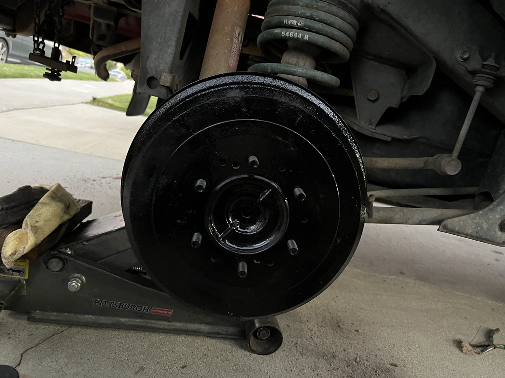

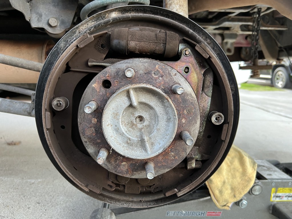

Quick peek at the drums. The shoes have some wear, but they're not in desperate need of replacement yet. Good enough to run them for now and get to the brakes later on.
A quick shot of black on the drums.
Chrome trim off. Some dirt beneath, and some rust hiding. Going to think about what the best course of action is here. First will clay and polish and see how it looks bare. Then, some eastwood rust encapsulator to prevent further degradation.

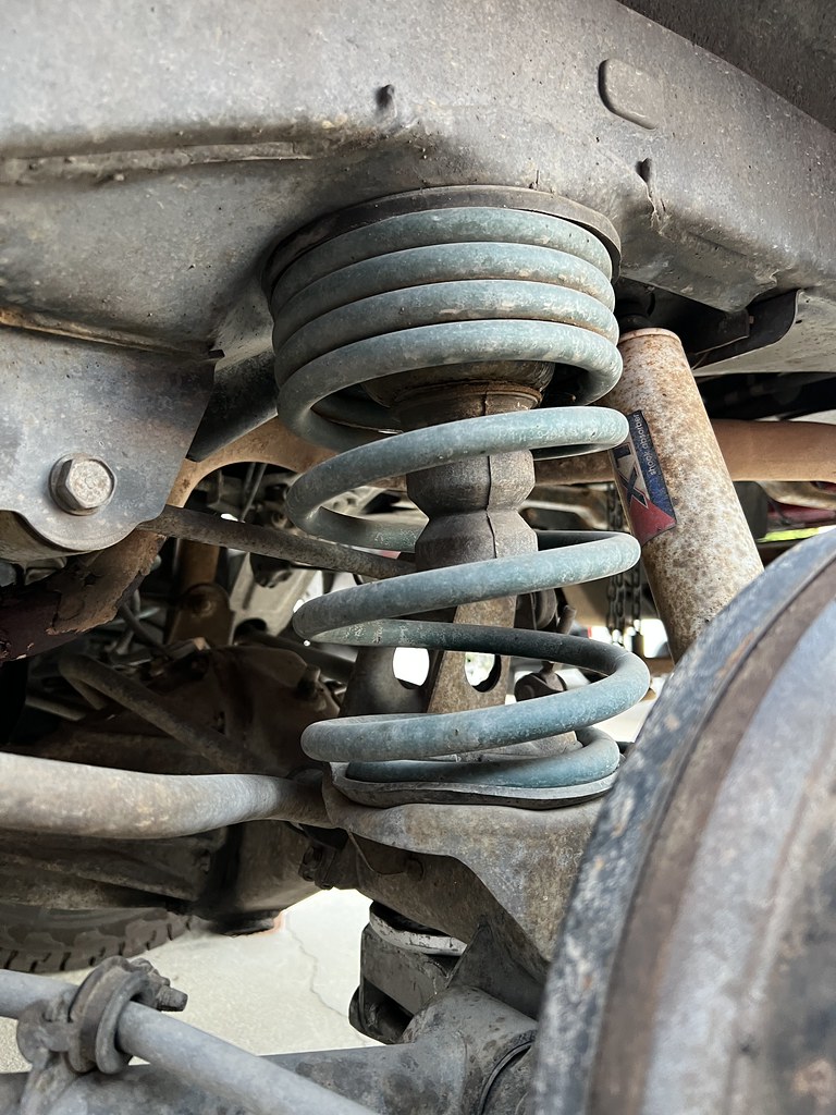

Another view of the H&R springs.

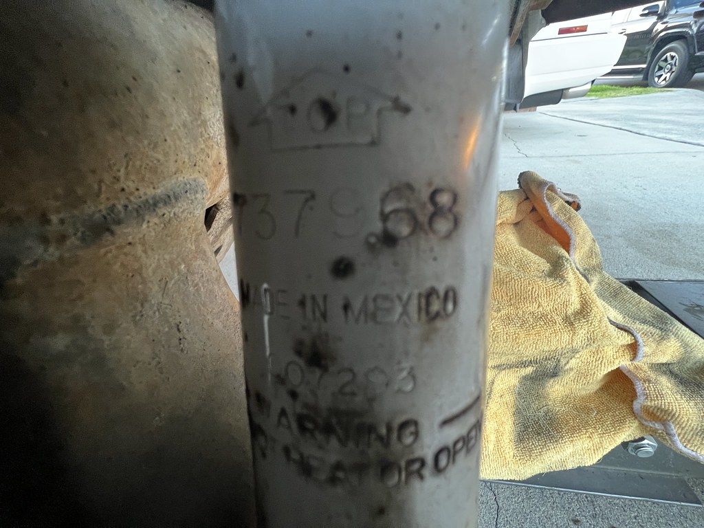

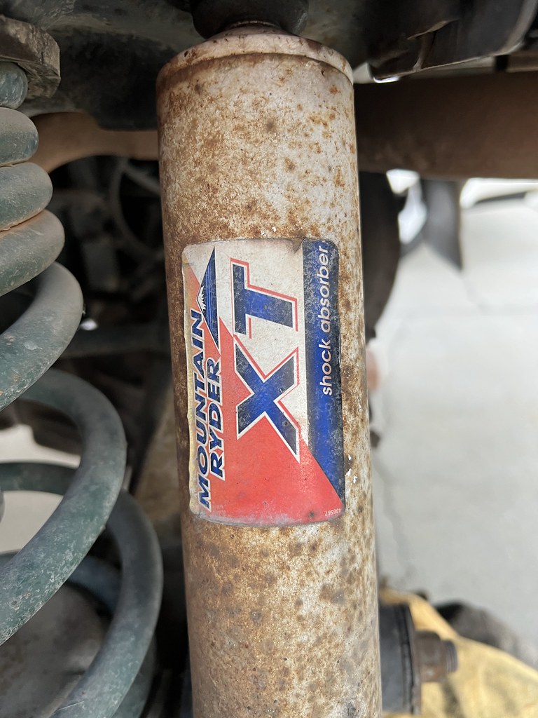

The shocks are some Les Schwab brand "Mountain Ryder XT". They seem fine, no leaks or anything, probably need to pull them off to test them and see if they're actually doing anything. If they're not blown, I'll give them a coating of black paint and a set of poly bushings.

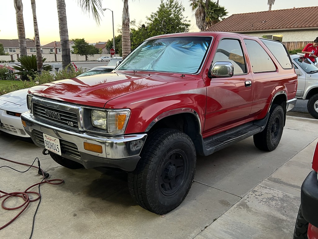

Test fit of 2011 4Runner wheels, 17" with 265/70/17.
Comparison with the unpolished side...
I really like the look compared to the stock 15" wheels. Never liked flat black on wheels either, I think they cheapen the look. These have a nice machined looking finish with a clear coat.
Fronts on, no caps for now to clear hubs. Might do a 33" tire later on and at that point may consider spacers and reinstalling the front center caps. ADD hubs will stay, manual hubs suck to be frank.
It's starting to look more like it should. That chrome fender trim was pretty ugly. I might still use them, but painted black. Might give it a kind of 3rd gen SR5 skinny flare look. Needs front mudflaps ASAP

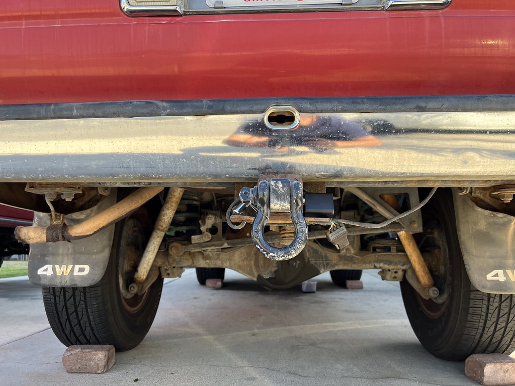

Found this D-ring shackle hitch mount on the trail, popped it in for the hell of it. The receiver is a bit rusty, I have another hitch receiver that is rust free. Planning to swap them, thinking of painting it with SEM trim black before installing.

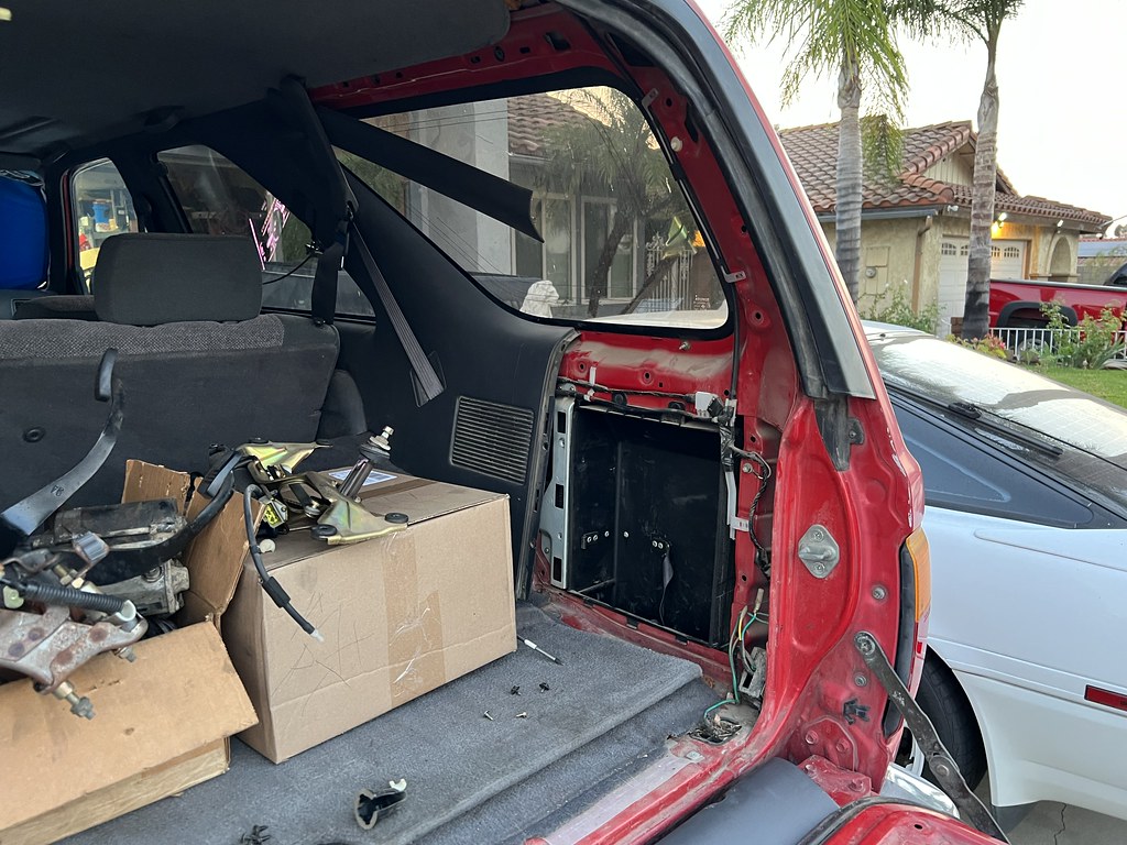

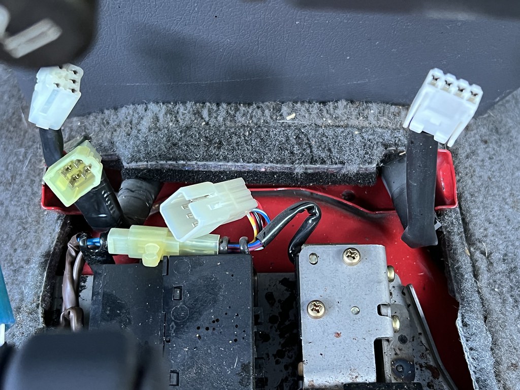

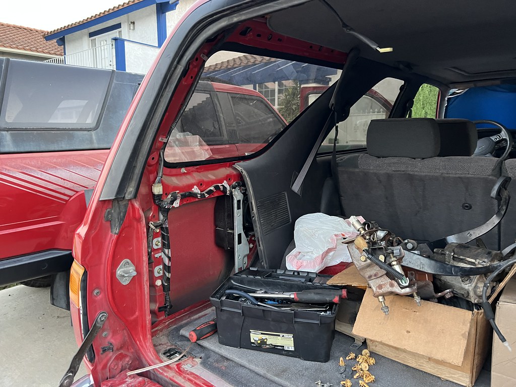

There's been some issues in the cargo area. The key doesn't operate the window. I pulled the door apart and the switch seems to be in fine shape. Next I will test the relay box on the left side to make sure it's working properly.
Love how the 2-doors have a half cargo panel. So much easier than dealing with the giant panels in the 4-doors.

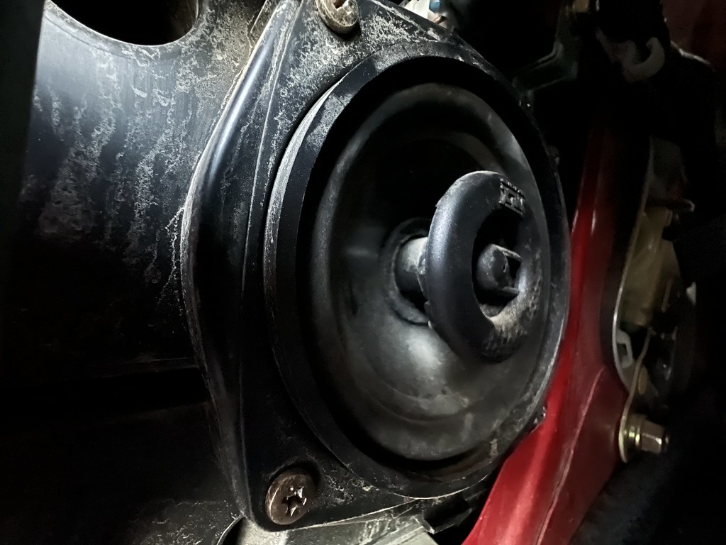

The speakers in the rear appear to be MTX Audio. The left was working fine, the right one wasn't. The right one came back to functionality after unplugging and reinserting the plug into the OEM box.
They honestly sound pretty terrible so I'm planning to order 4 Rockford Fosgate 4" speakers for the whole rig. Cheap and easy.

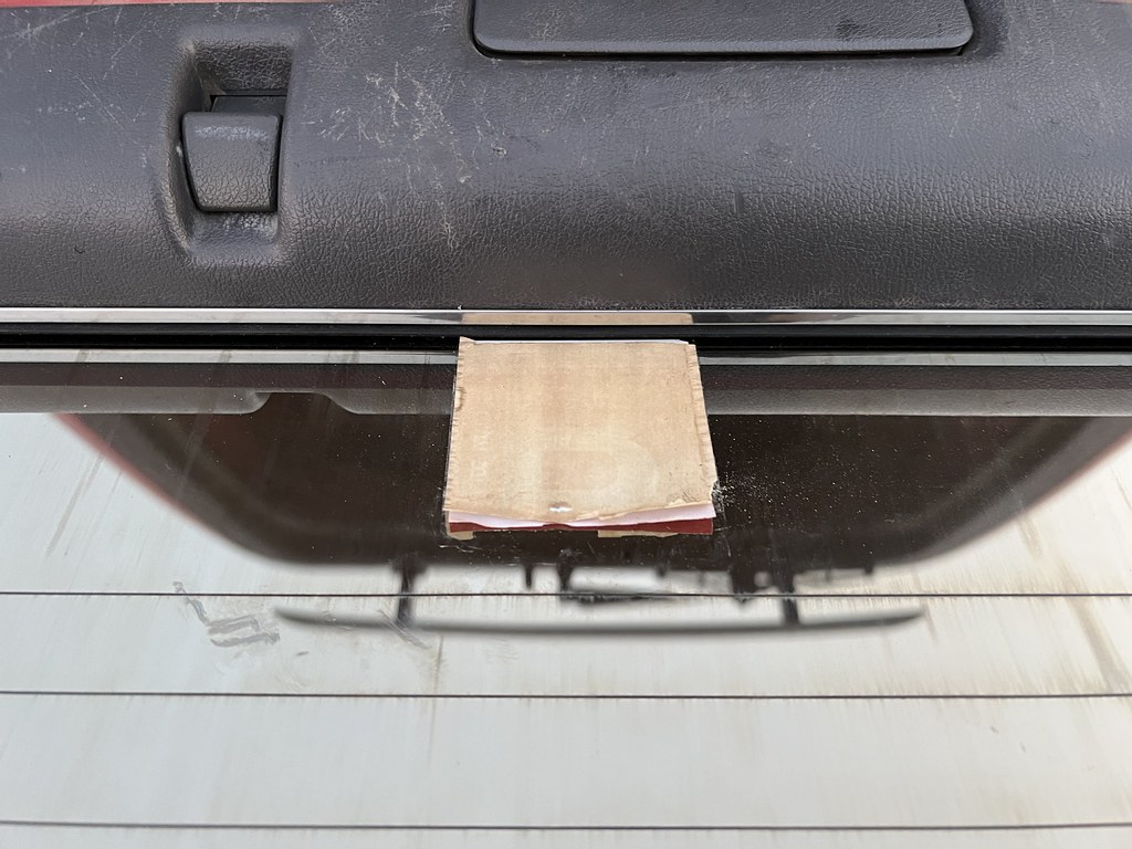

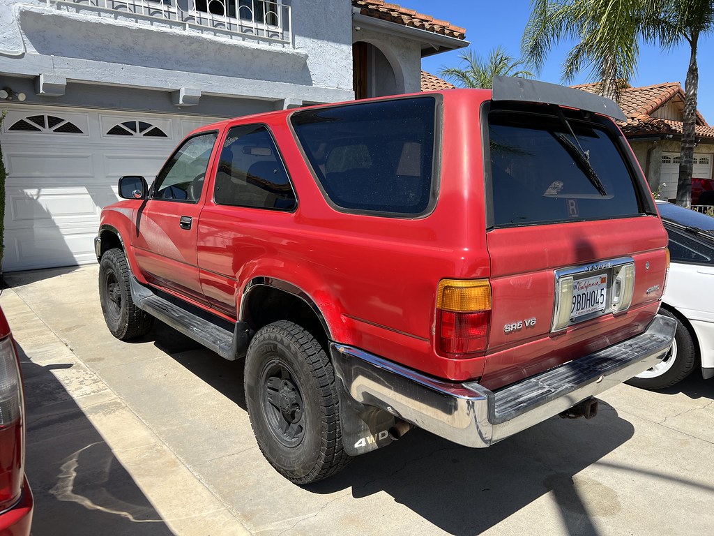

Removed a parking permit sticker from the rear window. Had to roll out the window while the tailgate was down.

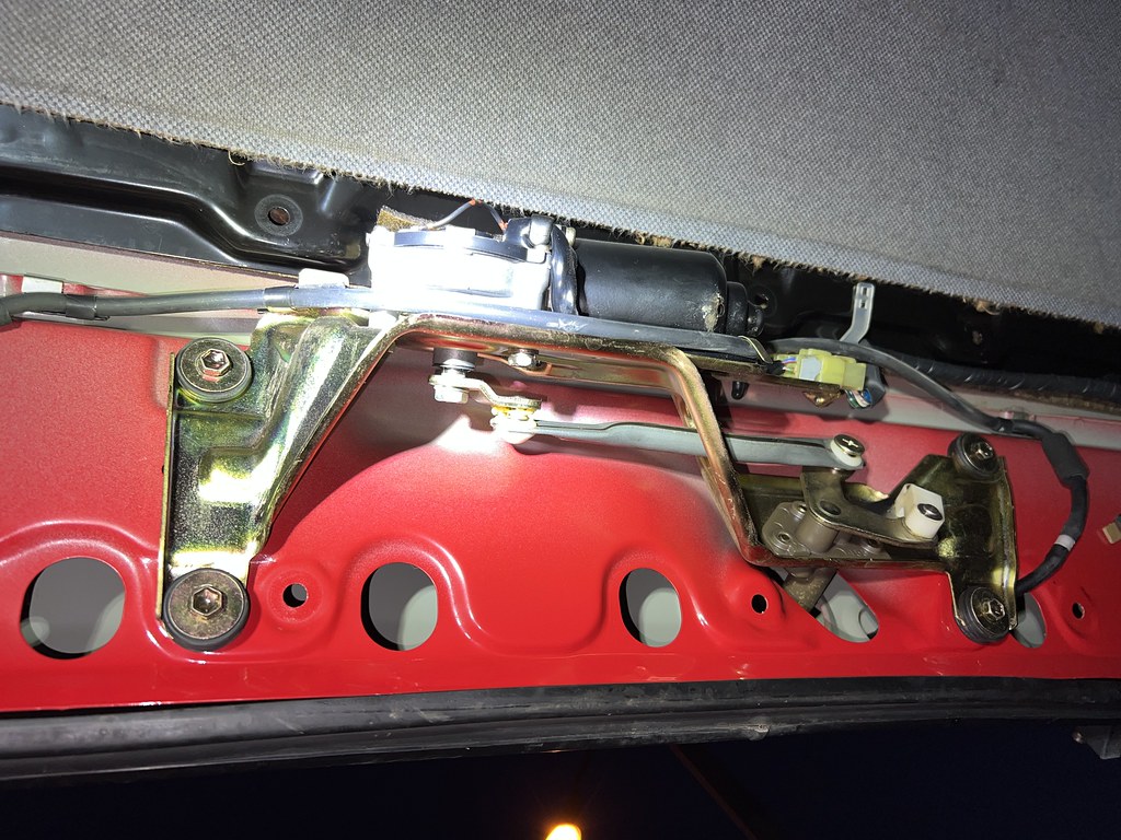

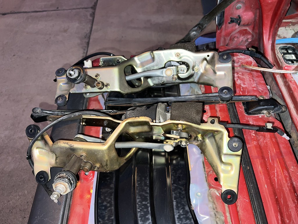

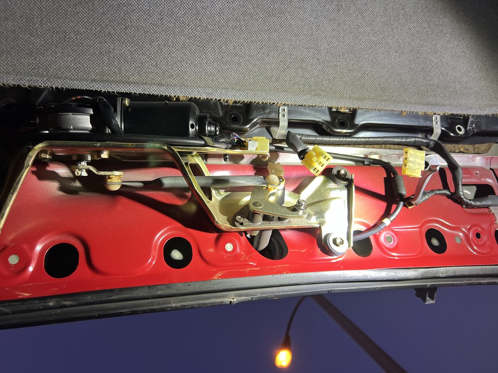

Next was the wiper motor in the rear. Old one had broken the white plastic arm. Apparently this is a common failure point.
Donor wiper motor with good plastic arm, front:
Installed and tested functional. Love to see the wiper pop upward into place now instead of sagging downward onto the window unceremoniously.

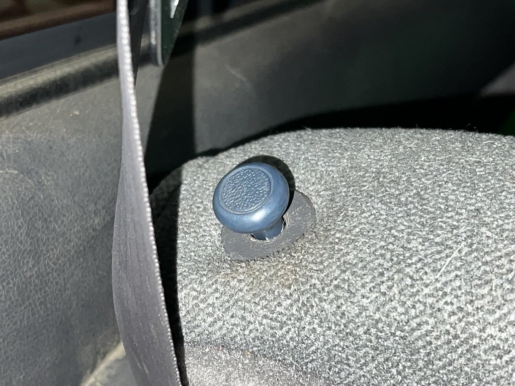

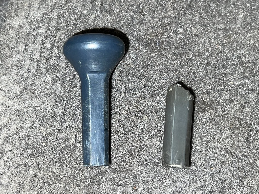

Rear left seat back knob was broken off. I don't have a gray one, but I did have a blue one. Gets the job done for now until I can get a gray one from the scrapyard.

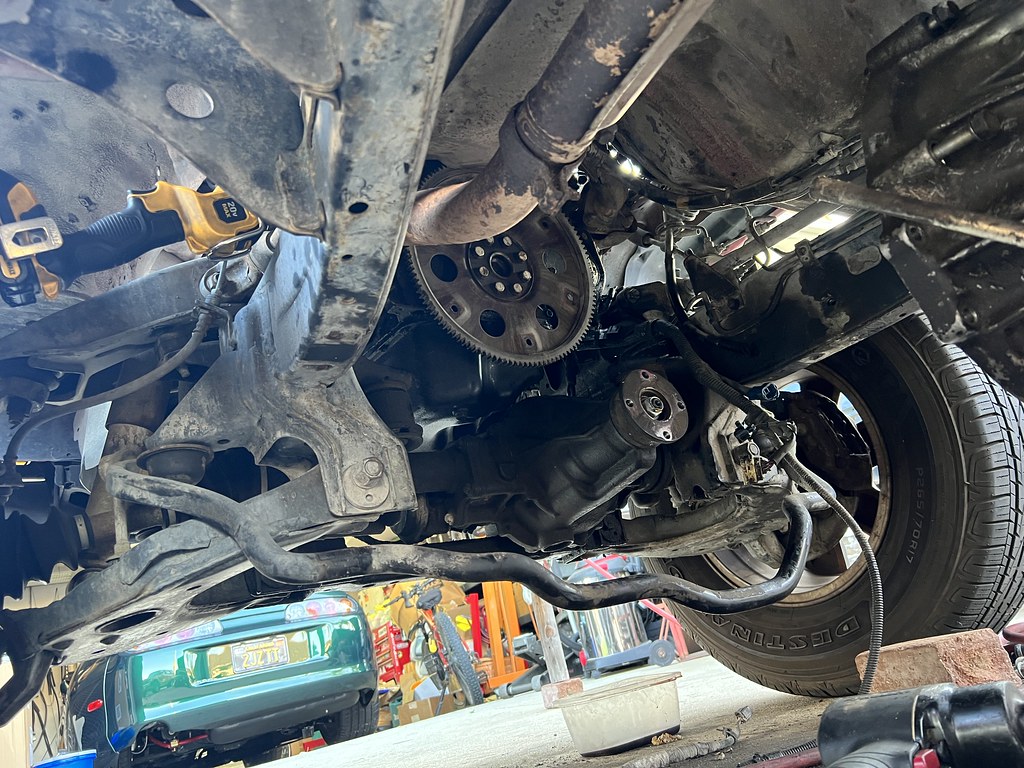

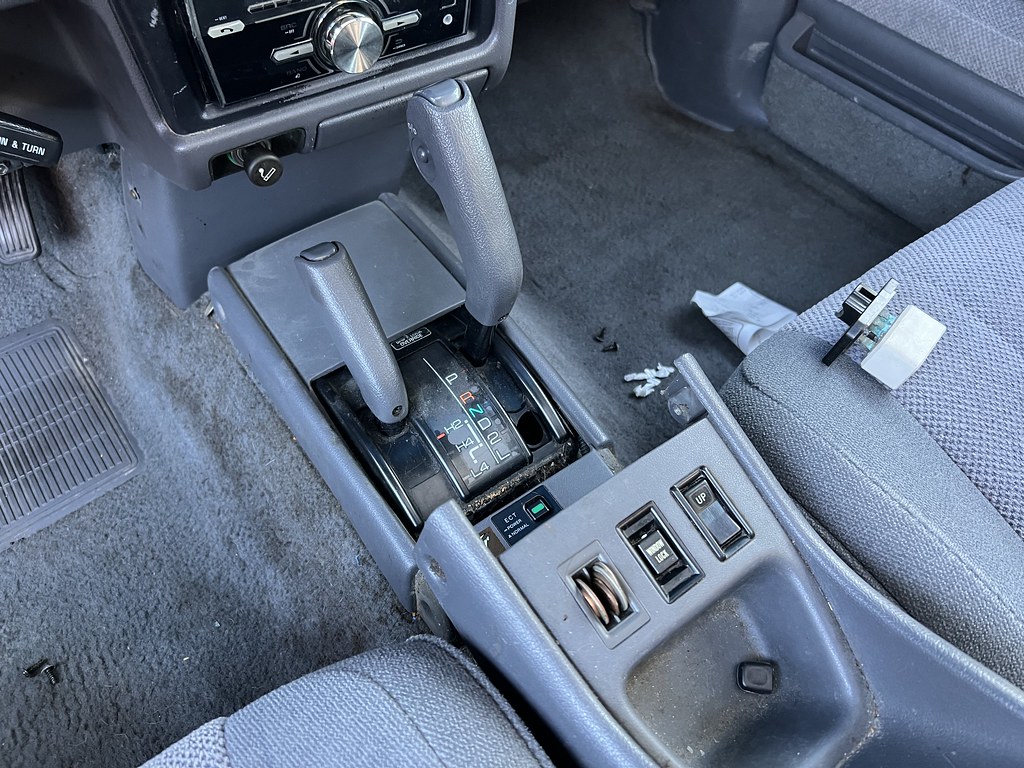

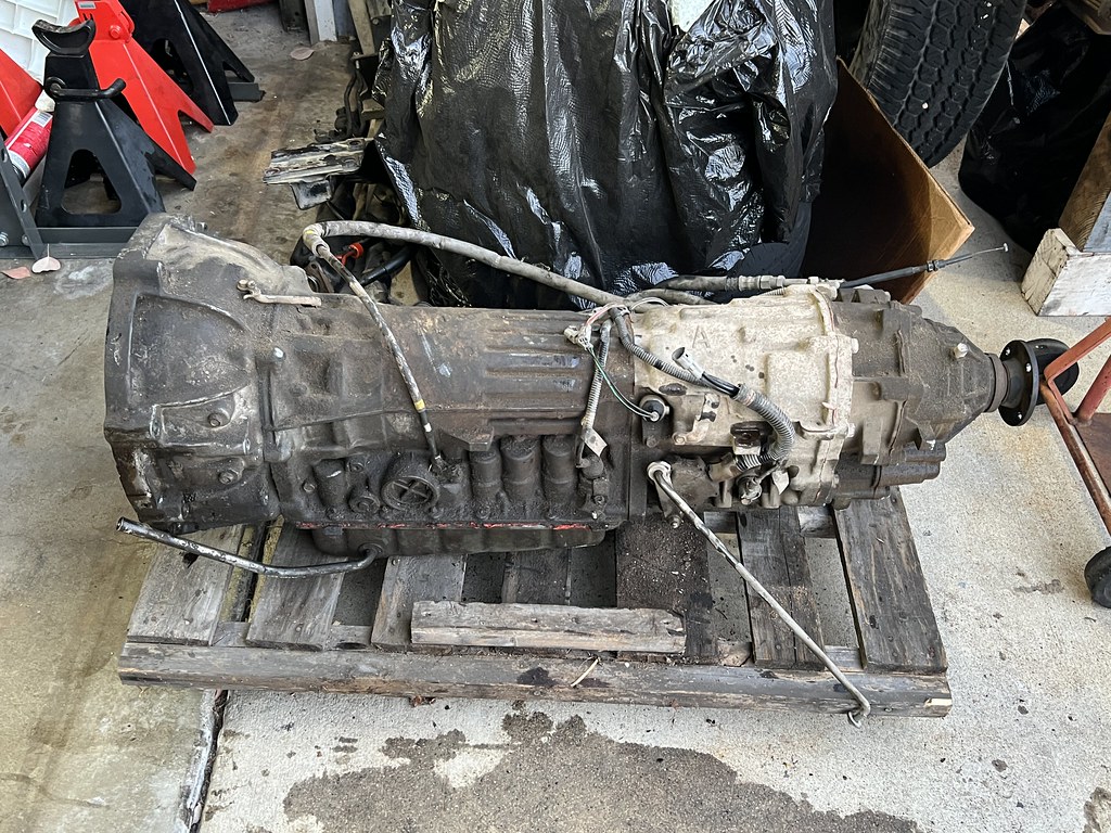

Wasting no time with this automatic transmission. Works fine, but just a mediocre driving experience. It'll be going into a 1995 Limited owned by a local 2nd gen guy.

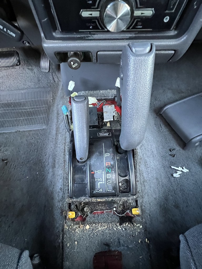

Removing the auto shifter trim has always been one of the more disgusting experiences of an interior cleaning. Years of coffee and liquid spills, various nastiness...

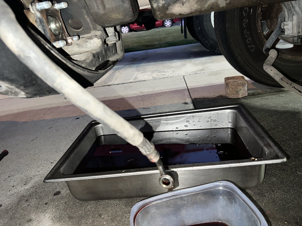

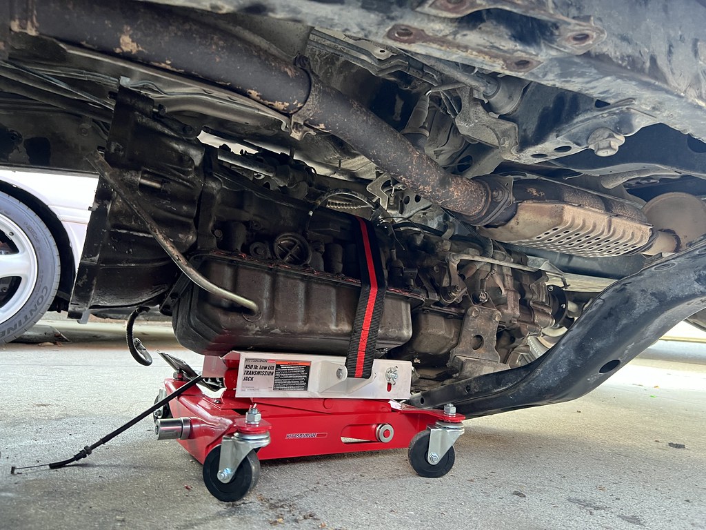

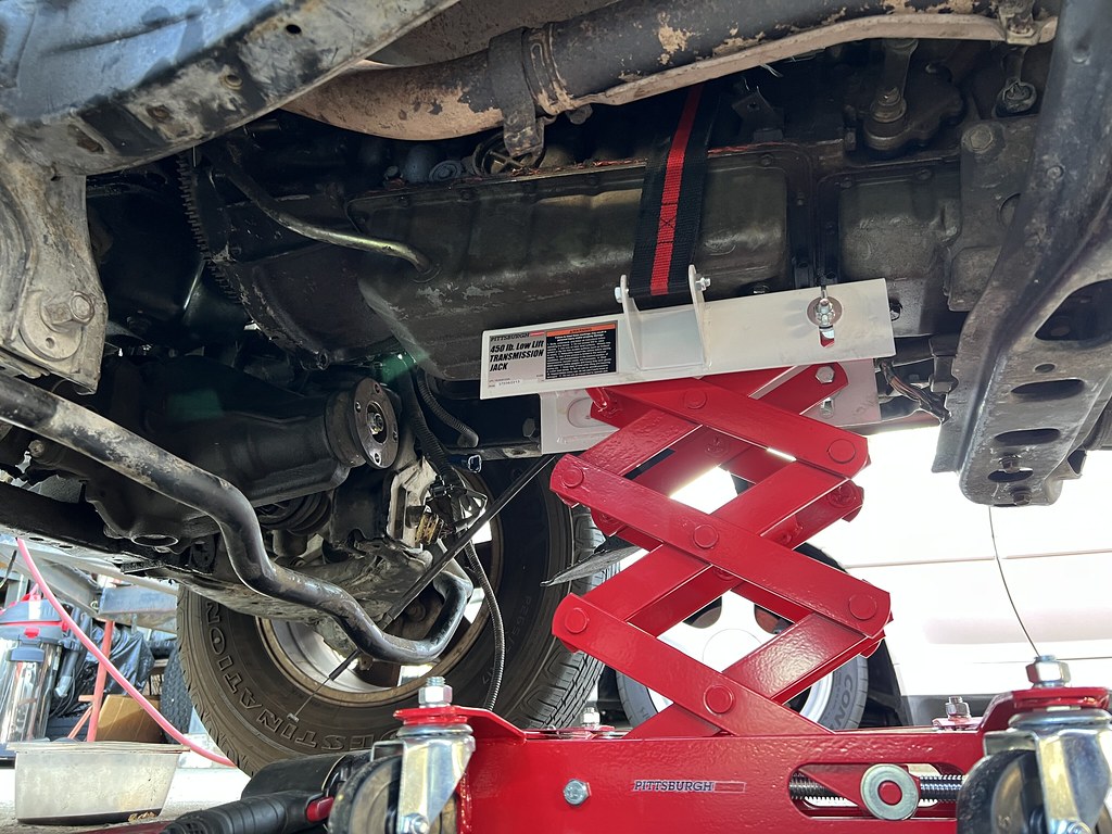

Pulled the shifter out, both driveshafts, and then drained both the transmission pan and transfer case. Speedo cable, dipstick, and vibration dampener removed.
Pulled the bolts out of the torque converter, bell housing, exhaust bracket, and let the starter drop back a few inches.
Dropped the sway bar down, pulled the front skid and fished the transmission cooler lines out, unbolted the cooler, and fished out the kickdown cable.
Harbor freight transmission jack for the win, worth every penny and then some.
Jacked up the front to clear the height of the transmission jack with transmission attached.
