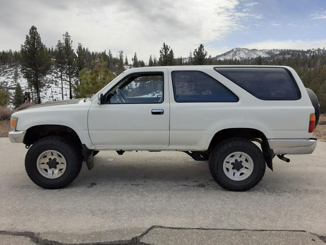

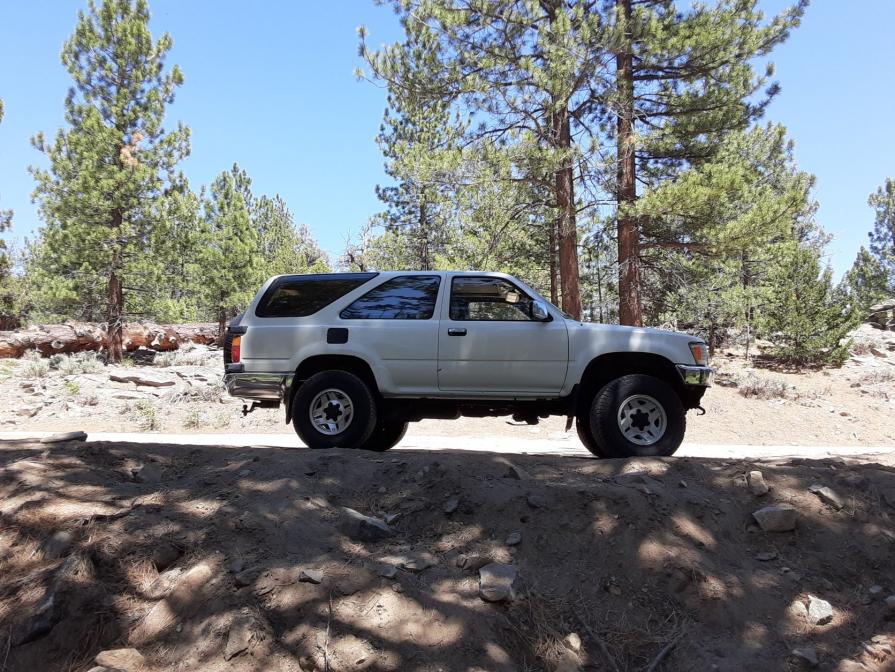

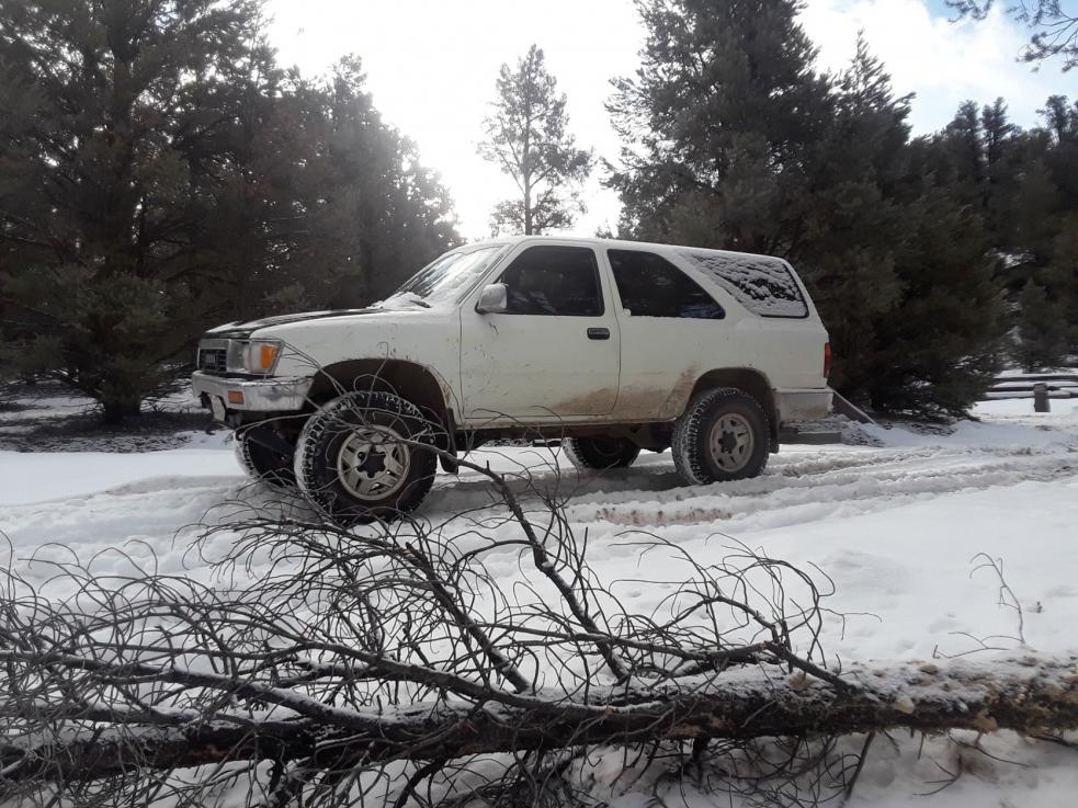

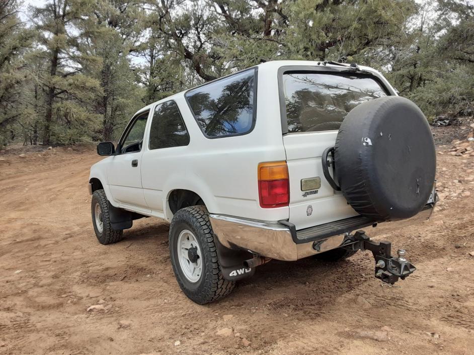

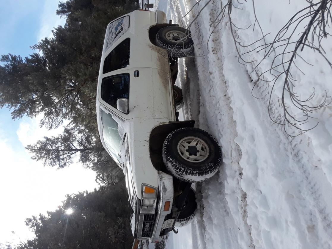

Hey COB. I am uploading pics of my Gen 2, 2 Door. I read that you're collecting pics. My gal is a 1990 (built in Japan, in July of '89). I believe I'm the 4th owner. She has had some front end damage. Don't know if her motor was replaced. She has 523K on the clock, although the odom only shows 325K. The odom was replaced by the previous owner, as it was broken. I had the clutch replaced @ a Toyota stealership in '18. She was my daily driver for two years, without a single issue. She now own's our family garage. I drive her on occasion (once a week) and on ALL camping trips. Wife hates the fact, that I call her a "truck". I always ask, "What has 2 doors and a tailgate?", a TRUCK!
Kennedy Meadows,CA
Patches
Bitter Creek, CA
Fish Creek, CA
