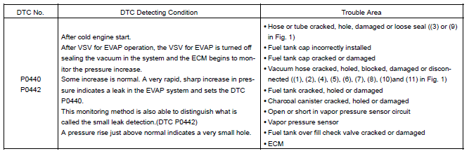

Finally got the code number of P0442. It lists the following possibilities - defective fuel cap, EVAP cannister, purge or vent solenoid defective, vacuum leak at engine.
Any ideas which one? What do I look at first? I have an 02 limited. Will it hurt the vehicle if I continue driving it?
from the FSM as you stated some of the possible causes. I have the same code, could be a long list of things. Will not hurt the vehicle. could lose fuel mileage and be rough running.
