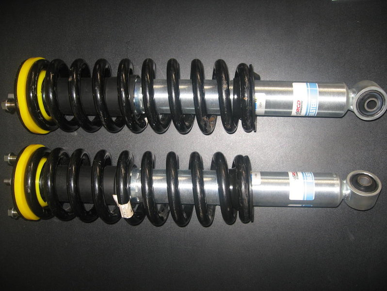

Been having some noises on turns going over curbs. Initially thought might be my polys on the LCA. As I had time off today, found one of the isolators cut through from the end of the coil rap. It's not cracked or deteraited.
Through my search, found a 2013 member 12 post count used a energy suspension # 9.6104. No others come up in search other than older gens.
Was wondering if anyone else have used any poly ones. And if so, do they have enough pliability to shape around the coil?
same question
I was considering using these for a mild front lift but they are advertised as being for the rear? Can they be used in place of the rubber coil isolator up front?
On my Tacoma I used OME Jeep JK 10mm spacer in place of the rubber isolator and it worked fine. Just wondering if I can do the same with these Energy Suspension 9.6104G

I did buy them with that number, not sure about the letter after it.
I ended up buying through amazon after googling the part # and they had a chart on another company with the inside/outside diameters listed in the other thread. Mine are black though.
I would say it probably gave me +/- .25" lift using over rubber ones.
Not compressing/flatting out like rubber. I can't tell now as how much they settled due to compressing they are doing. I had to go back in and rotate my spring on 1 side due to slight contact with UCA. So my coil end is now hidden in the back side.
