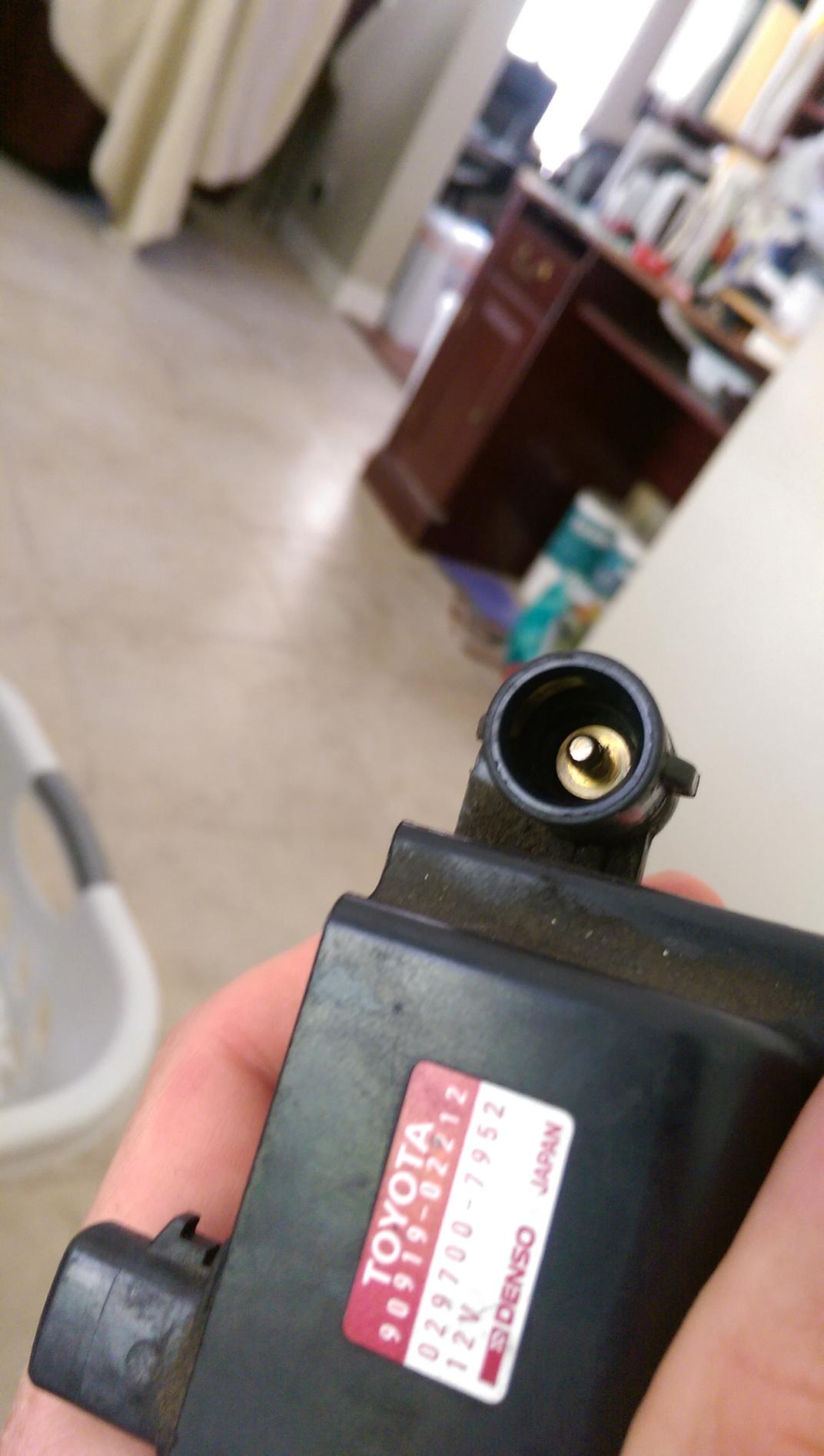

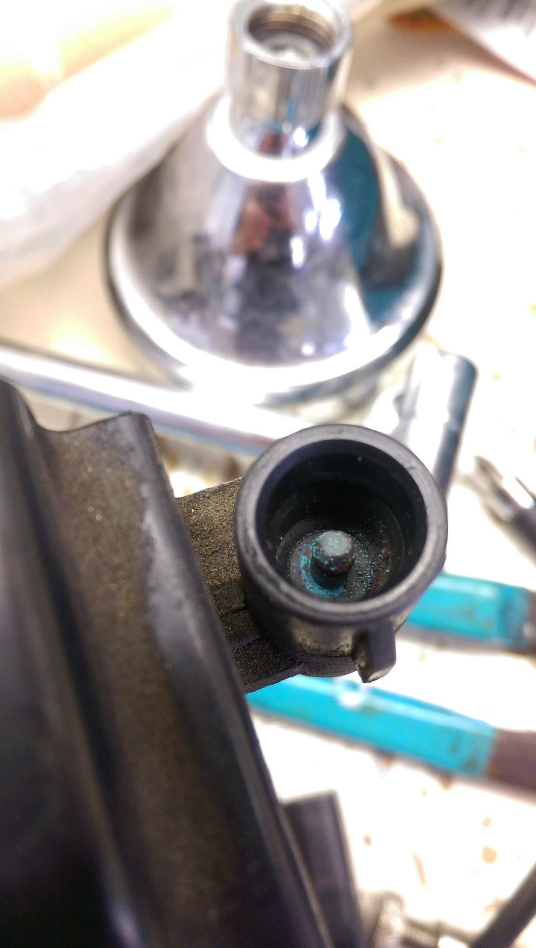

I pulled the coil packs to find two of them looking like the pictures provided, and one of the wires that plugs into the pack looked the same way. Does this look like it could be a possibility to the symptoms I'm experiencing? I suspect it does, but figured I'd post on here first to see what kind of things you all have had luck with.
