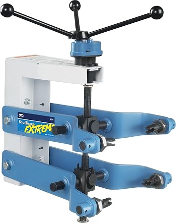

I have one of these. Works great.

Why do the spring compressors not work on CO?
I thought I'd be able to use one of these to compress the spring, rotate and remove the lower collar, then the spring comes right off. But I haven't tried yet.
