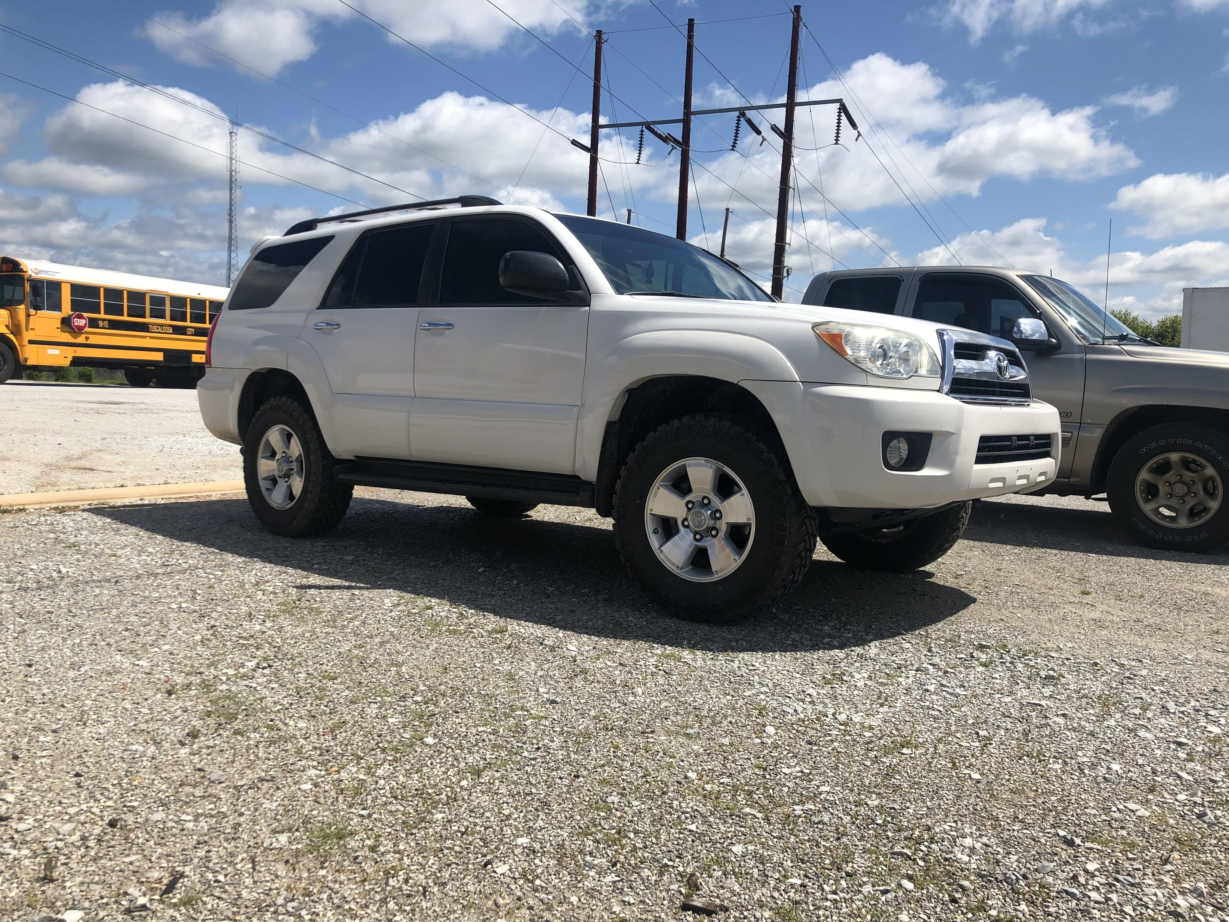

I guess it varies, but in my case I had to get UCAs to correct my caster and I’m only leveled with 2.5”

So what sort of lift would you recommend with my miles?
You squattin' son.
No sir, I don’t like that look. I’m getting T12 springs here soon to help with towing
