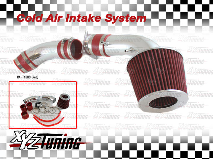

Has anyone ever installed a cold air intake on an 89 3VZE?
Here is the one that I found on ebay for about $40 after shipping?
Just wanted to see people's thoughts, reviews, and common problems. I was thinking this might help the 3.SLOW a little bit.
Thanks for your help.

I have a 91 3VZE and i was wondering the same thing. For instance what happens with the air flow sensor and its connection?
For the mean time i have replaced the stock air filter with a K&N High Flow filter and INSTANTLY felt a power increase. And i am only half way through the full tank i put in after installing the filter and am already seeing an improvement in economy, driving the same way as i always have.

You take the whole stock air intake off, and put that one in replace of it. You dont need the MAF sensor if the intakes open. And cold air intakes increase the air coming into the engine. therefor no need for the MAF

S&B filters makes one but is a bit more expensive but I think better quality.
Everything I have heard is that both the 22RE and 3VZE will not run without the MAF connected.
I may be 100% wrong... Can anyone confirm either way?

the s& b filters will allow you to re attach the maf sensor .....the one the sell on ebay also have a spot to screw them onto, it's just flimsy

That flange at the rear of the piece of pipe connected to the filter is what connects to the Air Flow Sensor.

You're correct. The 3VZE will not run without the MAF connected. I forgot to plug mine back in one afternoon and the truck wouldnt start.

as for the intake, i think its a great mod for the money, i noticed a slight increase on the bottom end power, and a very worthwhile increase between 4300-redline. as far as economy is concerned though, i had very slight to no increase.
one thing to note is that i would really recommend making some custom brackets to hold your MAF in place, i had a problem with it bouncing around and going over large whoops at higher speeds it would actually bounce itself right off the intake.
also i was thinking if you paired this up with a high flowing muffler , and blocked the filter off from the rest of the engine compartment so it is literally taking in 100% fresh cold air... might make for a really nice increase over stock setup! i'm planning on doing this in the next few weeks ad will post back and let you know how it works out.

are you kidding??? do you even know what the MAF does? it controls a flap in the air box. and if you have an open air filter(cold air intake) it doesnt need that sensor. Try taping the flap open in the air box, and unplug the sensor, i bet the truck will run just fine.
ok mr puge... let me put it this way...
i worked for a Porsche race shop for 3 years, i've been tinkering with cars since i was a little kid.. i may be new to off road vehicles and 4runners, but an engine and efi system are all the same... they RELY on what the sensors tell them in order to run! the flap is NOT just a flap! it is a variable potentiometer that sends out a different resistance progressively as it "flaps" open and closed. essentially the more air going through it the farther open it moves and tells the efi to richen the gas mixture because there is more air to combust. with out it the engine sputters for a second and then dies.. TRUST ME! go try it on your truck, it takes 30 seconds to show that it IS needed in order to run.

I have a 91 SR5 Limited 3VZE V6. I just NOW went outside, disconnected the MAF (which is actually a VAF in our trucks) and it started then stalled after 3ish seconds. Reconnected it and it started and ran normally. Disconnected it again and the same, stall after 3-5 seconds.
At risk of witnessing a s**t fight start between you two, how bout Mr. Pughe gets us some pics of his mates intake set-ups, and maybe a description of what was modified to make the engine run without the Air-Flow sensor..
