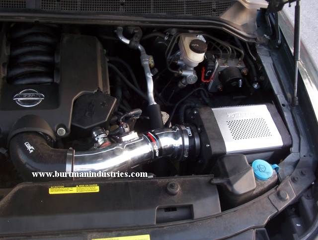

I've sold a crap load of intakes for many cars/trucks, and the one I sell a ton of is for the Nissan Titan. The most power gains on that truck was from metal intake made by Injen, gave 24 hp, but that engine is a monster V8.
