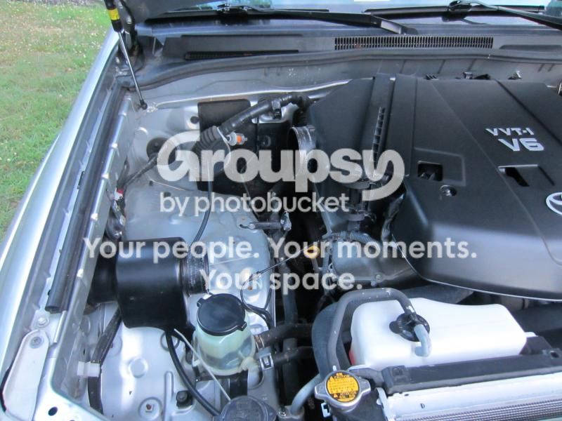

i just took off the intake tube on mine to get a better sound out of the v6.
IMG_1395_zps27966077.jpg~original
Factory Toyota Intake= Free CAI.
If you're just going for an aftermarket CAI for looks/sound/because you have money to blow. Go with a non-oiled filter unlike K&N.
Yup. Using the Torque app, I've discovered that the IAT's are about 3 degrees above ambient with the stock intake. You won't do better than that with an aftermarket CAI
Better sound but you are giving up power and accelerating engine wear...
Because the factory intake draws cooler air from the fender and also has an air filter to filter out dust and debris.
His setup is drawing in warmer, potentially dirty air from the engine compartment. Notice that with the tube removed the opening in the intake is only a foot or so above the exhaust manifold? Not good for power...
