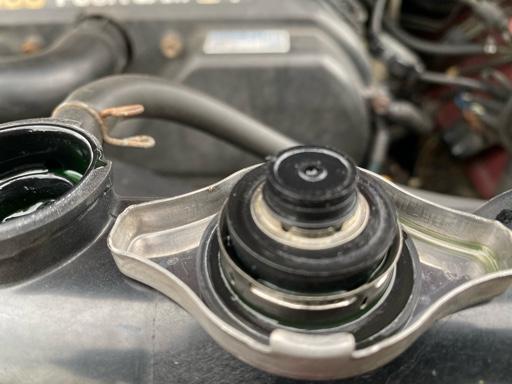

can a rad cap with a 3psi difference make a difference. Reason I ask is I just looked at the rad cap and it says 16psi......yet I have seen in print that we should be running a 13psi cap
wonder if Napa sold me the wrong one, cause i just went to thier site and it also lists 13psi for the yota.
Is there a black center in the bottom of the cap? It needs to be a vented cap.
I can walk out and take a picture of my napa cap. Either the cap is bad or it’s the wrong one or your line or inlet at the tank is plugged with dirt.
Balkamp BK 7031728 13psi/.9bar
I'm not sure what too high a pressure cap would do but you're right that it should be 13psi.
It puts more pressure on the hoses, etc. and may lead to leaks. Otherwise, it is all good - it also increases the temperature at which the cooling system will boil, which helps keep the motor safe when pushed hard.
