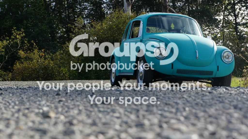

lol my daily driver right now is a 1973 super beetle (photo below) :P im buying a 4runner because theyre bad ass and ive always loved them. I don't care too much about mpg I was simply curious. I looked at another 4runner today-had it listed for 3,000 and his wife said shed sell it for 2,000 if I bought it this weekend and it has 259,000kms and the head gasket was done 90,000kms ago. its a limited as well- and im considering buying it due to the price and I could lift it and throw some 33's on it with what id save buying a 1999+ as they are priced around 4500-7,000 here :tsk:
