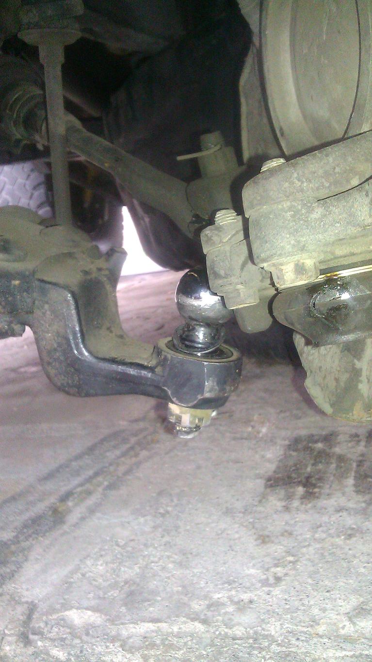

SO I had planned on doing a SAS and 4WD conversion once I had all the pieces. I don't have everything I need yet, but I have started on the conversion. and due to lower ball joint failure is why I started the conversion. why spend money on alot of ifs parts when I can just dump it into the conversion.

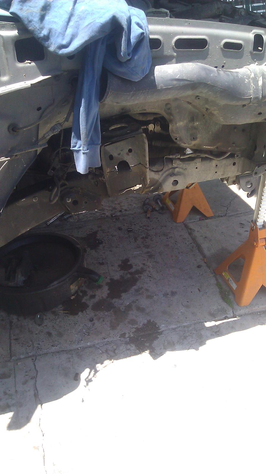

In day one I started stripping everything down. took out all of the ifs system. cut the crossmembers out and dropped the transmission. I do wish I had taken more pictures. I'm going to try and put them in order. from the moment of lower ball joint failure and as I work through this conversion.
Picture one; my roomate(white shirt) took the car up the street where he called me because something was wrong with the 4runner. when I came up, this is what I saw.

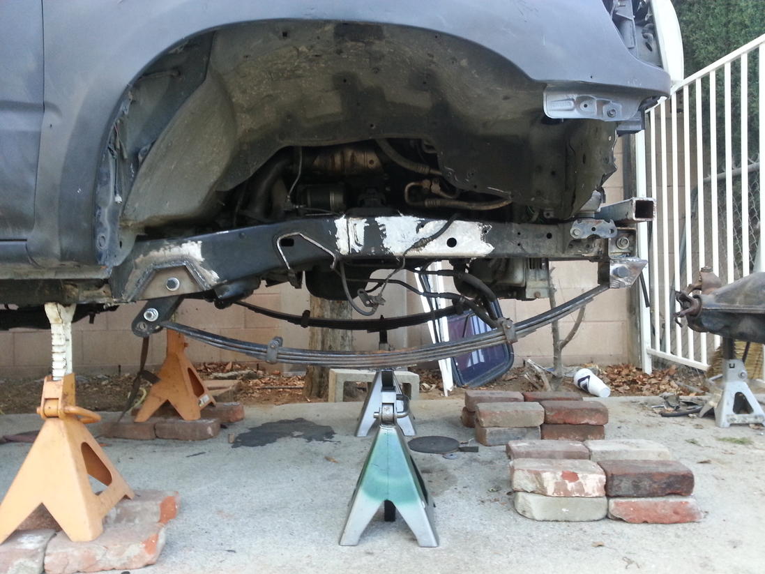

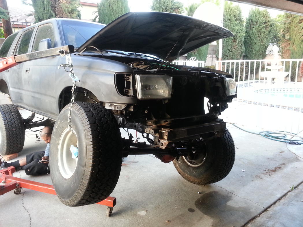

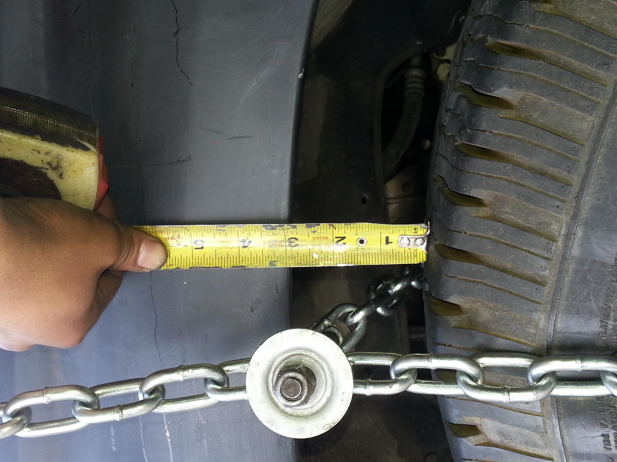

Its been a while. Haha. I left the state soon after I started working on it. I just moved back and have a fire underneath me to finish my baby. I've been back a month and have it almost together. I'm fine tuni g the front end and finishing off the welding right now. My aim is to get it as low as possible. To my measurements right now are going to put the front end to 23 1/2from under the doors. I ordered the sky mfg french shackle hangar with off set shackles and didn't end up using the hangars because I didn't need them. And I fabricated my own front crossmemeber to sit flush with the frame. Also for the rear axle I plan on going spring under. For the stability lower cog. I also plan on running the bilsteins 5125s. 14 travel for the front 10 travel for the back. After I finish fine tuning cycling the suspension next is to mount those bad boys.

The thing I can't figure out is how you are able to move the thing around once you have the wheels and ifs all cut off. From the pictures it looks like it is in a few different positions. Do you just use multiple floor jacks or is there another trick?

Haha. It actually had to be moved from where I had it before. That was a pita. Its still a pita. I have the wheels under it so I can push it around my driveway to get it out of my family's way when they wanna park their cars in the garage. So now its good ol fashioned elbow grease.

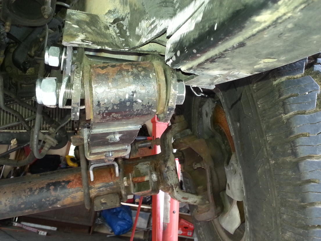

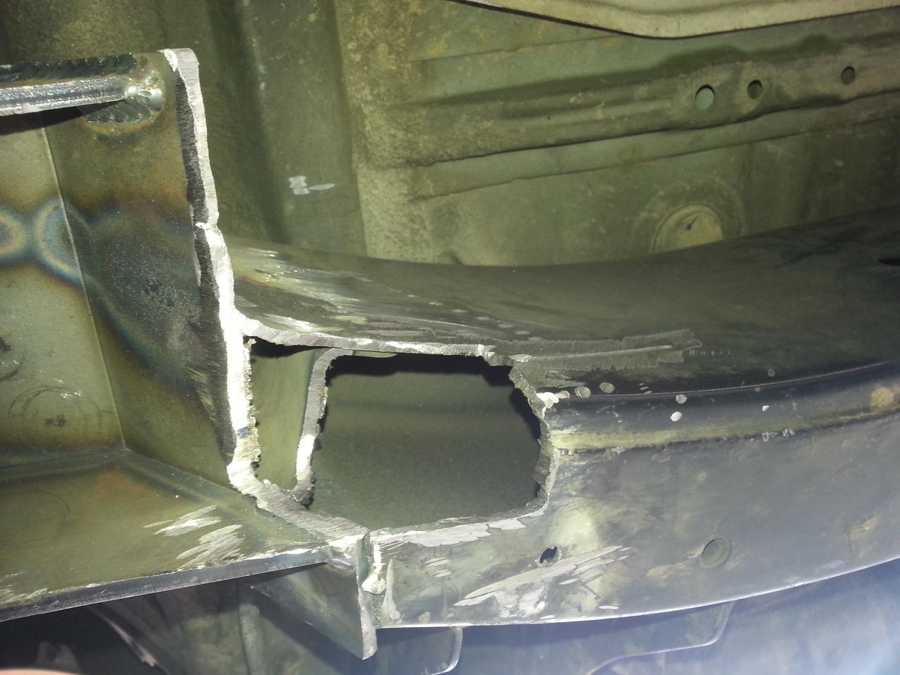

Trying to get these shackles to fit at full stuff. Almost there. I do plan on plating and gusseting the whole area including the hangar boxs. I thnk you'll like what I come up with.
