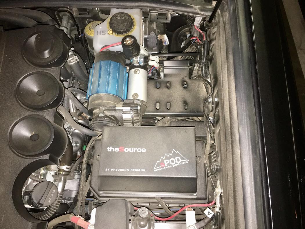

Mount a single ARB on a Slee mount on the driver's side. That would allow you to get your dual battery setup and have a reliable compressor underhood.
Slee - Compressed Air Products
