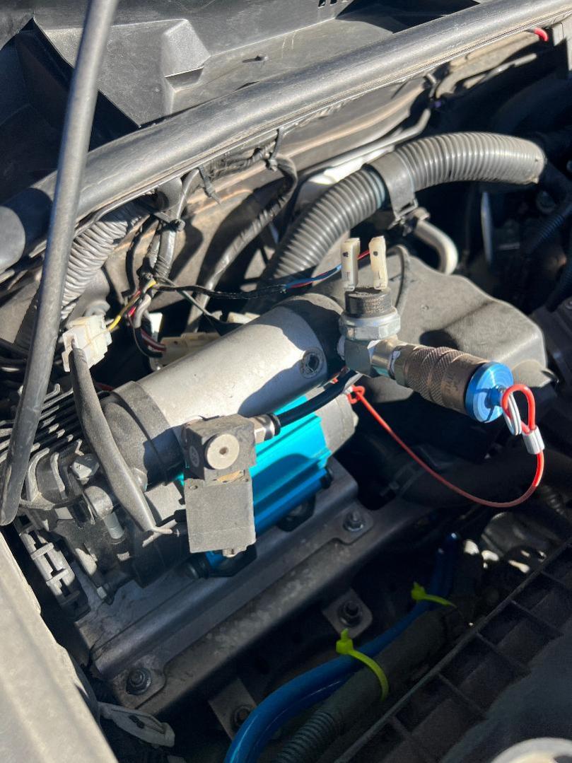

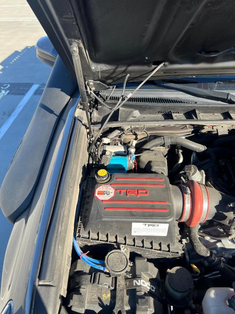

I also wanted to add, that it is tempting to install it on the driver side behind the battery, and next to an accessory panel. I did this previously and it was a wiring mess and difficult to do any kind of maintenance in that area (adding lights and accessories) because the accessory tray, compressor, wiring harness, made it difficult to re-route wires.
What i ended up doing was move the compressor behind my air intake, and left the accessory panel behind the OEM battery location. Way happier doing it this way. I can add accessories without having to disassemble everything, and lots of room around the compressor to let it cool down.
Anyways, here are some pics of the shrockworks mount and a bunch of add on accessories for the compressor:
0: vacuum pump relocation kit (next to compressor)
1. locker actuator.
2. Wits end pacifier and safety wire.
3. quick disconnect brass chuck.
4. battery box in front of intake
cheers!!!
1. locker actuator.
cheers!!!
yeah I was out on the weekend measuring stuff. Im gonna go with behind air intake as well. Lots of room. To bad about Shrockworks, I have some of their stuff already.
Thanks for the pics!!! They help a ton!:tea:
