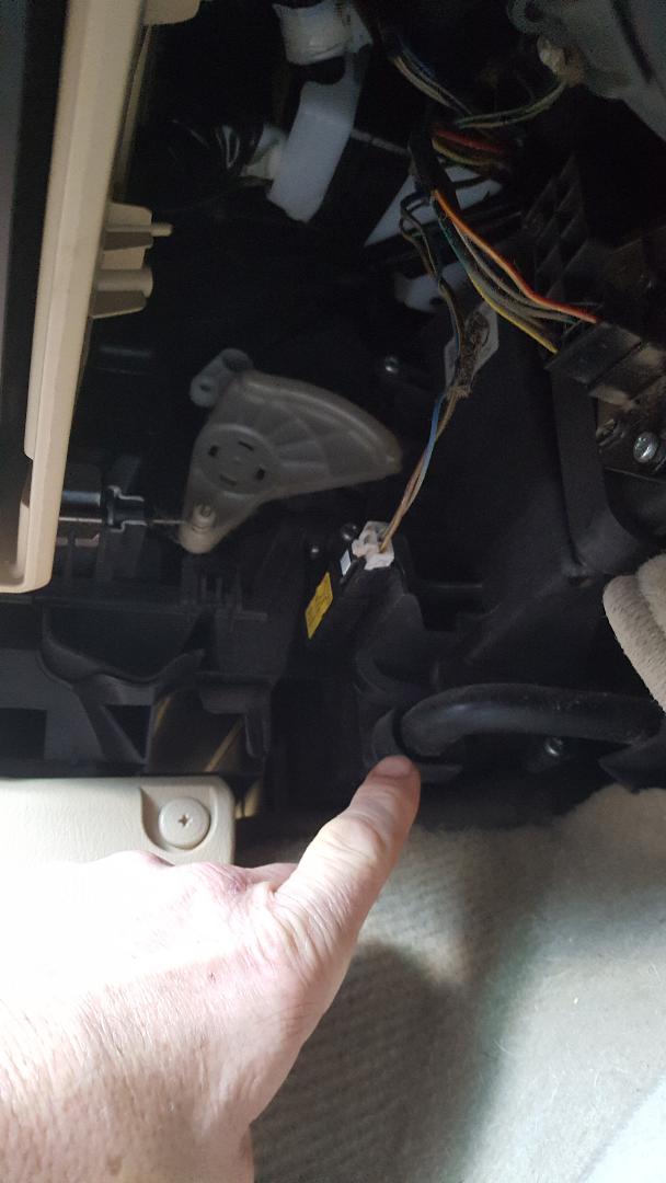

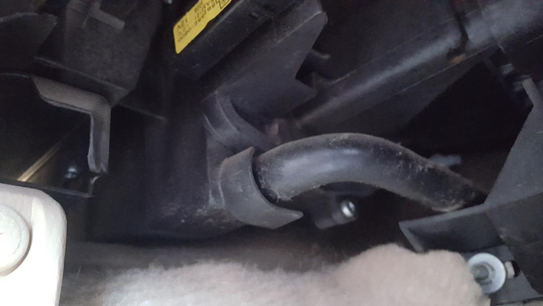

I has a similar problem with my Subaru, couldn't seem to shake the wet dog smell until mid summer, but in addition to leaking from the windshield the condensate line from the AC was clogged and would overflow to the padding under the passengers feet. I was able to snake it and vacuum out a bunch of pine needles and other gunk, then flush some clean water/simple green in and wash it and the smell out. The photos are from a Subaru, left of the glove box, and under the stereo.
