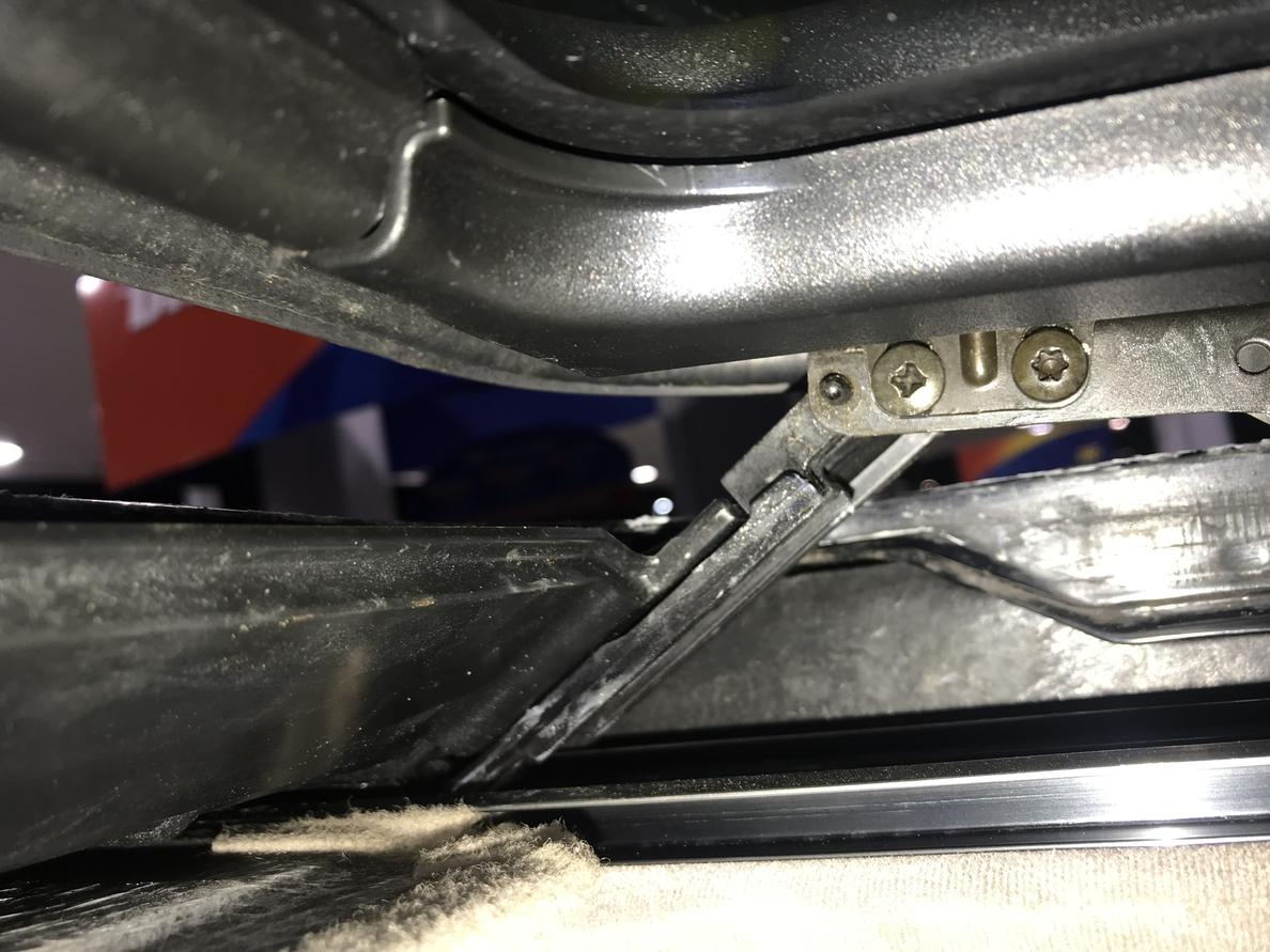

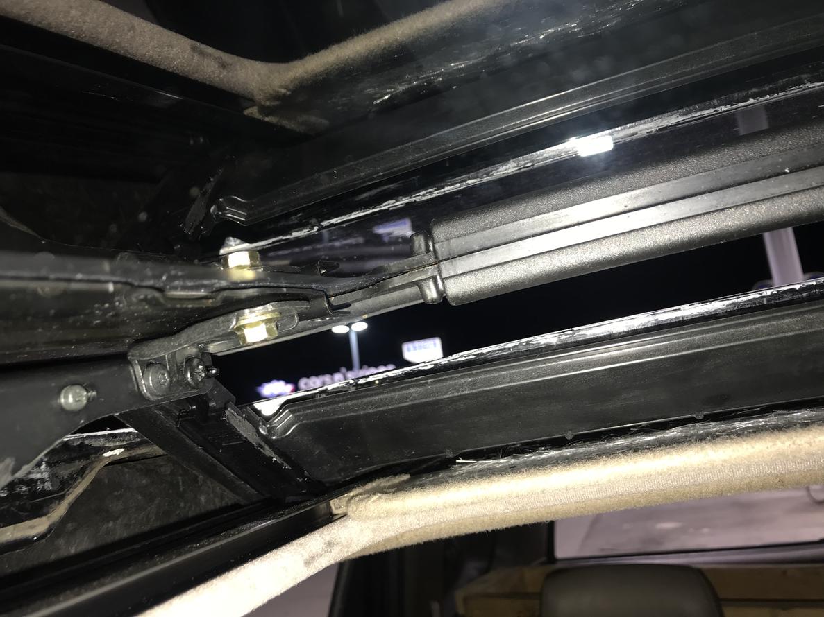

The only seal on these is the seal around the sliding glass, but even then these sunroofs are literally a controlled water leak. That is why there is channels on each side of the assembly and tubes at each corner for it to funnel out of the vehicle. The seal is not sold separately, but instead it comes as an entire unit with the glass and you are not going to want to go that route as it will cost you over $500...
Your only options really is to make sure that the seal around the glass on the outside does not have any tears, as that will let water leak into the rails of the sunroof and replicate what is happening to you. The ONLY part where water is supposed to enter is the tiny gap between the glass seal and roof. If that checks out, open the sunroof and make sure the holes at each corner is not obstructed at all. Just take a air gun and blow out all of the channels where water flows. Just note, that if it does rain super hard, it is possible for the channel to overflow briefly as the exit holes are relatively small compared to the drain tubes they are attached to.
Also, the copper tubes are what the drive rail cable is encased in, which is why my old sunroof didn't work. The cables were rusted inside of that copper tube, likely due to water constantly backing up like what is happening to you.

I did notice those little tiny holes in the corner. ( pic above circled in red ) which when my father was pouring water I though that’s where it’s leaking. But sounds like water is suppose to go on there. My seal around the glass seems in good condition. When you say, Your only options really is to make sure that the seal around the glass on the outside does not have any tears, as that will let water leak into the rails of the sunroof and replicate what is happening to you. do you mean water getting between the seal and the glass?

Yes, you shouldn’t have any water leaks between the seal and glass, only between the seal and roof as that water will channel itself into the gutters.
And yes, that part, the “drip channel” will indeed aid in channeling water from the rear of the assembly into the back gutter. It is a plastic piece that spans the entire length of the assembly in the rear, parallel to the glass. It is simply attached by tabs onto the drive rails. It is very possible that this could have became detached or broke on your rig. Just simply put your glass in the tilt position and snap a pic looking towards the back of the car to see if it still there.

But ya I remember studying the sunroof when I dropped my headliner and found the only real seal is the one that's attach to the sunroof glass. Any big leaks between there will overwhelm the drain design.
Looks like your on the right track to taking care of your leak.
