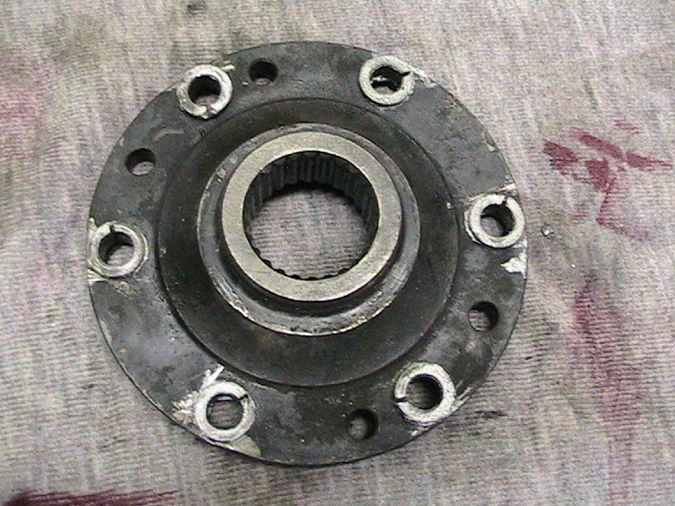

I used a combination of all the methods suggested and succeeded. However, the trick is avoiding damage that hurts. Now once I got the flange off I found that the guy who did the last job didn't replace the gasket. Should I? Here's a photo of the cones back in the flange and ready to go.
If referring to a gasket between the hub and hub flange; not having removed the hub before, there was no gasket when I removed the hub and I did not install one when reassembled. Problemly would not hurt.
Over the weekend I finished the driver's side and moved to the passenger. When I removed the hub flange I found one cone washer missing. The previous mechanic had put in a second ordinary washer. I decided to do the job right and ordered a new cone washer from a nearby dealer. $4.39 >>For want of a nail the shoe was lost. For want of the shoe the horse was lost. For want of the horse the soldier was lost. For want of the soldier the battle was lost. For want of the battle the war was lost.<<
