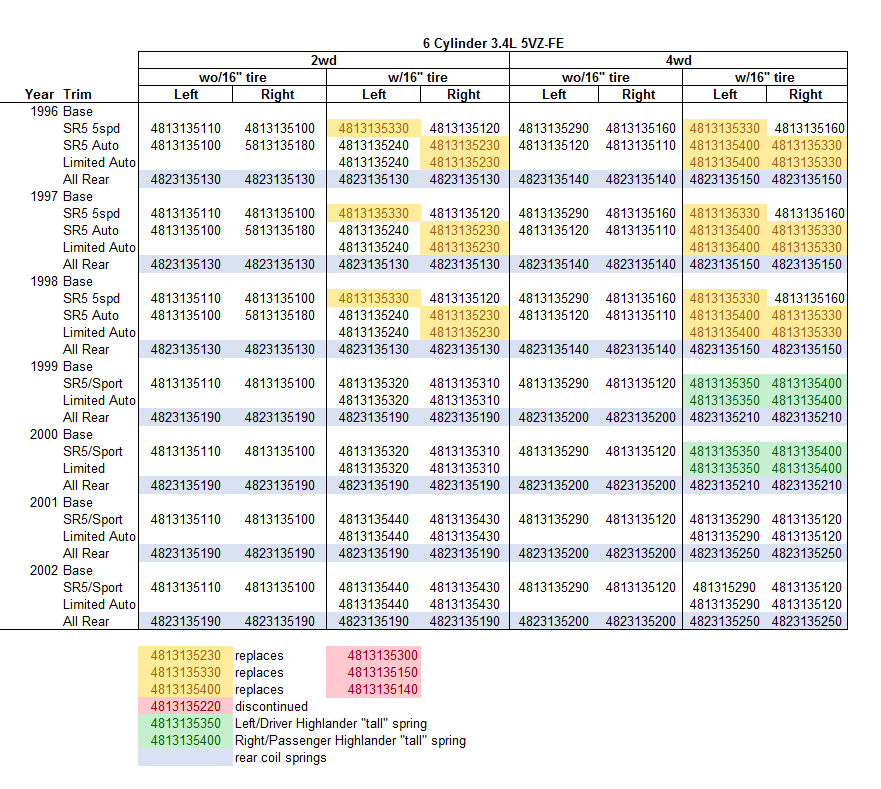

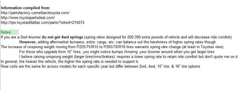

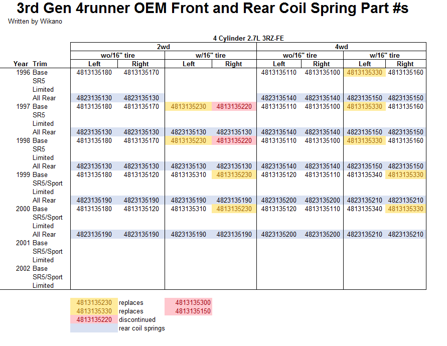

'99 tall springs:
FR Spring - Blue / Yellow (48131-35400) Passenger Side
FL Spring - Blue / Pink (48131 - 35350) Driver Side
REAR Springs - Yellow / Red (48231 - 35210)

so crawled under my 2000 sr5....same colors as listed above for the rear
