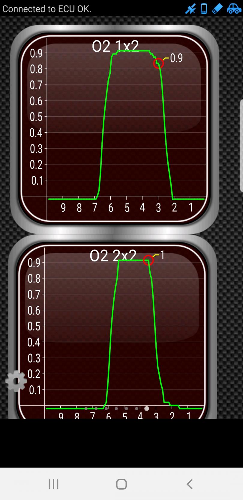

Instead of just using the scan tool to clear the codes, I reset the ecu by disconnecting the battery for a bit. Drove around and did some WOT runs, a screenshot of the bank 2 sensor 2 (and bank 1 sensor 2 for comparison) is attached. Looks appropriate to me - drove for about an hour today and no check engine light. I'll update again later.
