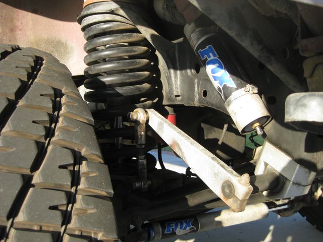

My dodge ram has a spring that ramps starting at 380 and ends at 1200, there are 4 rates in this coil, with a well tuned 2.5" fox racing shock, she rides far better then a stock truck on the road yet has the ability to haul the mail in rough, wooped out and wash board roads. Make note this is a 8,000 lb truck and it will walk away from most in the rough stuff. But, it takes a fair amount of coin $$$$ to get it to perform like this. 11" real wheel travel from a dana 60 solid axle with no steering issues.
My point is a multi rate coil and a shock that can be valved to your style and coil are the way to go.
