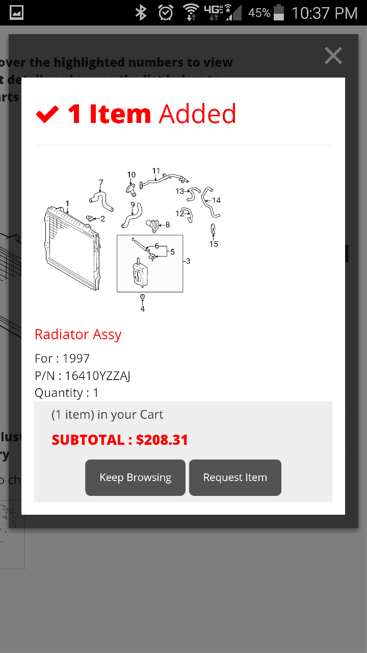

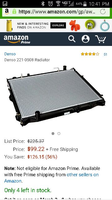

Denso or OEM. Many of us have the Denso, it's a good radiator and only 100 bucks.
OEM is $208
