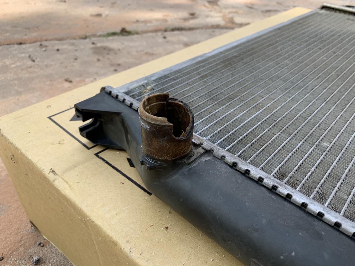

Triple down on the radiator. I would pull the dipstick and see if that stuff has gone milky. The top of my rad was nice and black but underneath one of the hoses was that same green tinge and that area shattered in my hands.
That thing is about to blow.
That's crazy! What would cause something like that? It's limited to where the hose makes contact with the plastic. Chemical reaction??
Are the radiator and hose aftermarket?
Dunno. That was the original radiator and probably a supply house hose. I'm wondering if was possibly the focused heat from the hose. If it was chemical from my choice of coolant then there should have been widespread damage to the rest of the plastic.
In fact, I've since cut the upper and lower tanks off and then the lower one in half. The plastic was still in fantastic condition.
