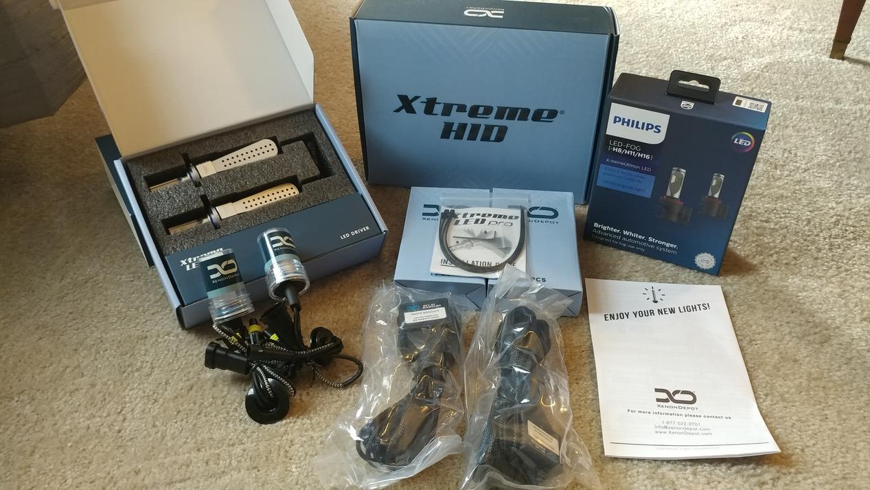

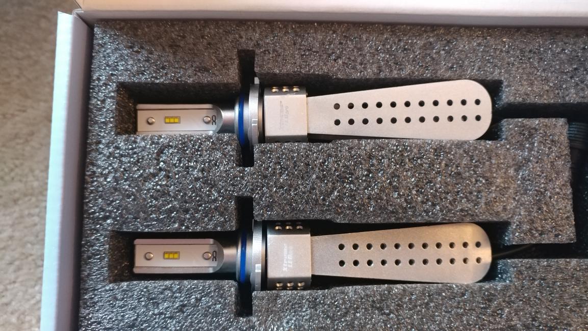

I received all of my ordered items! I'm going to perform the install this Saturday or Sunday. Exciting stuff!

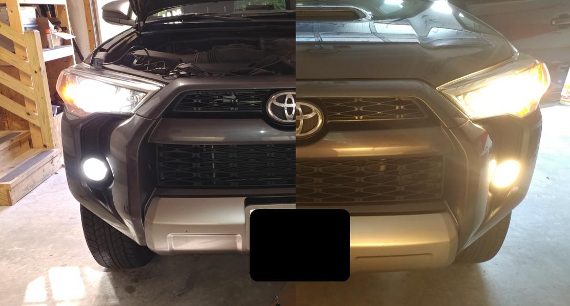

Thanks for the comparison picture!

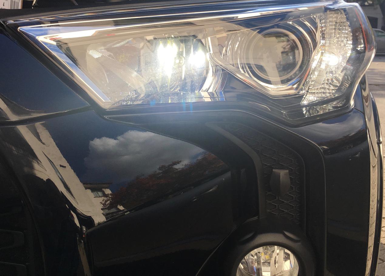

THANK YOU Xenon Depot for the R&D and bringing this product to market so this last (well only) thorn in my side about this vehicle after one year of ownership is finally resolved. Won't miss that halogen look :cheers:
That is all...:beer:
