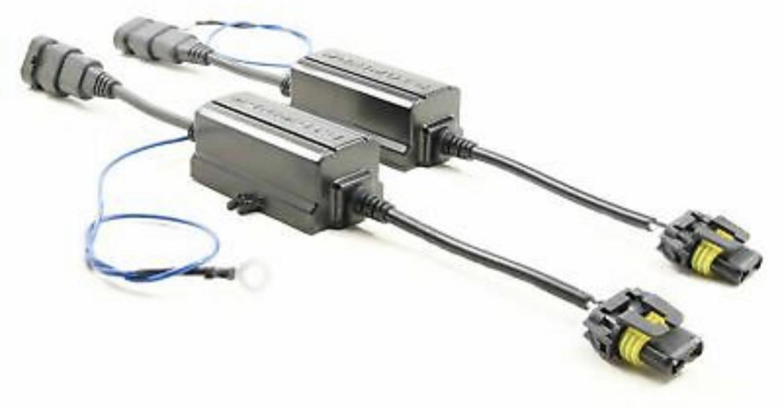

So I am going with the Morimoto HID kit, but using their stand alone canbus instead of the HD relay. That part comes with a small blue wire terminating in a ring, and despite looking at the Morimoto and TRS instructions there is zero mention of this wire. It looks like a ground. Anyone have experience with this?

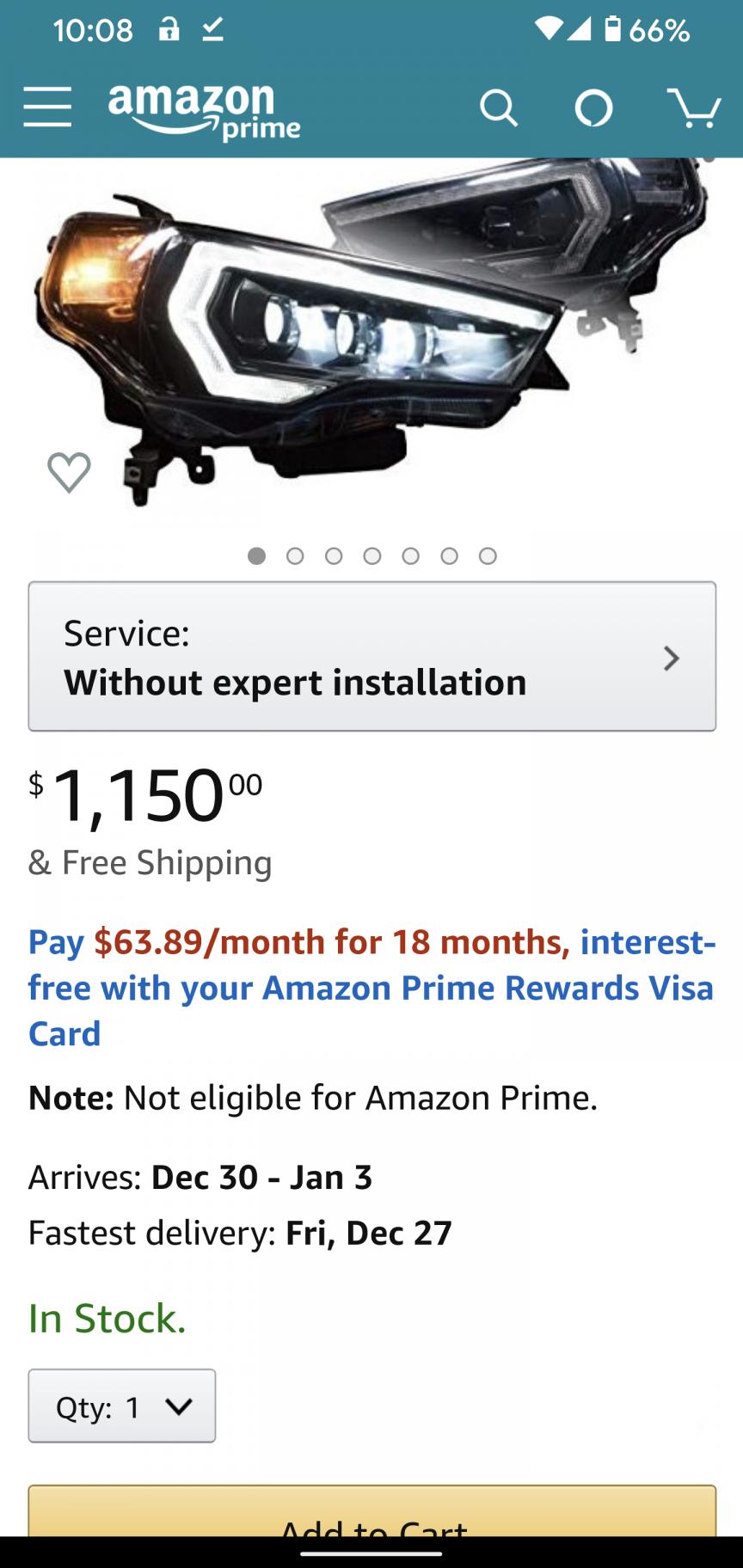

The Retrofit Source royally screwed up my order and now my headlights won’t be in until early January. I’ll post some pics then! In the meantime, there’s someone that has an AG TRDP like mine with the XB headlights that posted in the official AG thread.
Cancel them. Amazon has them and you can have them Friday

Stock photo but it’s legit. Funny thing is this photo is at the beginning of the Morimoto instructions but the blue wire isn’t in any diagram after the cover shot.
TRS confirmed it’s a ground wire. Odd that Morimoto has detailed install instructions but fails to even ID this wire. I think I’m a rare one using the standalone canbus option on a 5th gen, to avoid the extra wiring of the HD relays...
