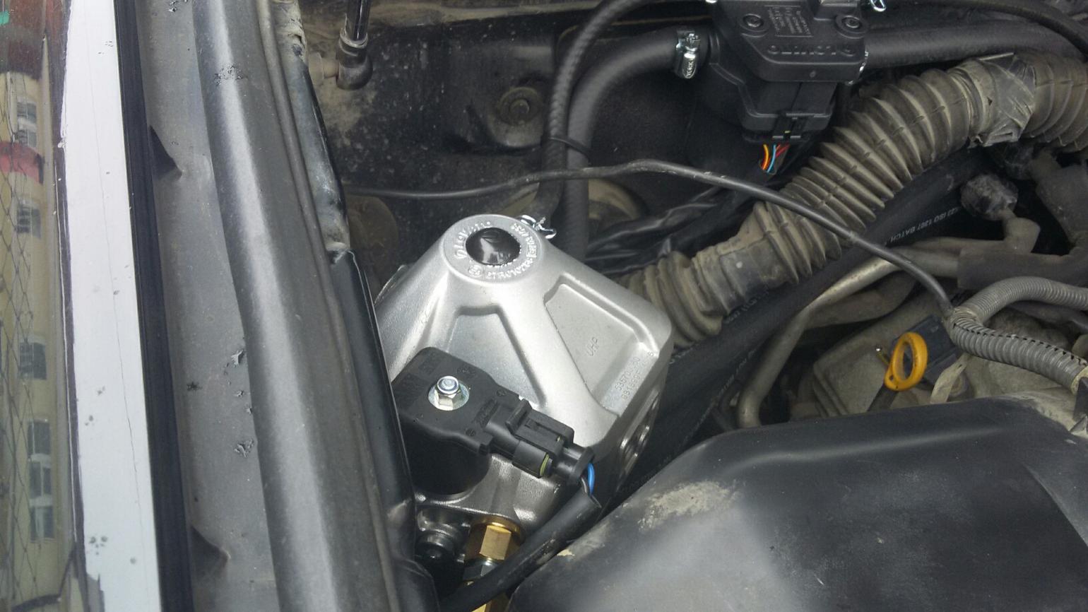

The system consist of several elements which supply LPG gas to the injectors: electronic regulation, injectors, a sort of "carburetor" to get the LPG gas into the required temperature and of course a tank (bottle) for the gas. I chose the biggest available bottle with 90 liters which should give me a range of around 400 miles (app. 650km) on LPG.

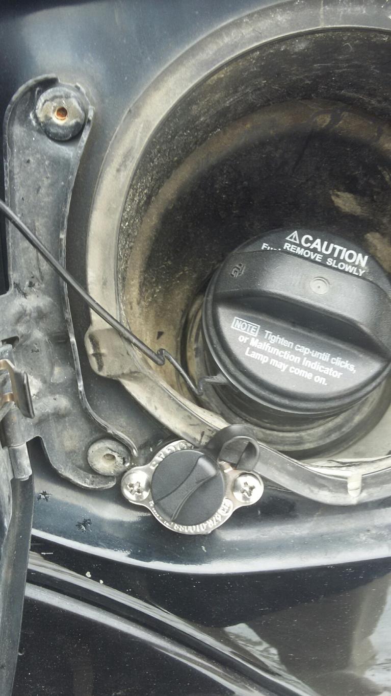

Filling the LPG bottle is a bit different. LPG is injected with pressure into the bottle, the LPG hose connects tight to the filling hose of the tank. The nozzle is just next to the regular filler cap and invisible. Nothing too difficult once you got used to it.

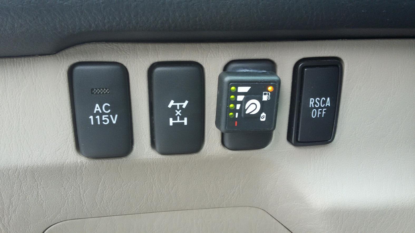

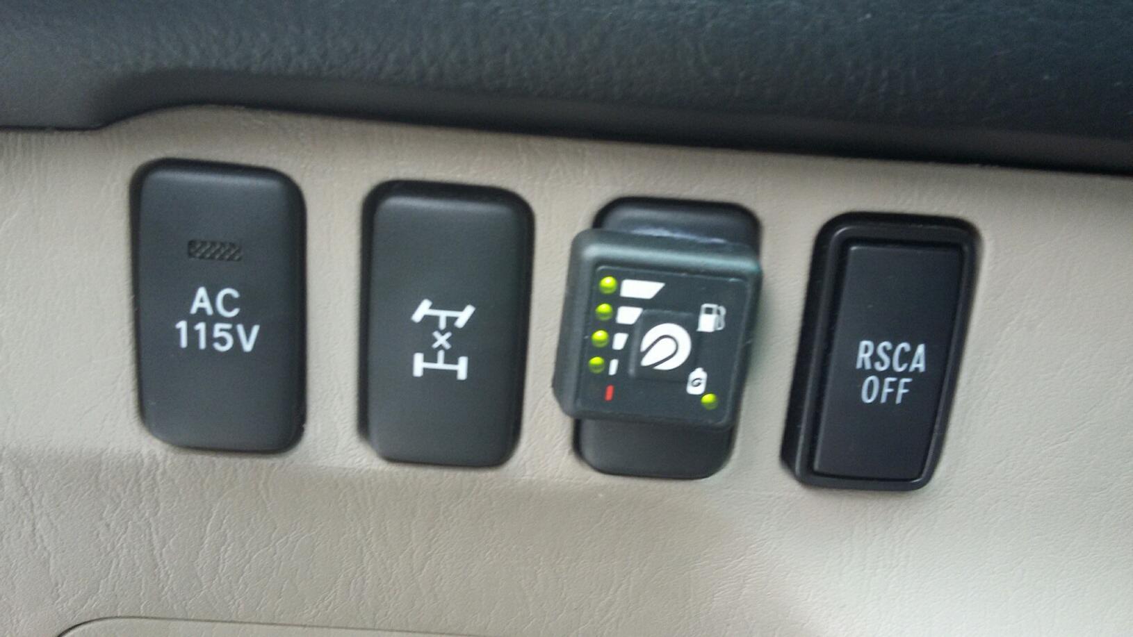

The system works like this: when you start the engine it runs on benzin (gasoline) until the LPG unit reaches working temperature. (Its freezing cold right now, so it takes about 5-6 minutes, otherwise its much faster).
Once working temperature is reached, the system switches automatically to LPG. This is indicated by the green light on the button, while the yellow light indicates that the engine is running on gasoline.

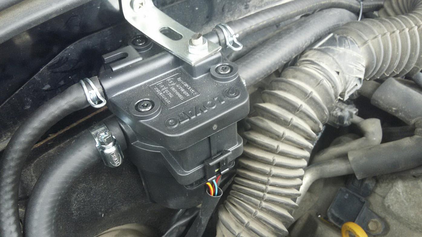

1) electronic injection regulation
2) gas unit (sort of LPG carburetor)

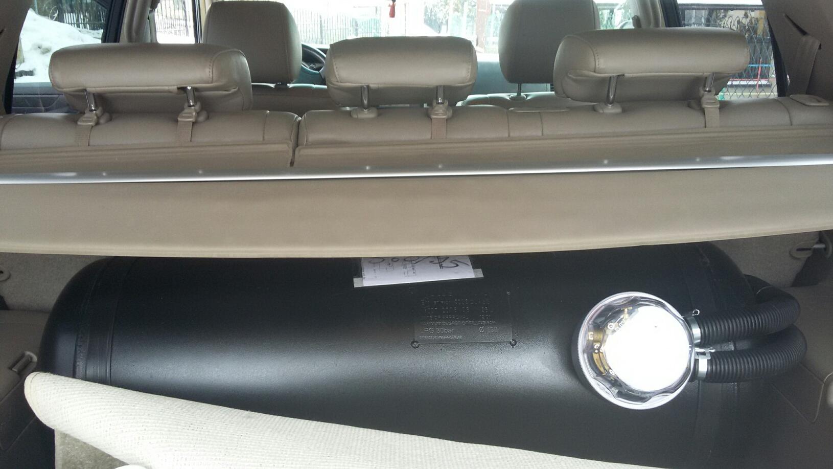

4) LPG 90l tank in the rear of the T4R [safer than under the vehicle, particularly when riding off road]
5) this is were LPG is filled in the tank, just next to the regular nozzle and invisible
6) switch showing the engine runs on gasoline (yellow light)
7) switch showing engine runs on LPG (green light)

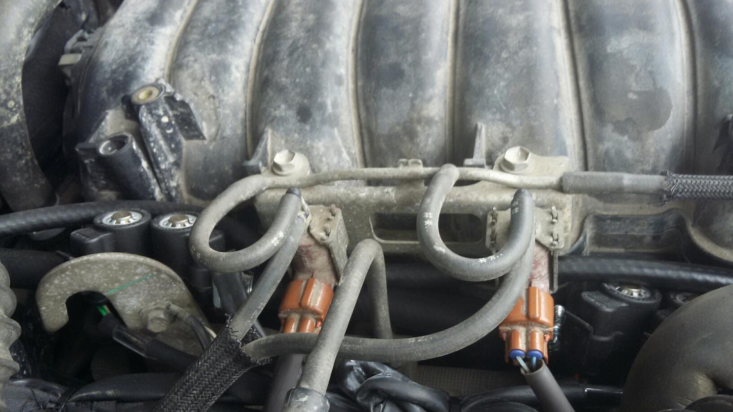

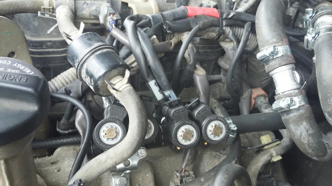

8) injectors left side of the engine

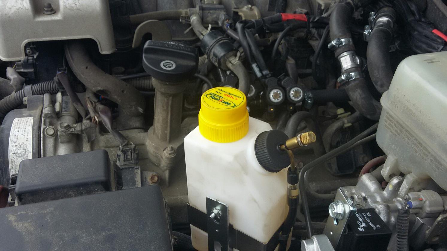

second batch of pics
The "sacrifices" I had to make: the LPG bottle in the rear of the T4R reduces space. So when on tour we cannot sleep in the T4R since the bottle is in the middle when the rear seats are pushed down. But in three years I only slept once in the T4R when we had an emergency getting stuck in shifting sand on a beach in Albania. So no big loss!

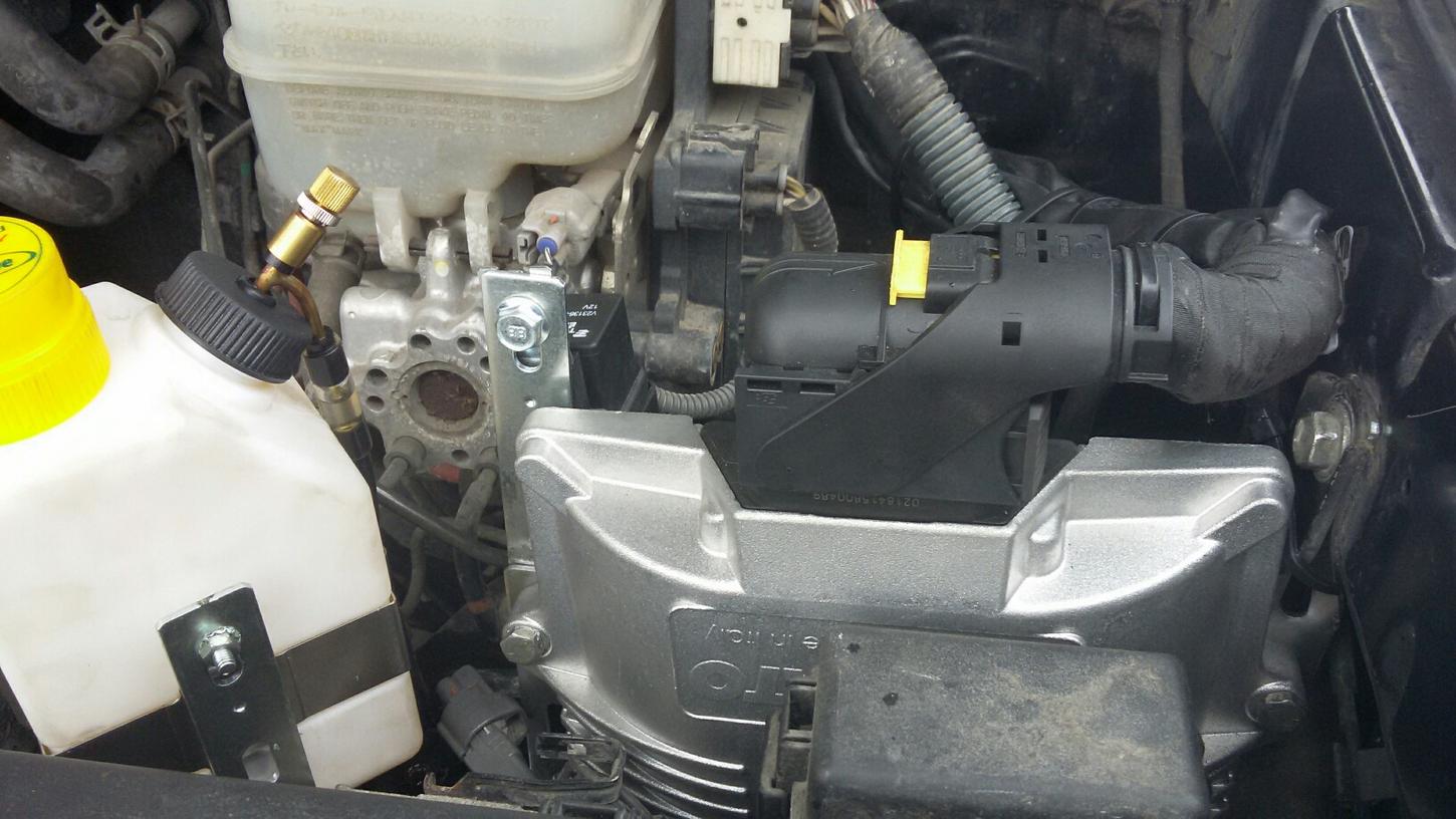

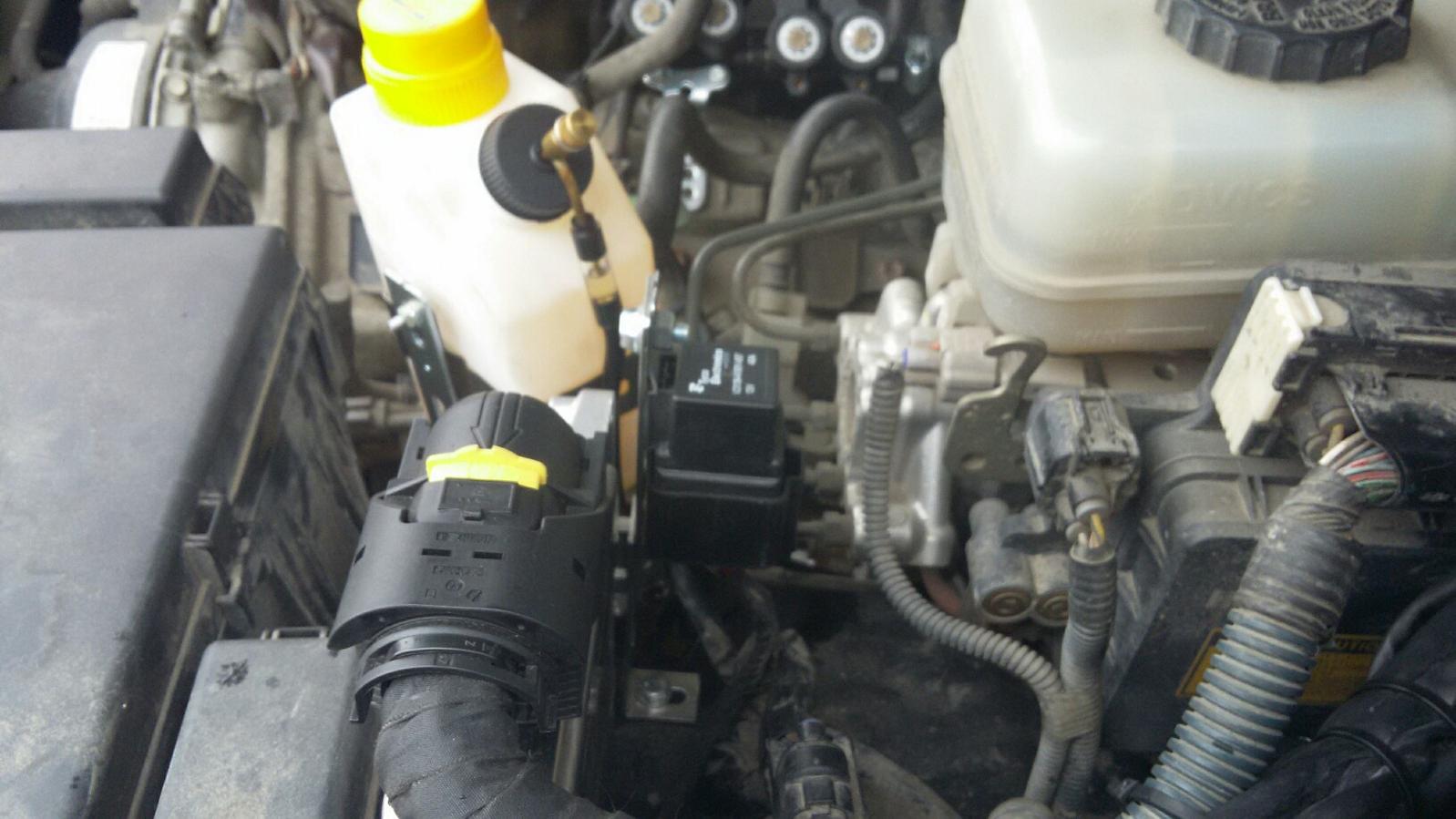

Every 10k km or I have to refill the lubricant bottle (just a few pennies) since LPG is less lubricating than regular benzin the engine needs an additional source for lubrication when running on LPG. Its regulated electronically.

1) LPG injectors right side
2) lubricant container with electronic regulation
3) lubricant bottle

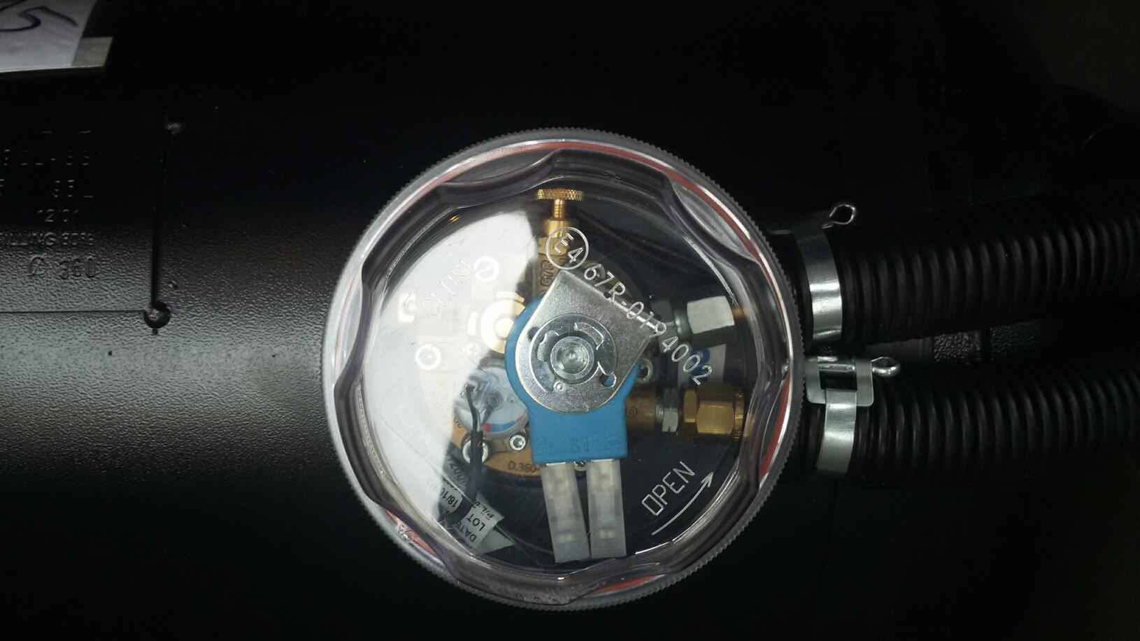

4) regulator on top of LPG tank
