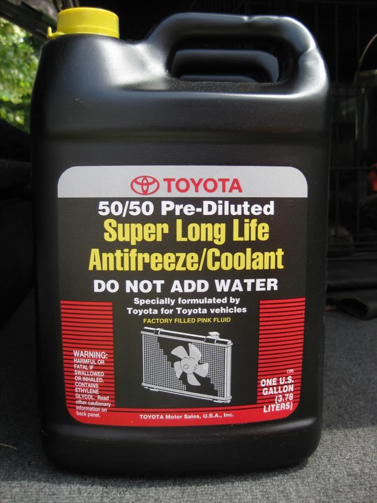

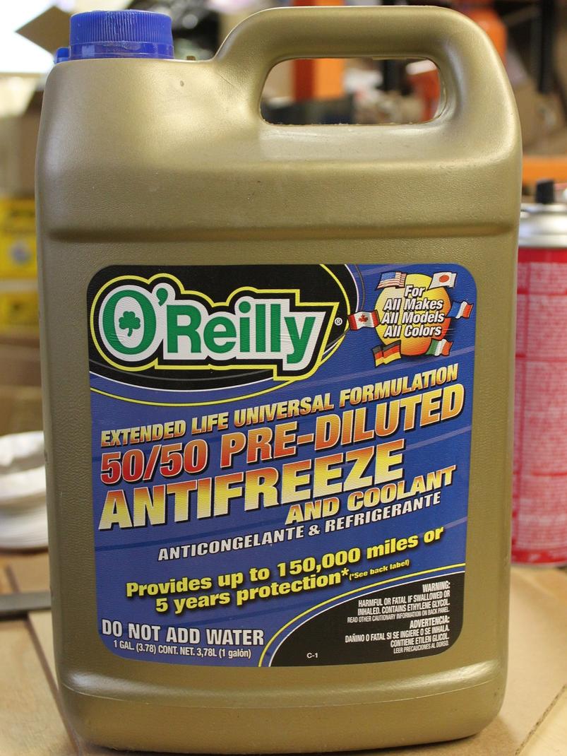

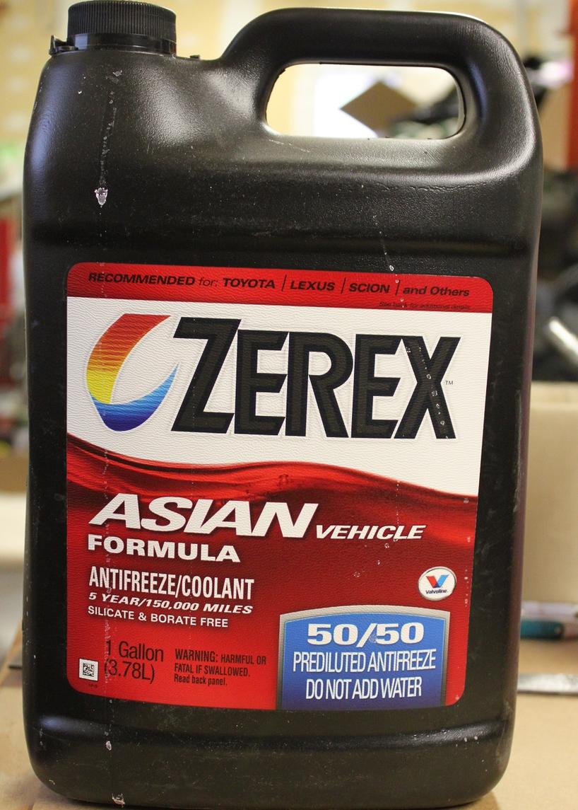

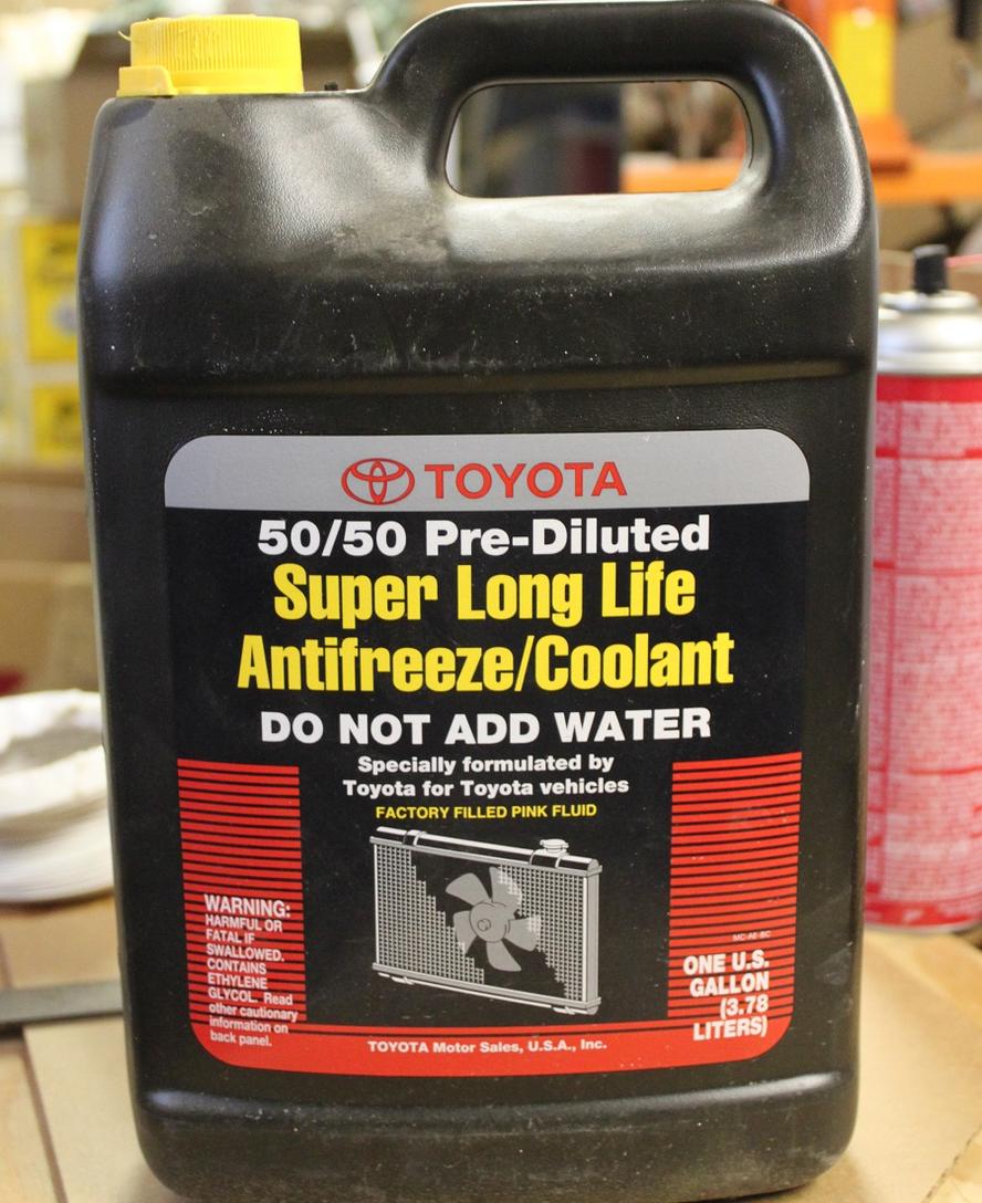

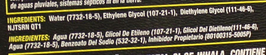

Food for thought.
Toyota, Zerex(Valvoline) and O'Reilly's.
All the same stuff...Toyota added acid.
