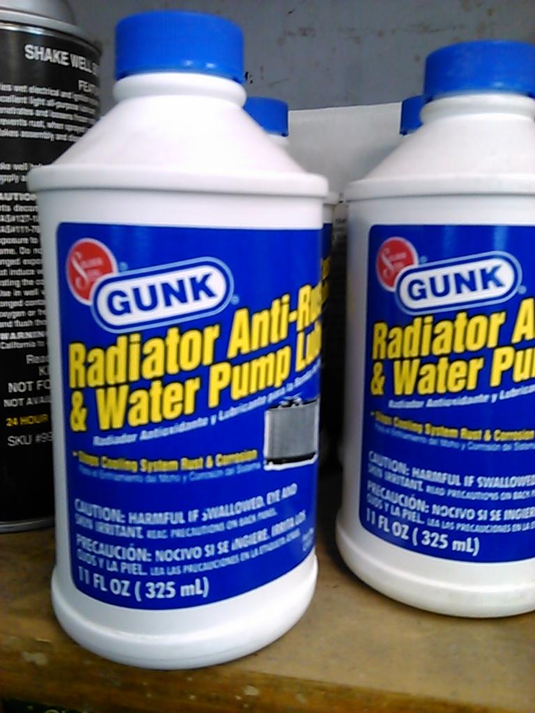

The best way I found was to pull the thermostat and flush both ways. This gets all the crap out that gets stuck in crevices when you only flush one way. I flush every two years the inhibitors in coolant (any coolant) IMO break down overtime. I also add a bottle of this every year.
sean, can you add that stuff to existing coolant and it dissolves within? (i.e. doesn't increase the capacity if my radiator is already full?)
This old timer that owns an old school radiator shop near me advised me of this. He must be 80 years old " Been workin on cars for 60 years all sorts of dissimilar metals in their now" He said its the only stuff that works. I use it now on everything once a year. I add it to my overflow. If its at full I would siphon a little out of overflow but probably wouldn't matter either way its a small bottle.
