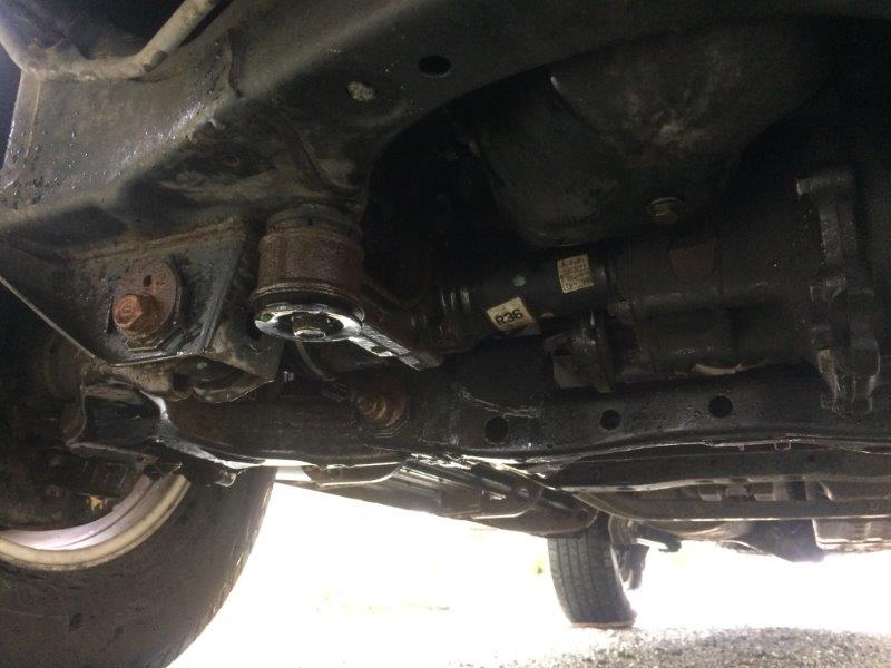

I've been aware of some previously mysterious coolant loss for a couple months now and finally observed the following:
- coolant dripping from passenger side, front engine area (see attached photo)
- haven't actually seen active dripping, only coolant wetness
- can't see where it's coming from looking down thru engine bay
- rad coolant level appears to only drop when the heater is used
- doesn't seem to leak when parked and engine off
I haven't tested running the engine and heater while parked to see if it starts spewing from somewhere, but this seems like a good test (will do this on the weekend when I have time).
Just wondering if I can rule out anything based on it only leaking when the heater is on? I.e. water pump, etc.
It's difficult to see exactly where the leak is coming from when I look under the vehicle, and I don't see any from looking down the engine bay. Any suggestions on where to start? Rad seems fine, if I were to guess it's something low in the engine area.
Thanks for any pointers

For sure its after the heater control and could be just about any hose or fitting. Wash it off...let it dry...fire it up...crawl under and wait. Mine had a leaky hose at the back of the block....was dripping down the back passenger side of the motor when it finally appeared.
Checked the heater control valve. Clean and dry.

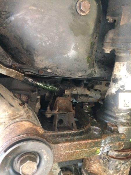

I've been stuffing my face up under my truck a couple times and all I see is this item. Doesn't look like a hose to me, but it looks cracked and also looks like the source. The rest of the items below it, like the bushing and arms, I assume are getting wet from the wind under the vehicle...
