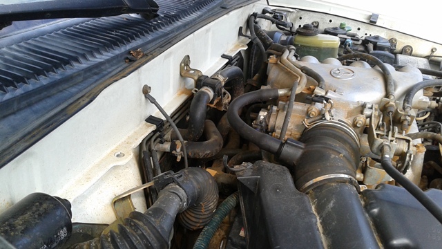

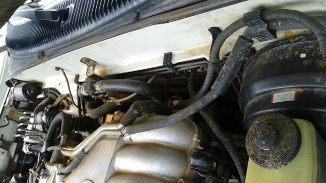

i posted pics. I can tell there was a leak at one time. under the hood has residue from a previous leak. i ordered a oem thermostat and oring
the leak is not consistent. i drove it this morning for a few miles. i turned the heat on. i did begin to feel some heat coming from the vents, and it was leaking again. it's leaking near the bell housing, so it may be that rear heating element. i just gotta locate the lines to it, so i can try bypassing it

I followed the thread for the leaking heater element. that was for a 1997. mines a 1999 limited. I figure both are the same, but i don't see the same metal lines where he bypassed the rear heating element, like under the hood of the 1997
They would go down right where that open hole is next to the ground wire. So that's not the culprit then.

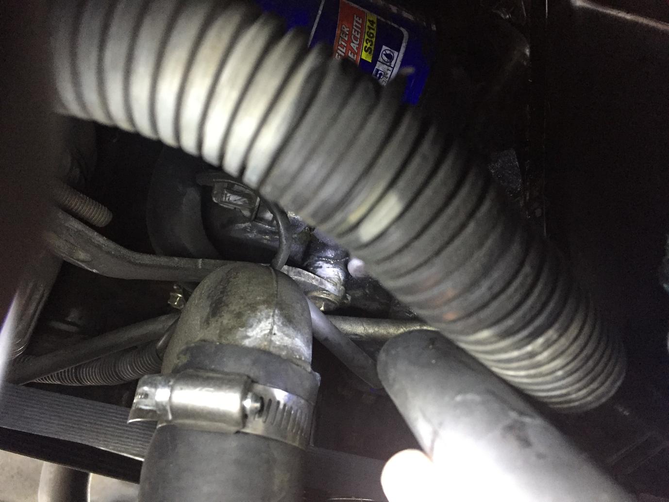

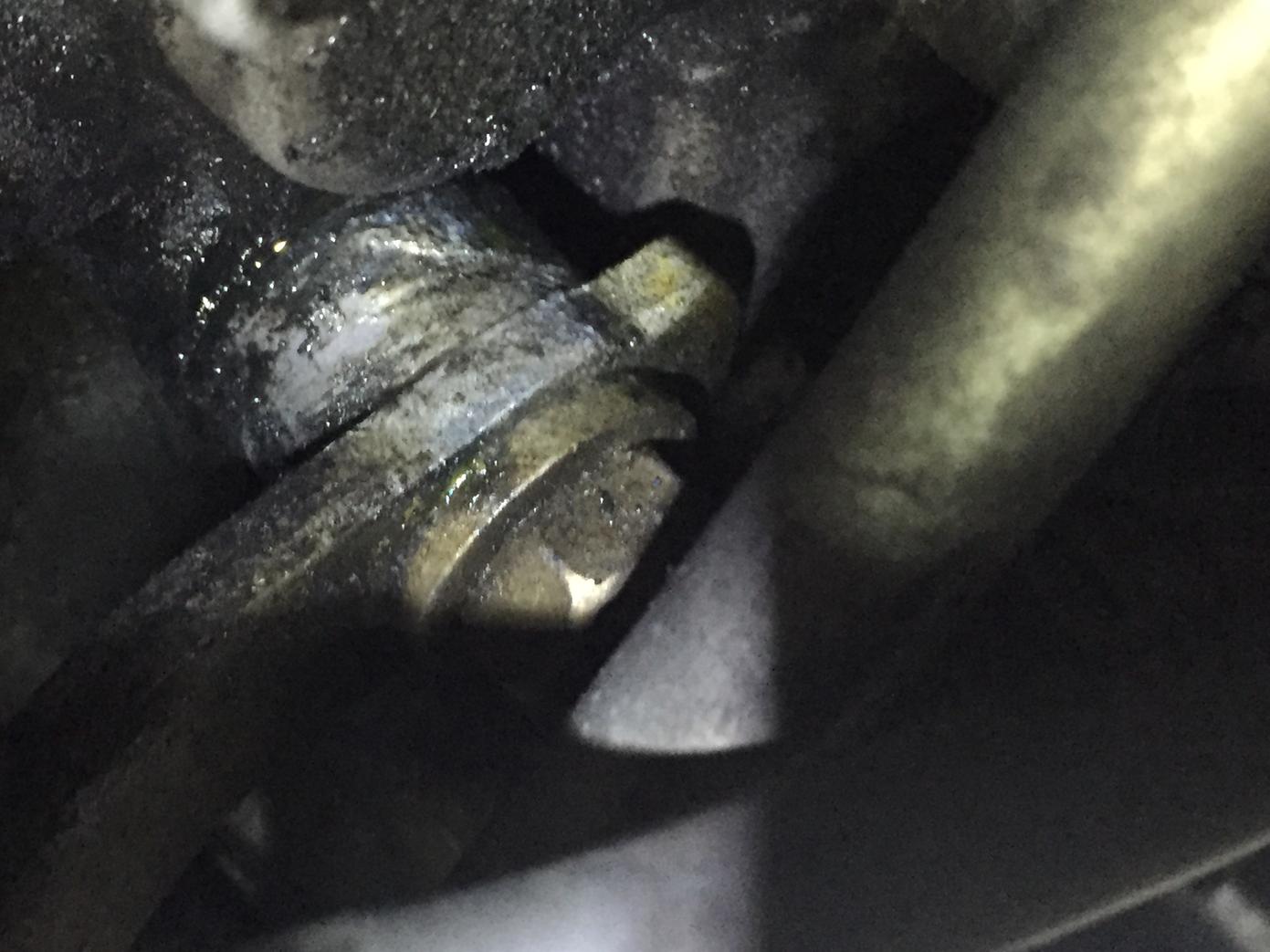

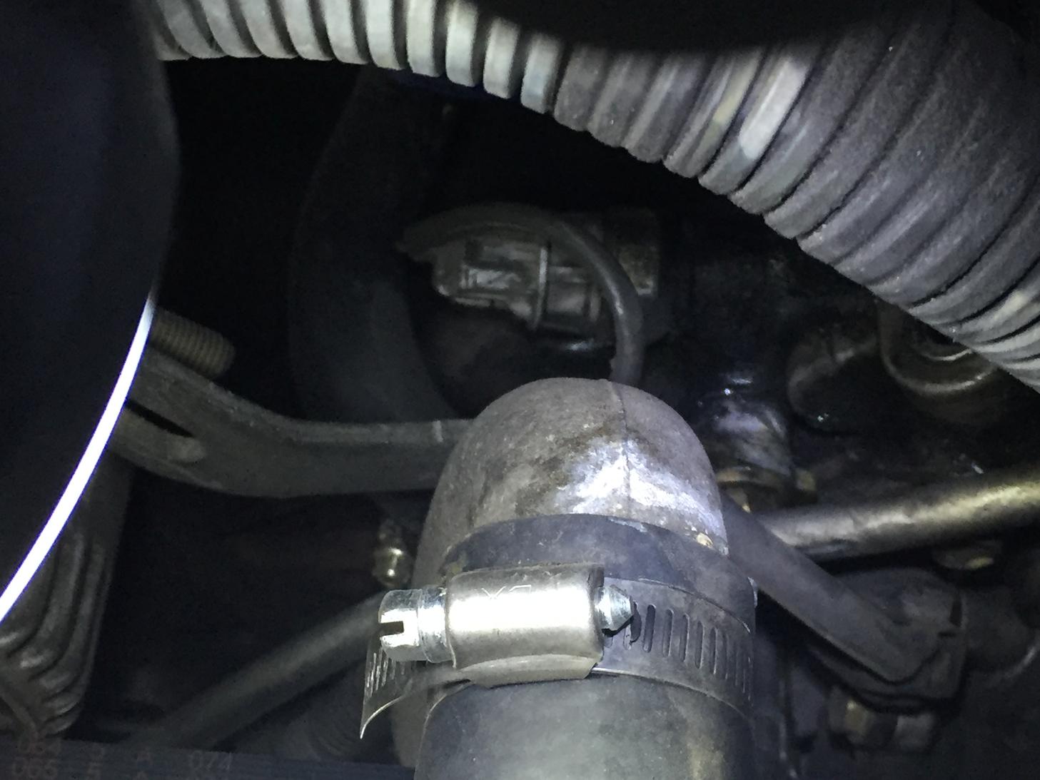

Coolant Leak
I have had this coolant leak for a couple of weeks, and have had a recent water pump and timing belt change months prior. I track it to this area where the metal rod that supports the alternator connects to the engine. I just need help identifying what this part is called and if it's an easy fix or not. I have a 99 3.4 2wheel drive by the way.
