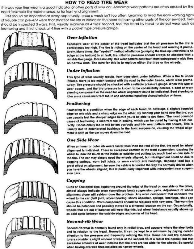

This might help.

I've talked to several shops, and they all point at the same thing, suspension. So the question is how can the suspension on a 2014 be worn to the point of cupping the tires? I had dealership look at the suspension after the winter was over just as a precaution, and they say "all is normal". So the tire shop that put the tires on said that Cooper may pro rate me on some new rubber, but that still does not determine the real issue. I guess I can always try a different dealership and really have them look the suspension over.
