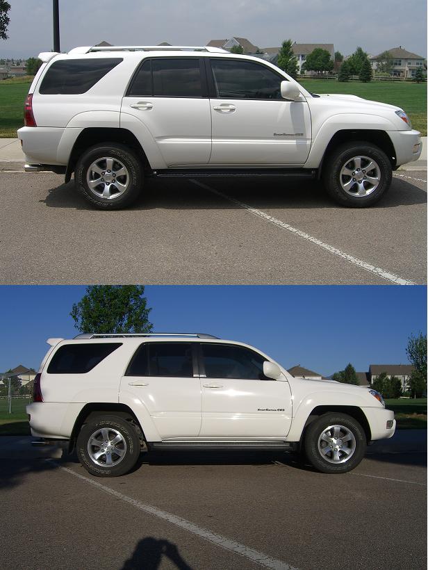

Hi All,
I know everyone is probably sick of Cornfed-spacer lift posts, but I also know that I read each and every one of them before deciding to do mine.
I was tilting towards removing XREAS and installing Donahoe coilovers and new UCAs along with new rear suspension but decided to try the spacer lift first due to cost.
So far I'm very happy with the lift. The ride is a little "tighter" on the streets which is to be expected and I definately like the new stance.
One thing that I didn't read on the forum anywhere was about the need to re-center the 4Runner's yaw-sensor after suspension work. When I first left the shop, the VSC (Vehicle Skid Control) light was on and would not got off. After about 10 minutes of troubleshooting, the techs found that the yaw-sensor needed to be re-centered after the installation. Once that was done, light went off and we were good to go.
Now I just need to get those Dunflops swapped out!
First picture is after, second picture is before.....

That sure look high for the 2/1 combo. Looks good though. I have a 1" front waiting to be installed. I thought about switching to the 2/1 , but not sure . Other than the looks there are no real benefits except 1" more clearance under your front bumper.
Hi Falls. There is a definate increase in height and about 2+ inches of clearance on the front bumper with this kit. It's exactly what I was looking for though as I've been in many circumstances off-road where those 2 inches would have come in real handy.
