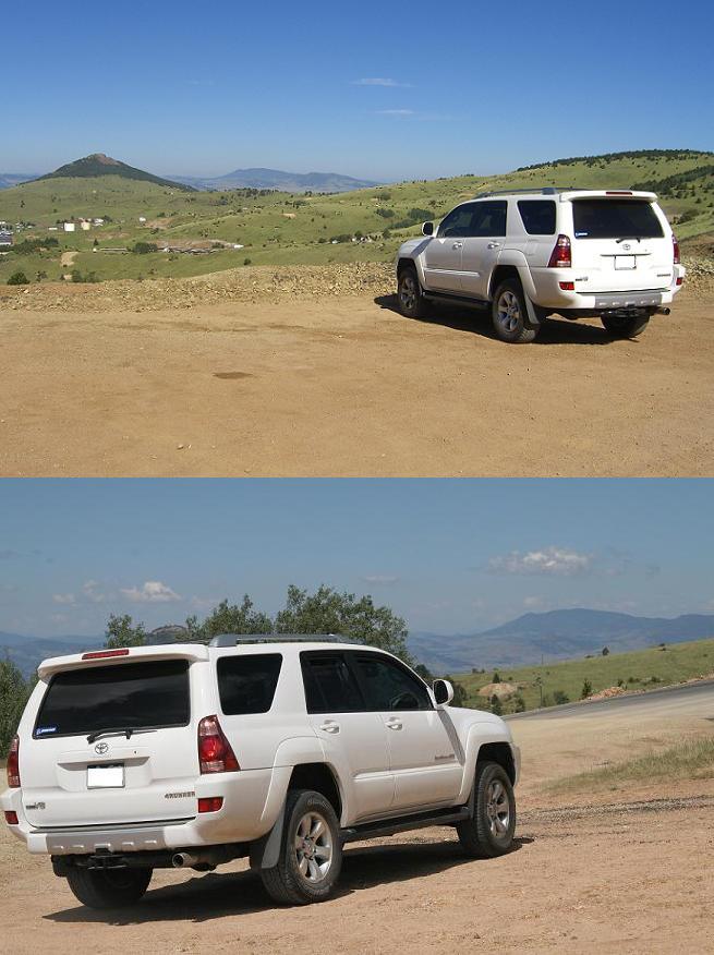

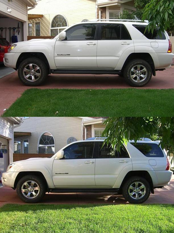

Here's another set of pics...first pic is with the lift, second pic is without....it's on a slight incline so nose looks slightly higher than normal.
