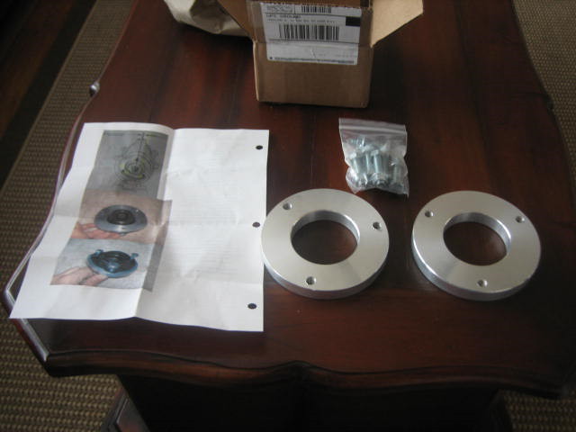

Finally pulled the trigger on the leveling kit from Burtman, but I special ordered the 1.25" lift (5/8" spacer) instead of the standard 1" lift. Pretty excited - will post before and afters of everything.
To answer questions I know will be asked:
*I have 25k mi on my cross terrains (265/65/17) and don't plan on replacing 'til worn. At that time, 265/70s will go on her.
*Lift is for physical appearance only - not for offroading. I simply wanted to get the nose off the ground. I don't want it level with the back, just raised 1.25" in the front leaving a good ~inch of rake as desired. The standard 1" kit probably would have been fine, but I think 1.25" will be perfect for me - so why not!?!
*I went with cornfed after fully exploring different options/materials from daystar, toytec and others. I'm sure the poly works just as good as aluminum - I simply got cornfed because of the ease of ordering exactly the size I want. That simple. Americans love convenience, and I'm no exception.
______

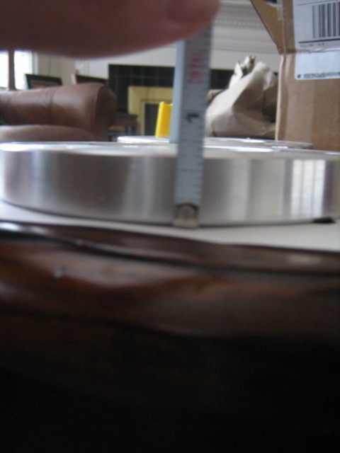

5/8" spacers (1.25" level kit):

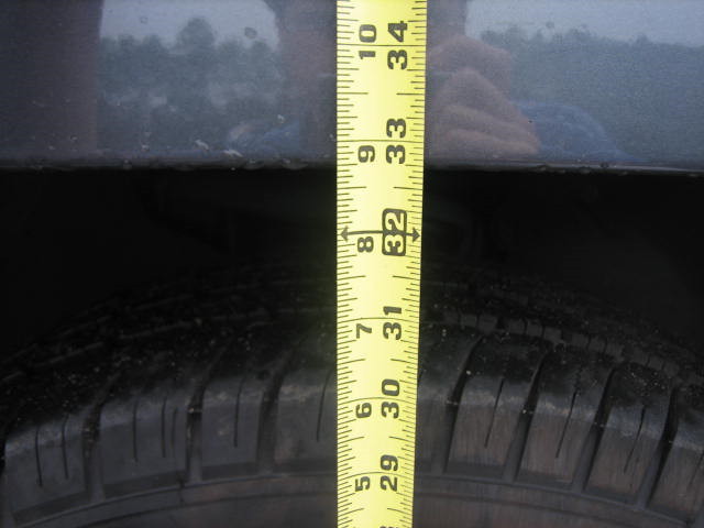

Before install measurements (full tank, somewhat level parking lot):
Front Left- ~32 11/16"
Front Right- ~33 1/16"
Back Left- ~35 3/16"
Back Right- ~35 13/16"
Pics in that order below...
front left:
