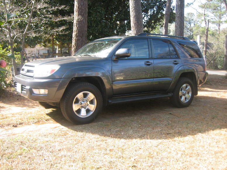

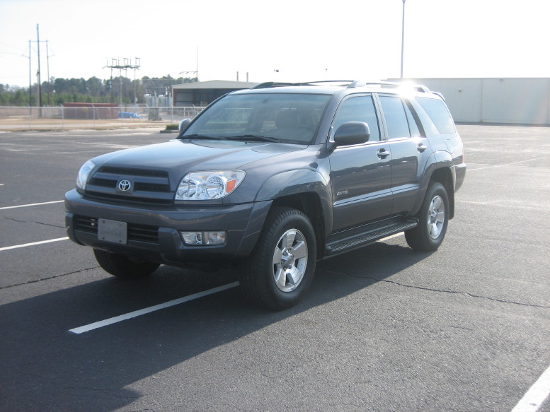

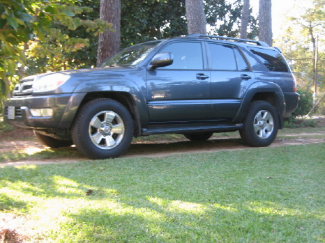

Cornfed on the way
front right

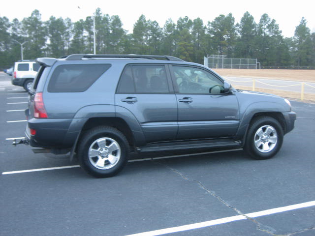

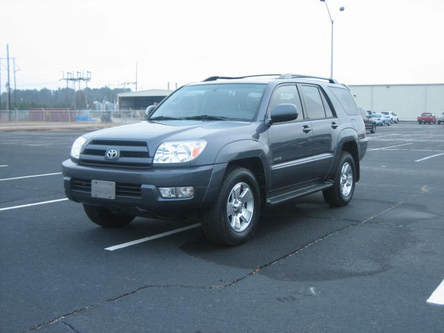

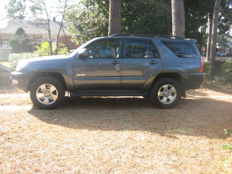

A few more before shots: (slightly uphill)
5/8" spacers were installed on the front this morning. Looks very close to the 1.25" total front lift that I was expecting.
As you've heard numerous times in here, this is what the truck should look like from the factory in my opinion. I'm very pleased.

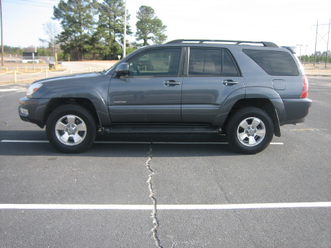

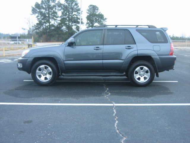

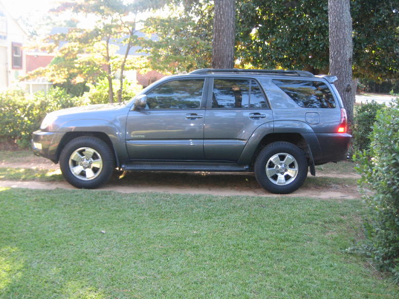

After shots:

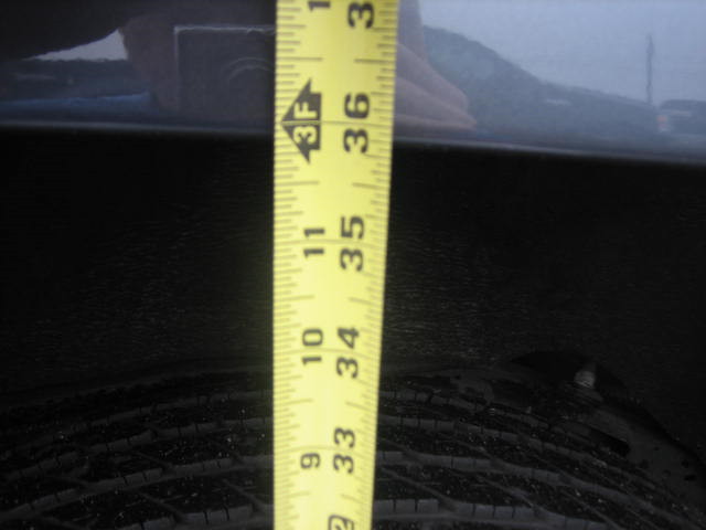

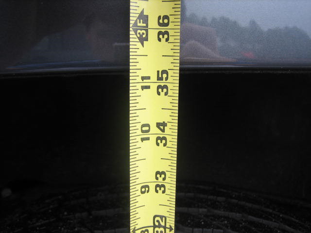

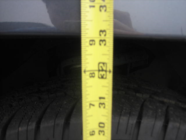

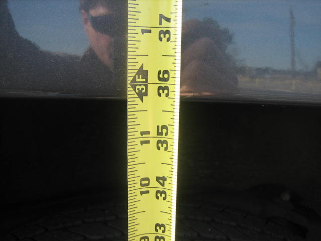

After measurements
Measurements after install (half tank):
Front Left- ~34" (32 11/16" b4)
Front right- ~34 1/4" (33 1/16")
Back Left- ~35 11/16" (35 3/16")
Back Right- ~35 3/4" (35 13/16")
Total front lift= ~1.25".

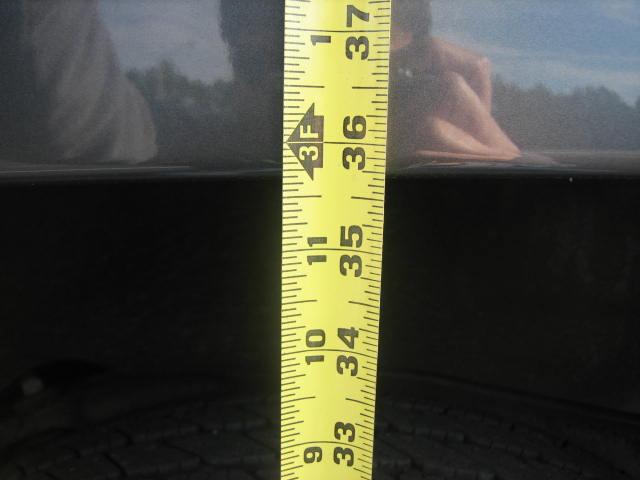

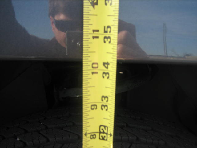

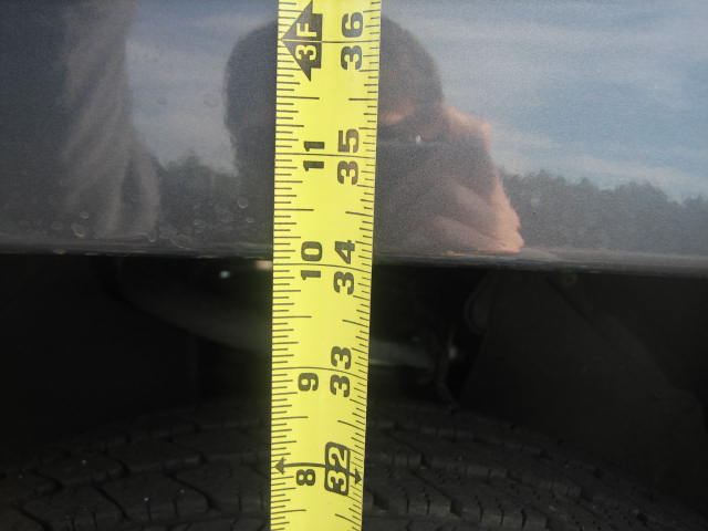

Front left pic:
The difference is small but just right for my needs. Cornfed and Jason Burtman were fantastic - thanks again JB.
