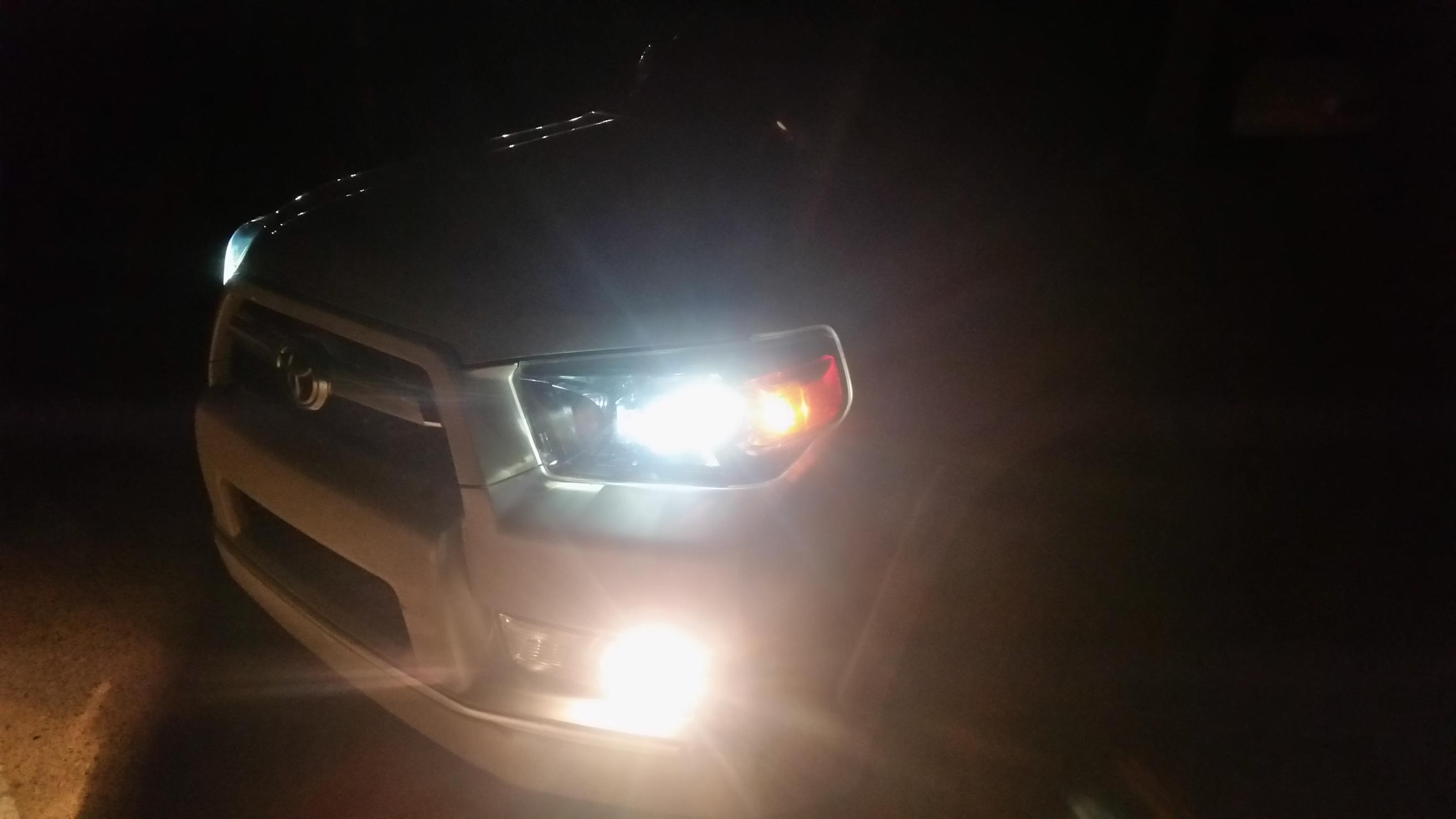

corolla led retrofit in 5th gen 4runner.

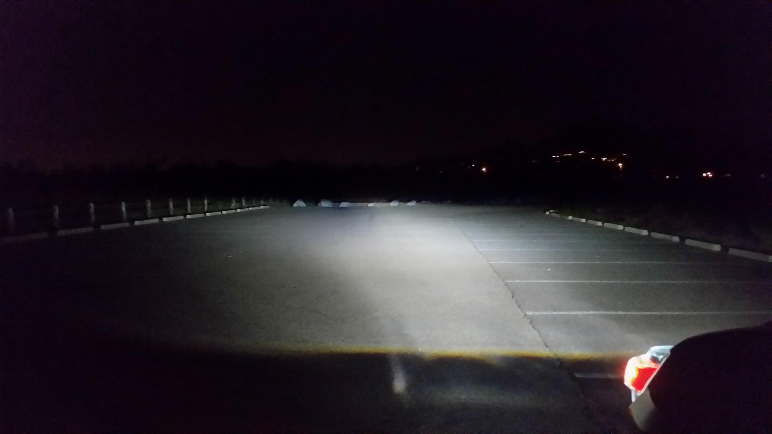

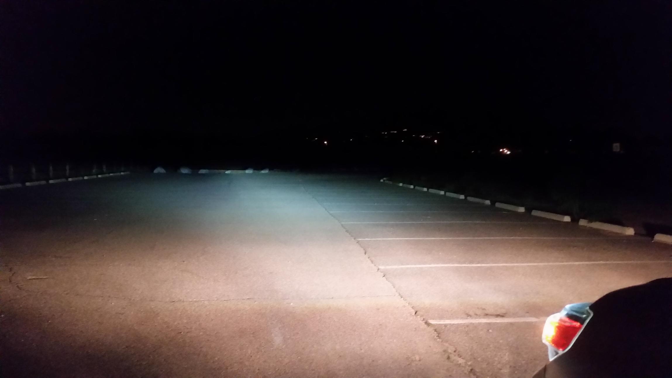

for some reason the camera makes the color temp seem like 12000k compared to the fogs, its about 6500k. and yeah they have a fairly centered hotspot but the distribution is nice and smooth, no laser beams as they call them. the fogs add the additional width that they need, and if needed hid's could easily be fitted into the fogs.
they arent quite as bright as my 55 watt morimoto xb hids in my fxr 3.0 3" projectors, but like i said previously they have smooth transitions so the lights them self arent distracting for my dad to look at. there really is no visible step its more of a color shift on the left of top of the beam. i also noticed the reflectors almost had a dichroic effect so that would account for the epic color flicker.
on a side note, these would make some bad ass reverse lights.

Just gave my dad his truck back and he loves it. hopefully the higher color temperature will make his long trips easier.
