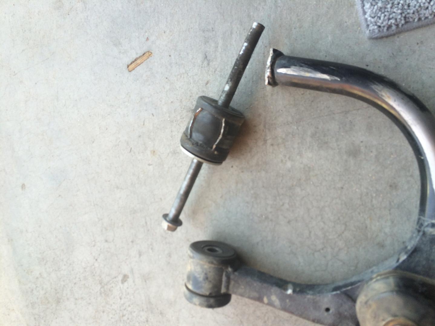

lol. A cracked boot is nothing. My SPC ball joints were worn out in a few months, among other problems. Trashed them after about 6 months. Not to mention they are pretty famous for complete failures, like this:
138657d1417753219-spc-light-racing-uca-image-jpg
