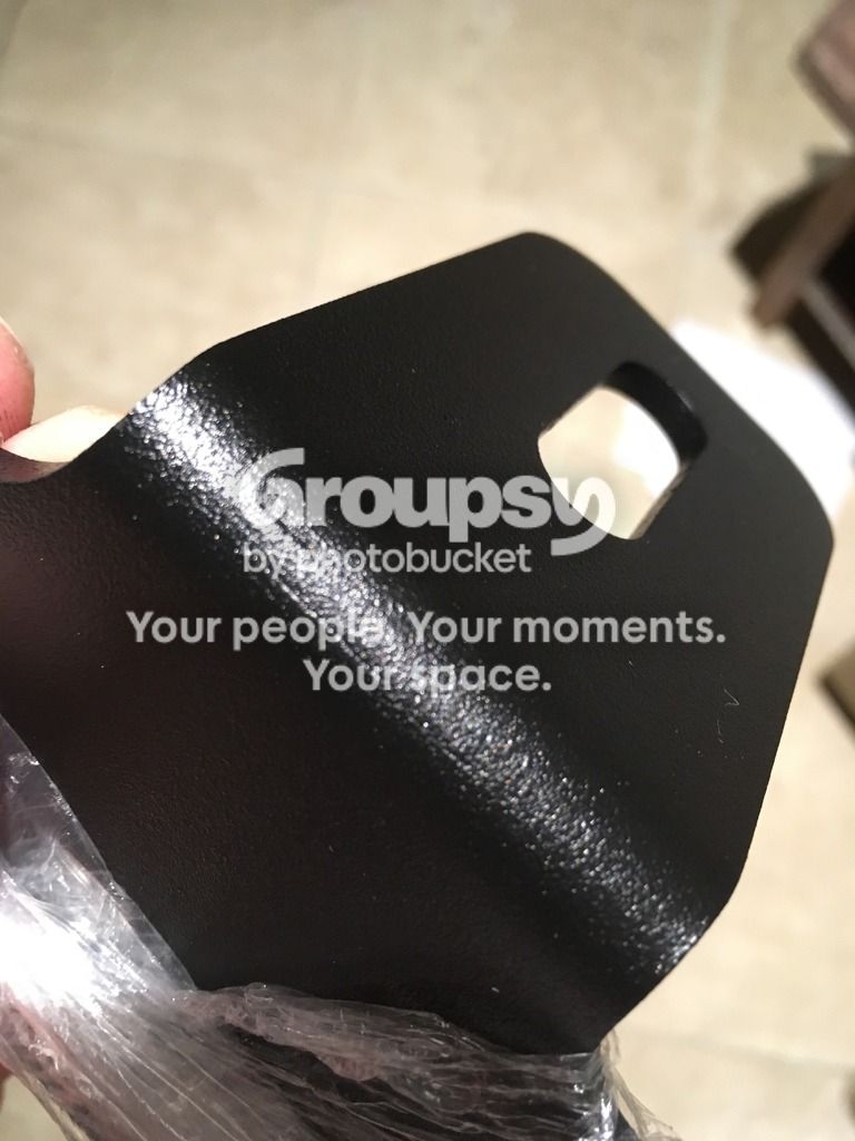

Cracks in Prinsu Rack
Yup, this! We see if a lot at work too... alum mfg. Alloy, temper, and bend radius. Thicker material needs a larger bend radius (wider press brake die) to avoid this. But, I'd consider it a cosmetic blem since you are only going to be supporting a couple hundred pounds at best on that rack.
Yeah, that's the general consensus I am getting from a few of the local metal shops. One was pretty surprised it wasn't cleaned up a little because it looks bad and doesn't instill confidence in the rack. I was a little nervous about it because we have a 4 person RTT and didn't want to get out in the desert and have it snap. Feeling better about it from all the replies here. Now if I could jus get them to reply...

I have the same on my new Tacoma rack but they are not cracks they are either stress marks or their press brake has scratches on the die. Either way I think you have zero to worry about. Below is a pic of the marks they don't show up as well due to lighting but they are the same....
Thanks for the pictures. That looks pretty much like mine. One is worse than the others but I am thinking it should be fine. It's a really nice rack regardless. They do need to make a cool matching ladder tho.
Really? It's not that way in my aluminum boat. Anywhere. Plenty of pieces where it has not cracked. I don't know what this is...but quality aluminum and proper tools does not produce cracks in material like that.
If my $60k aluminum boat had that....it would still be on the dealer lot.
.02
I don't think you're talking the same gauge material...my guess would be yours is considerably less thick then the rack...I think it's 1/4".
