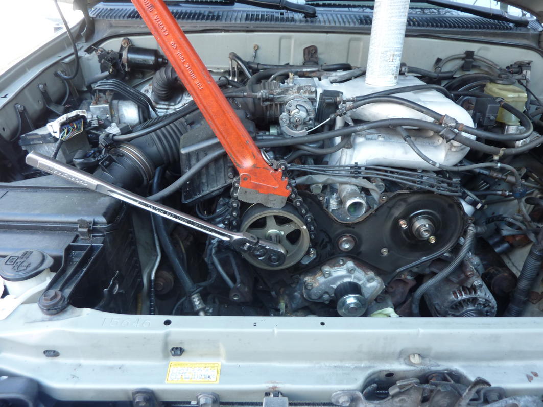

The belt doesn't have enough tension to hold the pulleys in place. I used the a piece of the old belt to protect the teeth of the sprocket from my large chain wrench, not as a strap wrench itself. I actually took a picture of it. I used it on the harmonic balancer too.

I used the chain wrench because I had one I use for work (I work with large pipe sometimes) That size (24") costs around $100. There might be some cheaper ones. It definitely works. There are tools especially made for harmonic balancer removal but some of the guys on here have had limited success with that tool (bent bolts, the tool itself bending)
Sorry no pics of the harmonic balancer removal, but I just put the chain wrench on the harmonic balancer just like the pic and used my HD impact gun (250 lbs torque) removed the radiator for easy access. You could just use a breaker bar and wedge the harmonic balancer removal tool or chain wrench against the frame in the engine compartment. Check out some of the write ups. Some people even bump the motor starter with a breaker bar on the crankshaft bolt wedged against the frame. I didn't have to resort to that.
