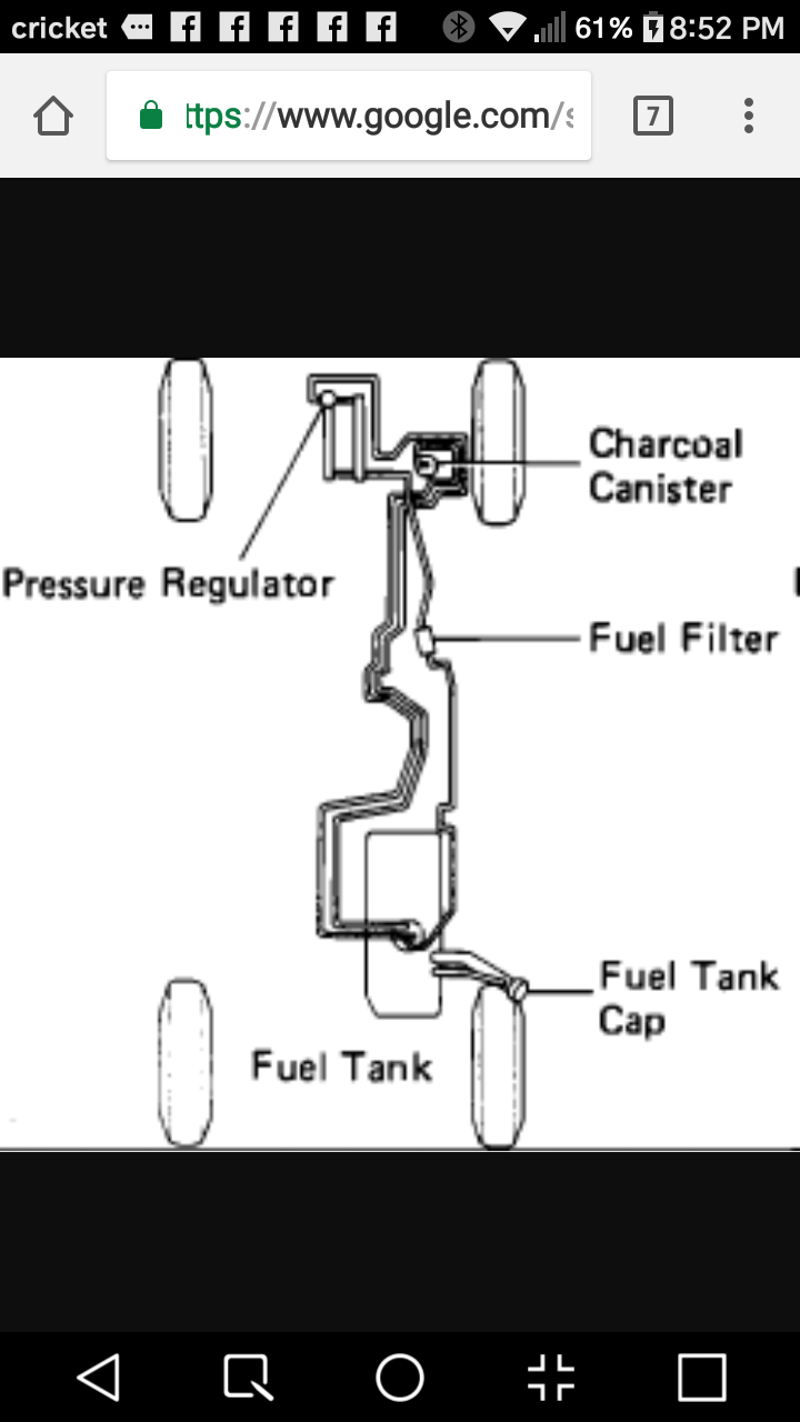

Well after going through the egr and every plug and wire i thought it may be an injector....the injector closest to where fuel comes to the Schrader valve was unplugged!!! I must've knocked it loose while letting pressure out of the line to replace my fuel filter. I'd be a genius if i were a monkey! Lol
Did that fix your issues? The vavle isn't it under the upper intake? On the passenger side? I wounder if that if that is my problem
YEAH ITS RUNNING GOOD AGAIN!!! :D The valve is located near the FPR(fuel pressure regulator) on drivers side. 17mm i believe..heres a pic to help show its near the visible fuel rail toward the front of the engine.
